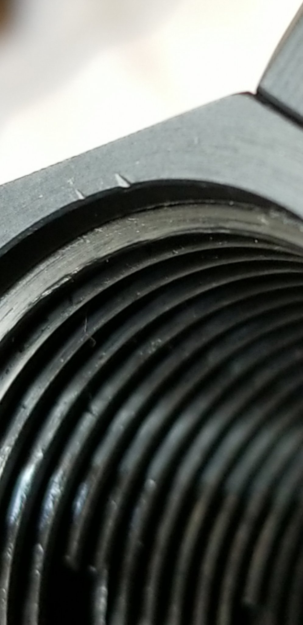

I noticed the action face on my new AI has a some small dings where the barrel is shouldered.
Do you all think this is something to be concerned about or am I way too picky? If I run a razor blade across the face it doesn't catch at all.
No, it shouldn't be a problem, I would maybe run a flat stone to remove any high spots but not a very aggressive stone and not more than a couple of strokes. If the stone shows any high spots just keep stroking a bit. Those tiny things are not gonna raise much material and typical barrel torque should kinda wipe it right off.
