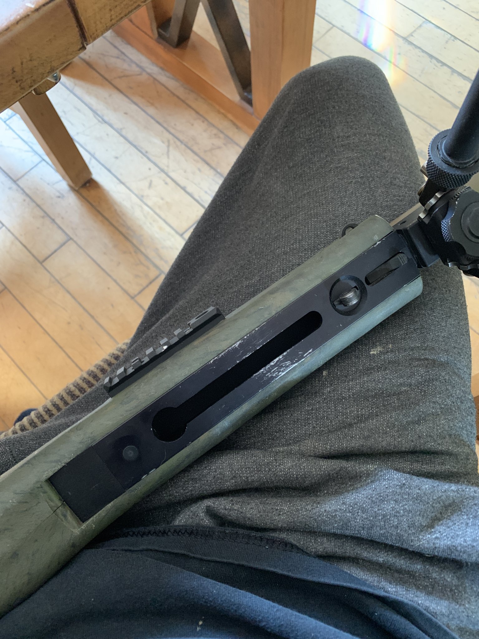

Hello everyone, first post here. Just picked up an AI AT chassis 6.5 creed build. Would like to have an ARCA Swiss Rail added for adaptability. Searched sites nothing stands out. Really don’t like the wiggle the bipod has. Atlas bipod with the AI spigot mount. Any help advice appreciated. Thanks.

I assume you are talking about the rotation on the spigot where the flats between the spigot and chassis have a little clearance. If so use skateboard grip tape on the vertical surfaces of the spigot and the chassis where they mate. It will help it lock up tight.

It looks like an older chassis as mentioned ... but toss that spigot thing as far as you can. HRD on this one.. way way bitter than the spigot
What is the plate over the tripod? I’ve got a legacy and can’t find a plate that doesn’t use the AT key slots. Or is that an AT?
All I have seen from hrd is the rail. Is there a plate that contours the bevel in front of the mag? I thought @Diver160651 was saying his was a legacy not an AT. Not sure though.

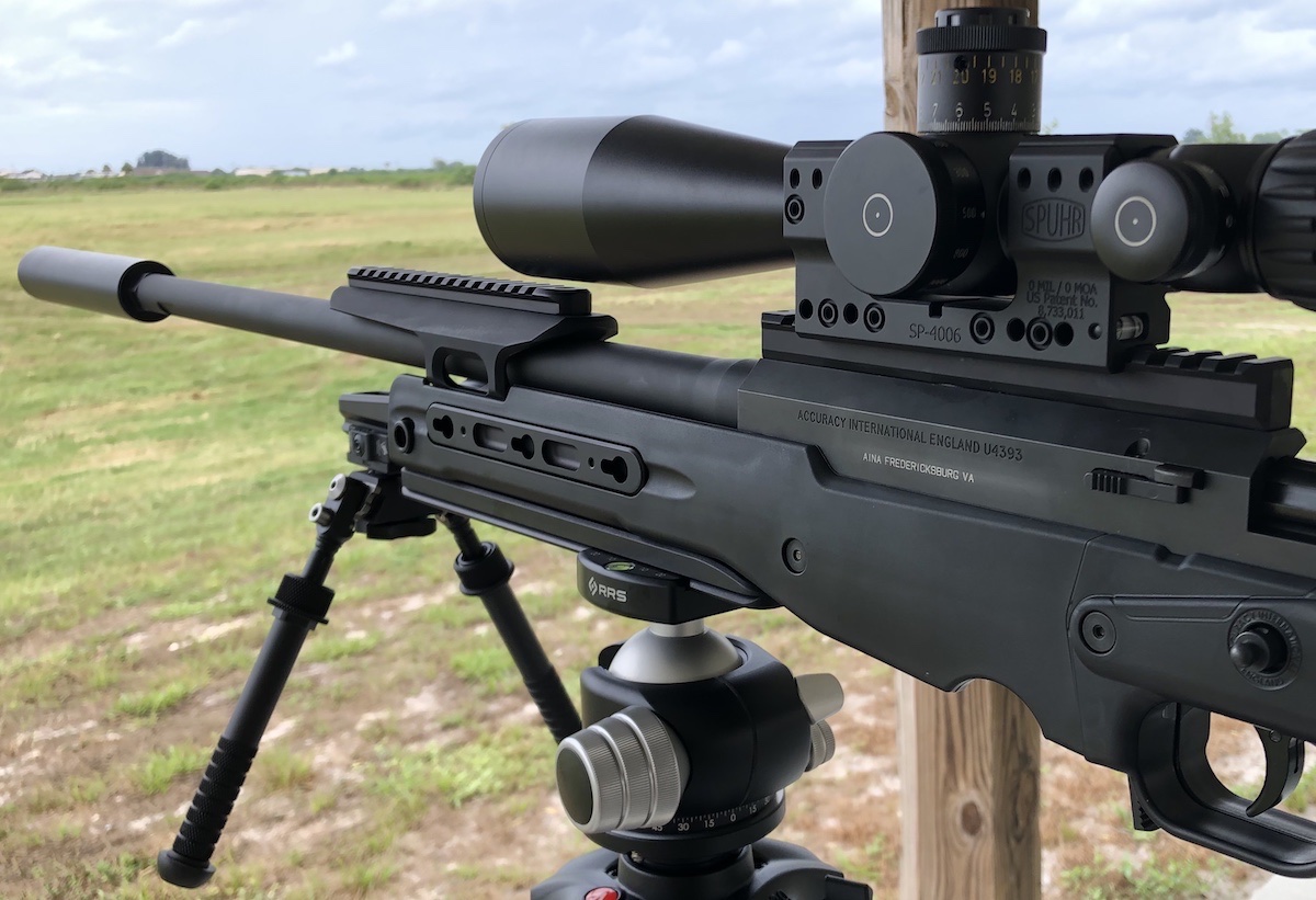

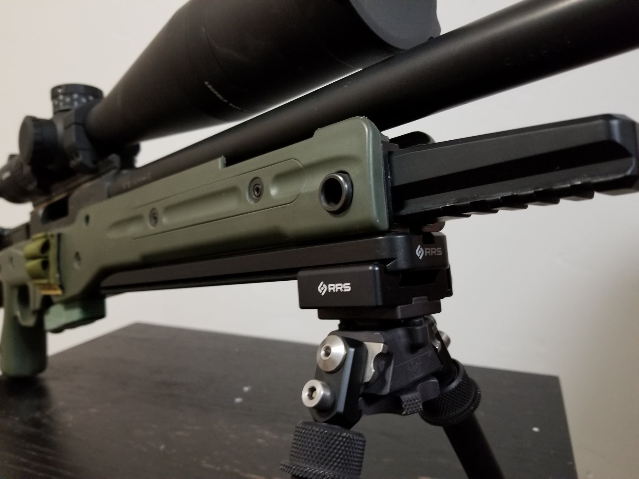

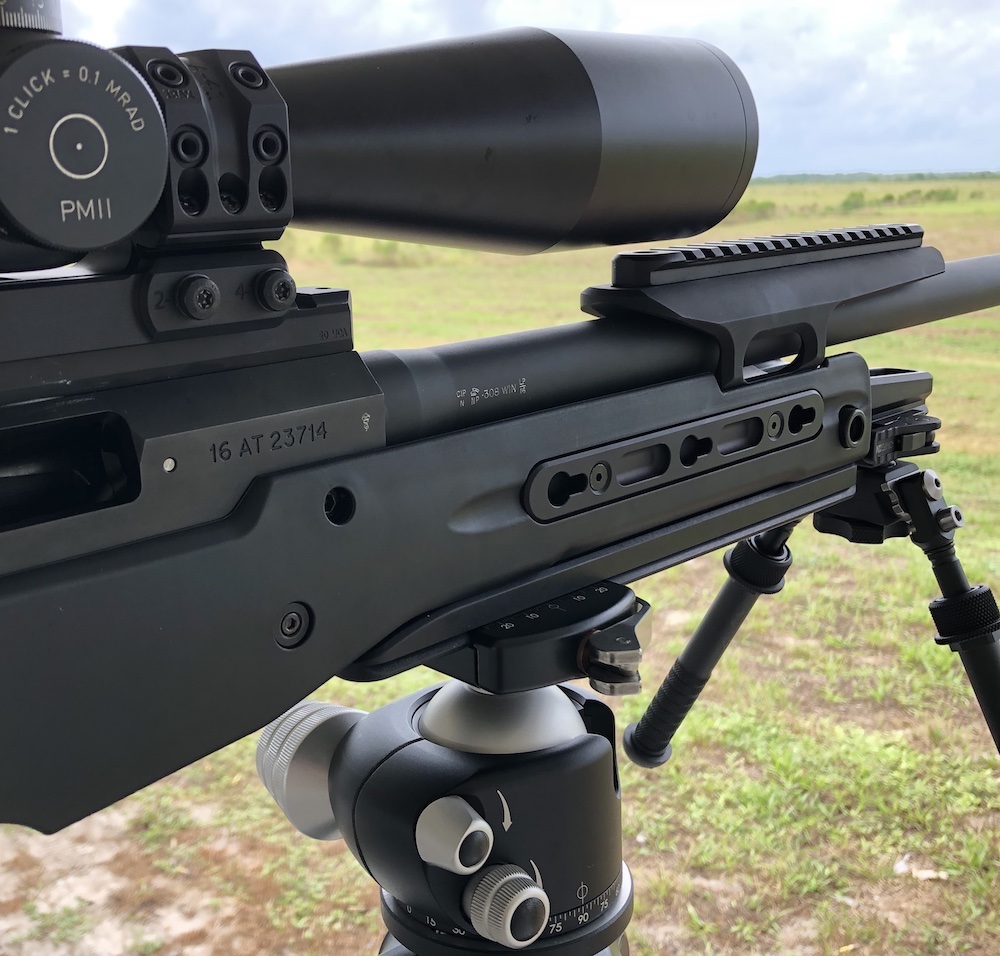

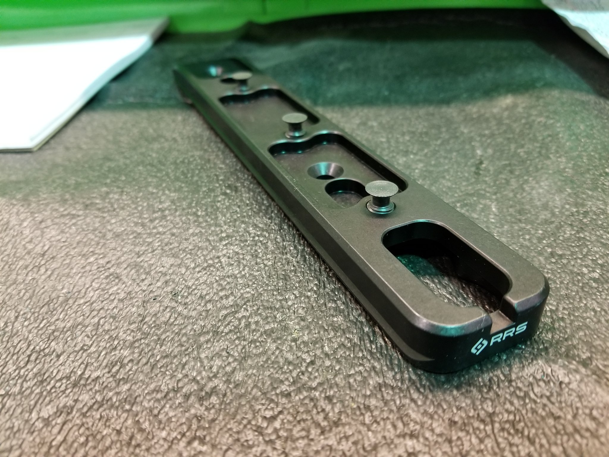

View attachment 7177308View attachment 7177309View attachment 7177311
Why are you showing pics of a RRS rail with a link to an HRD rail?
