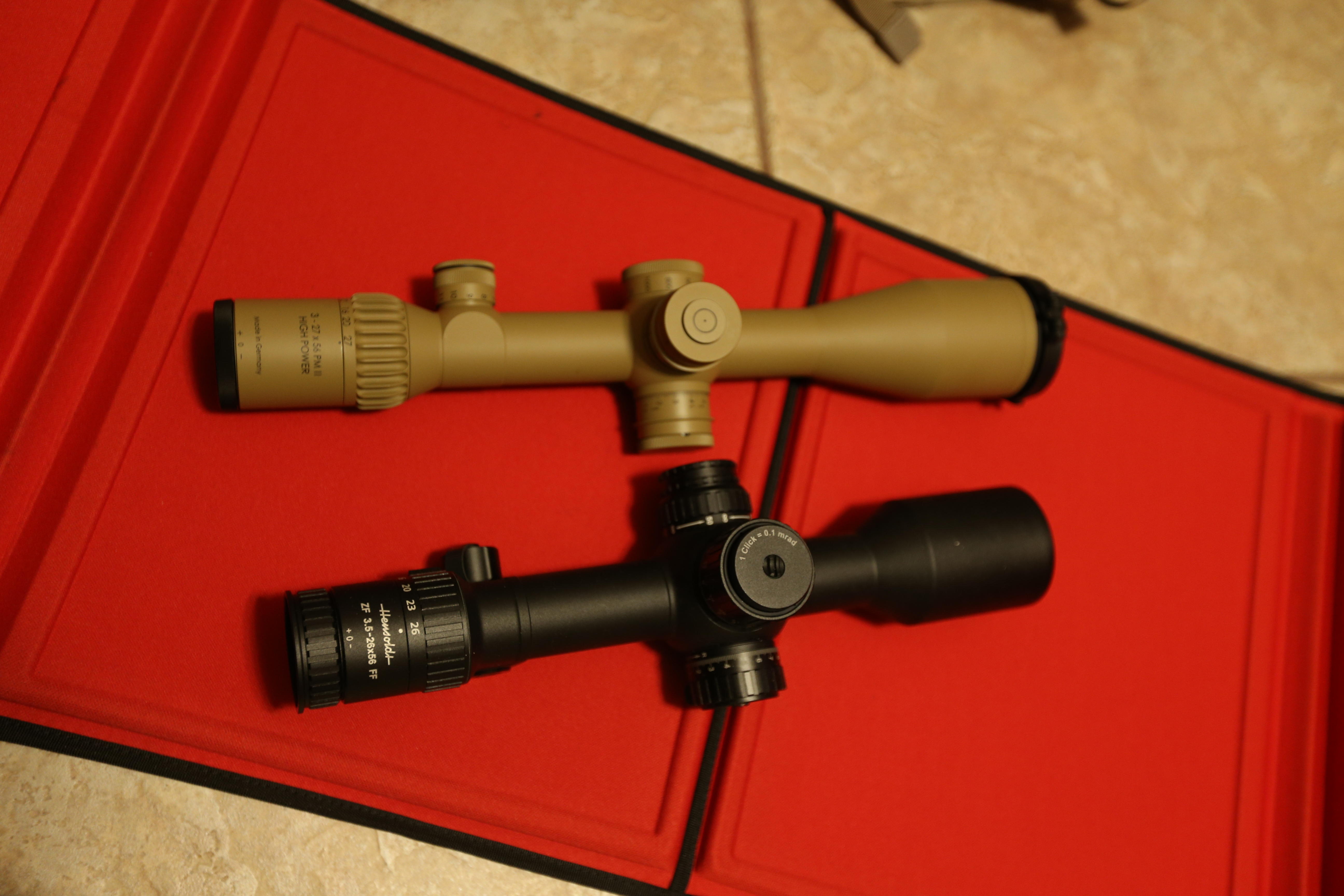

Spuhr makes a mount for the Hensoldt. I picked up my 3.5-26 from Jason at Euro Optics, Great guys to deal with and they're the only ones who have that glass in stock, the price is way up there but you will not regret it!!!
Laying next to a SB 3-27......... They should make a baby lol
