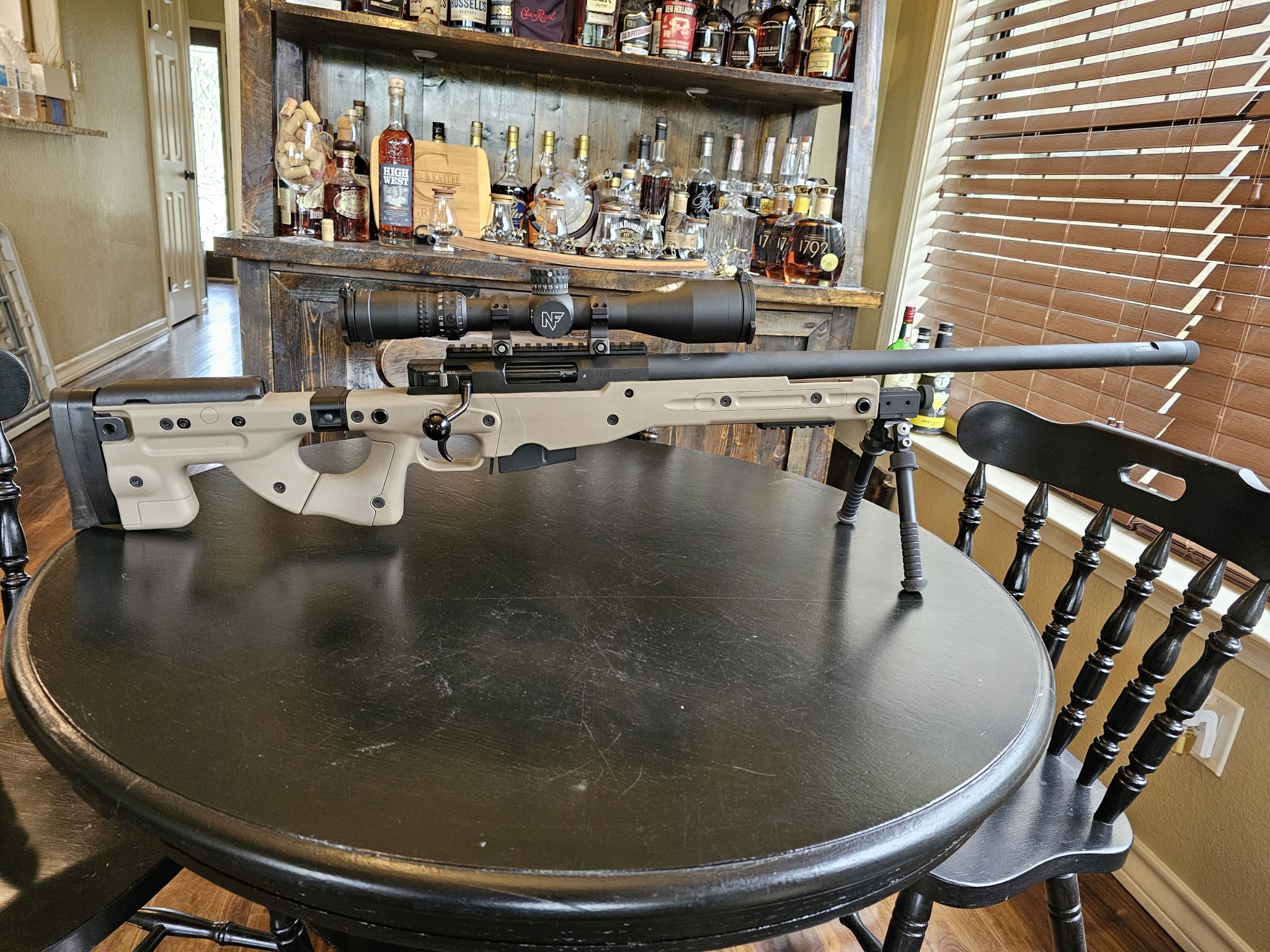

Based on the TP video I'd say fundamentals and rifle/bipod/bag setup would be the first things to examine. You may want to consider higher rings and a higher setting on the bipod so you can get more rear bag under the buttstock. Not saying that's definitely the issue just something to look at.

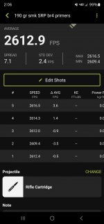

An SD of 3 will not equal an ES of 8, so I’m assuming you are using pretty small samples. I’d shoot 7-10 rounds on paper at 100 yards then do the same at distance while chrono’ing all rounds.
Here's my last from just fouling the barrel before a match. I said 3 and 8 because it was the average out of my last 15 shot group
Yeah, never been a fan of not having something to apply pressure against with the bipod. And the way it was set up, there was somewhat level ground. Haha. Wasn't ideal. But at regular matches we shoot off of a deck that has a 2x4 we can apply pressure with the bipod.
We all know the wall is at 800yds for the 308win. So shooting past that is impossible.
But for under 800yds. Looks like your stability should be ok. Your barrel looks like it is marked 1/10 not 1/12. And based on your ballistics you should be Trans sonic just past 1000yds. So should effect anything sub 800yds.
