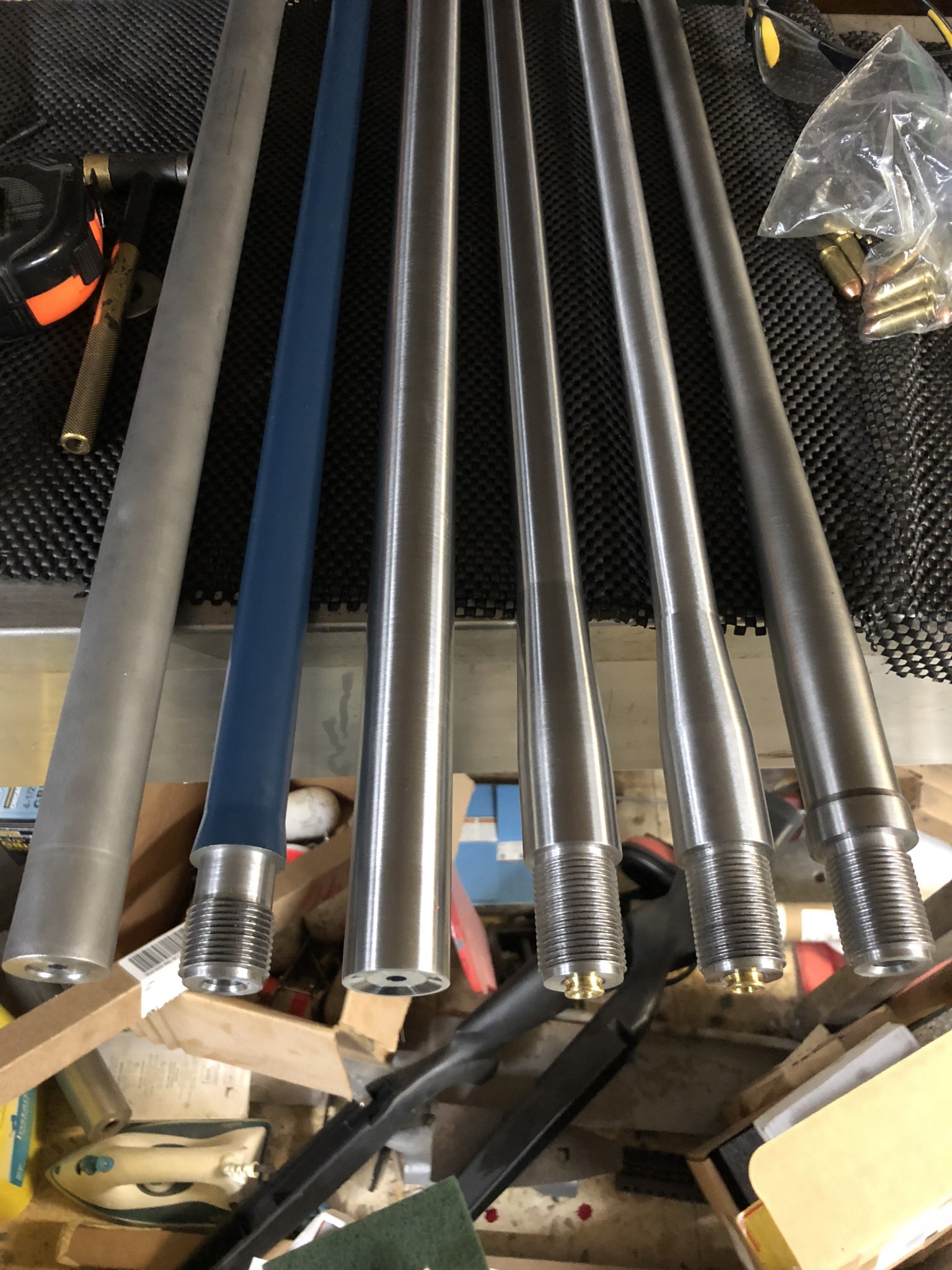

I have 8 Dave Tooley made barrels and they never needed to be pre fit all head spaced perfect when check with go-no gauges. I have barrels for both long and short action AI's so I can recommend Dave's work for any AI action.
