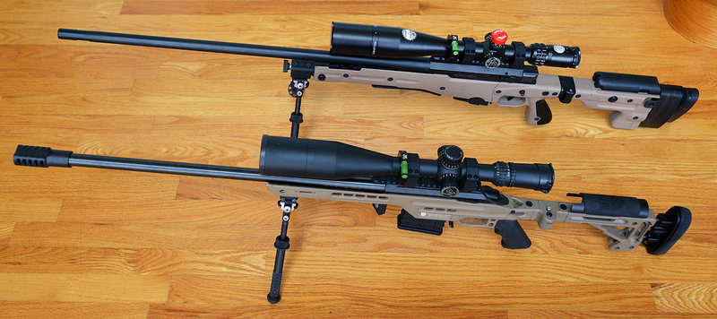

It wouldn't be a cheap project, but when you consider the price of a second high end optic, chassis and new barrel for my Tikka, a few days custom work by a gunsmith to modify a few mags and a new bolt would be money well spent.
You'd have to come up with magazines to work with the smaller .223 case as well.
AI mags are pretty expensive to be experimenting on IMHO
A little higher cost in barrel life and component cost is also much cheaper than setting up a second rifle which has completely different ergonomics from your AI. 308 gives just as good barrel life as 223 and all things considered 6.5x47 isn't bad. It would take a lot of shooting to justify a complete rifle vs a little higher component cost. You also mentioned that one of your reasons to do a 223 is to consolidate, yet you'd be adding a third option to this rifle that currently has two and that's the opposite of consolidating.

I went through this whole thing for the last 6 months, waited a whole bunch of time for the AICS chassis for Tikka vaporware and finally gave up on the whole idea.
Ended up with the Tikka .223 Varmint in a MPA BA Lite chassis folder and could not be happier. This setup is like 3 plus pound lighter, better ergonomics in terms of LOP adjustment than an AT AICS, and the MDT polymer mags that cost round $30 feeds properly. Oh yea, the Tikka barrel shoots as good as my Bartlein barrels in my AT and the whole package only cost around $1,600... - Blasphemy I know but true.
