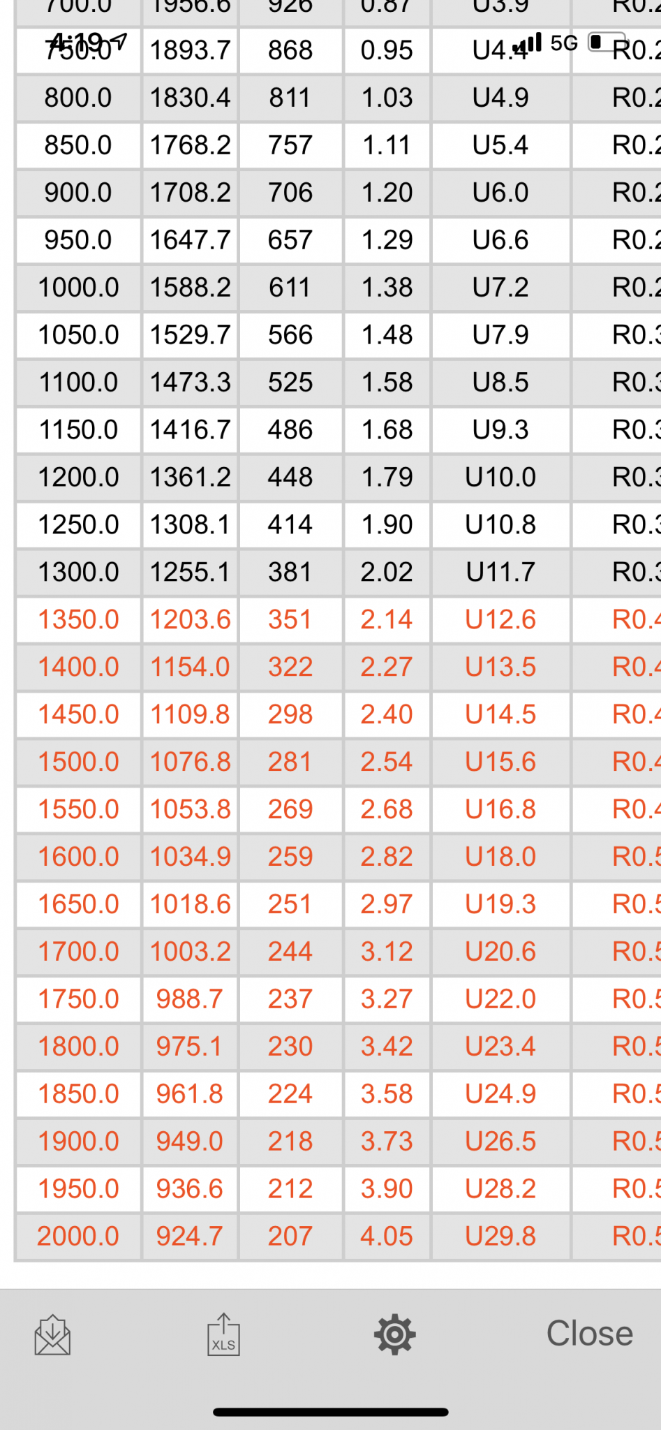

I have reloaded pistol for years…I have just recently purchased everything I need to reload for my 6.5… I have been using Hornady 140 & 147 eldms since my class with lowlight last year.

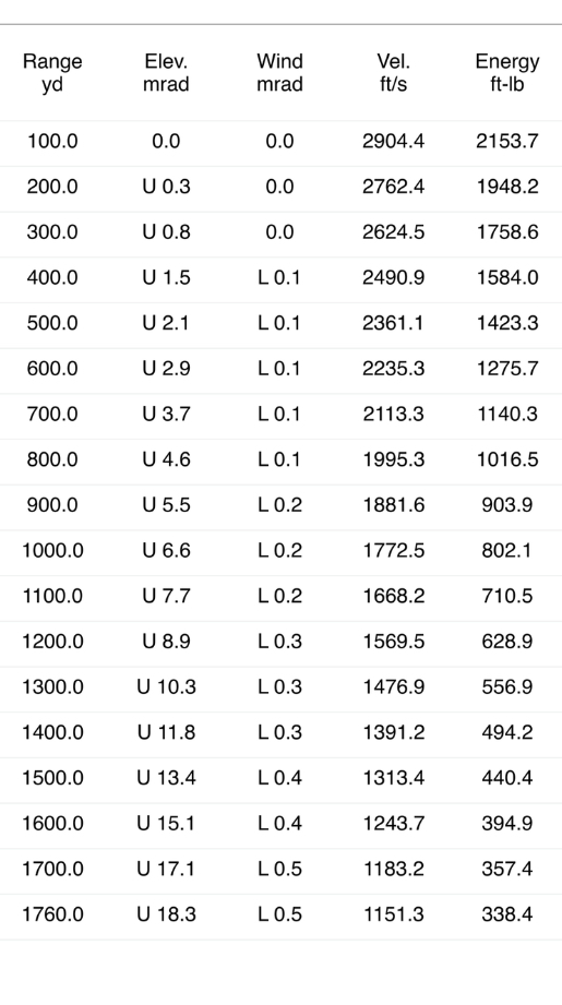

243Ackley
115 DTAC
Here is my chart, yes I’ve taken it to 1760 in AZ
