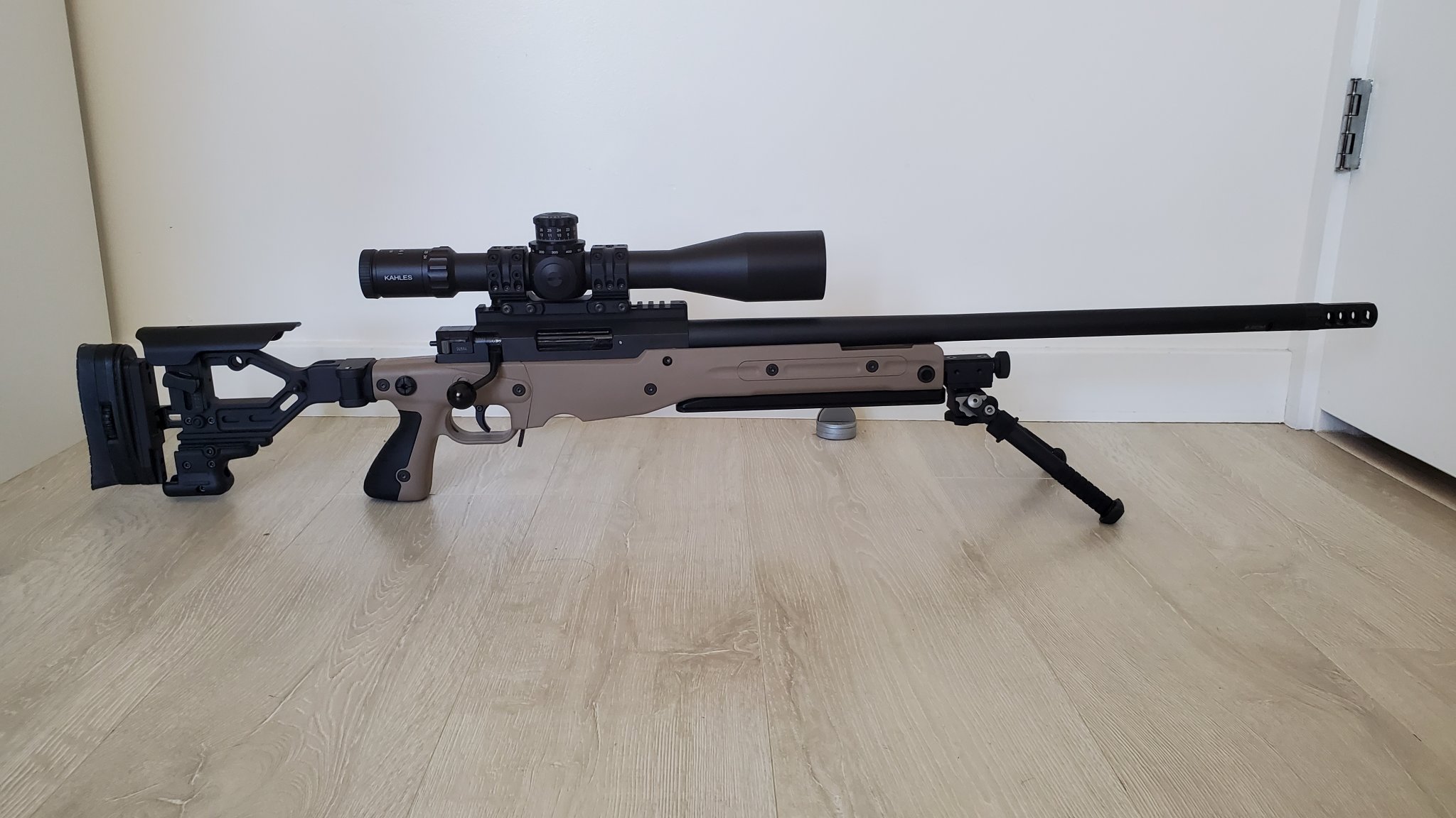

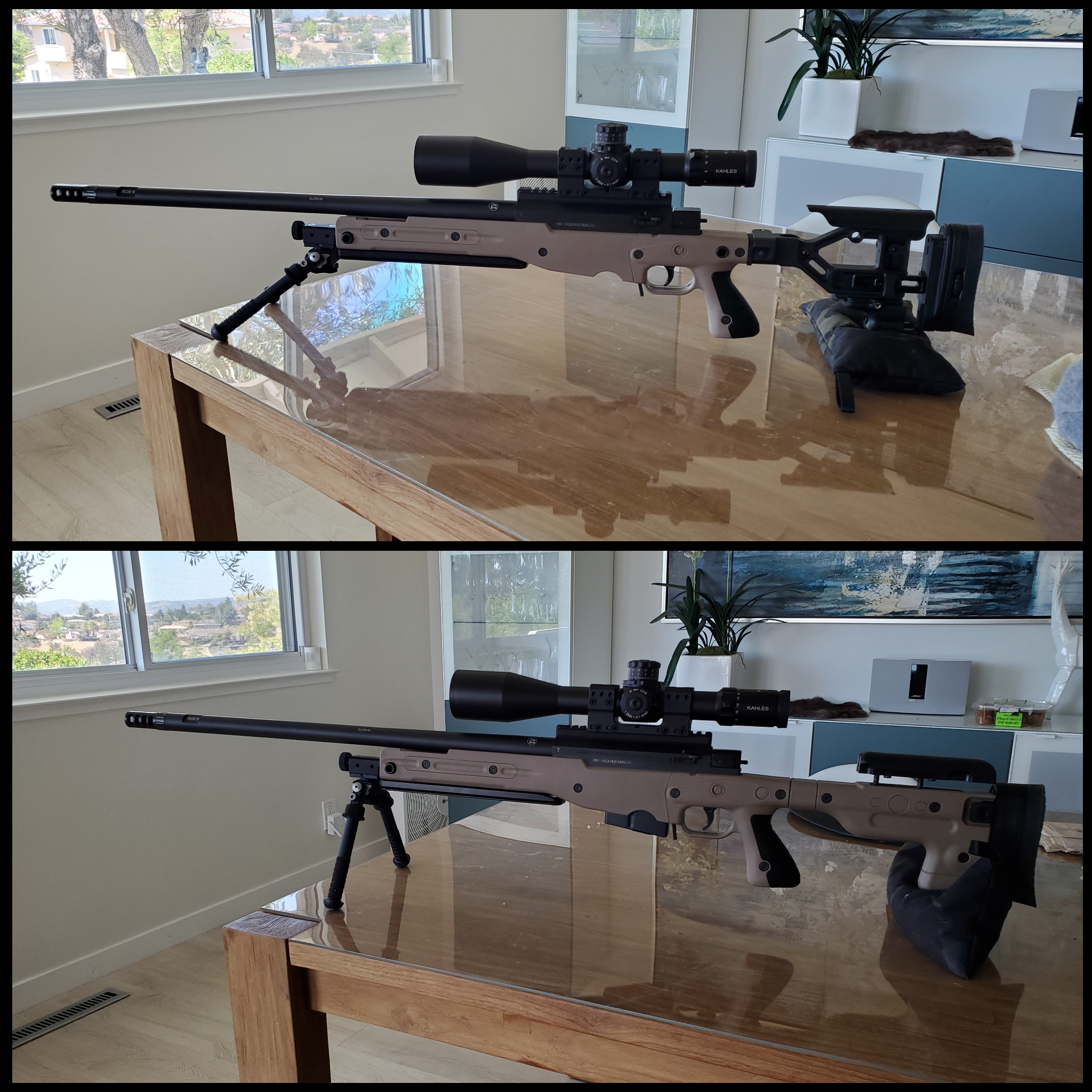

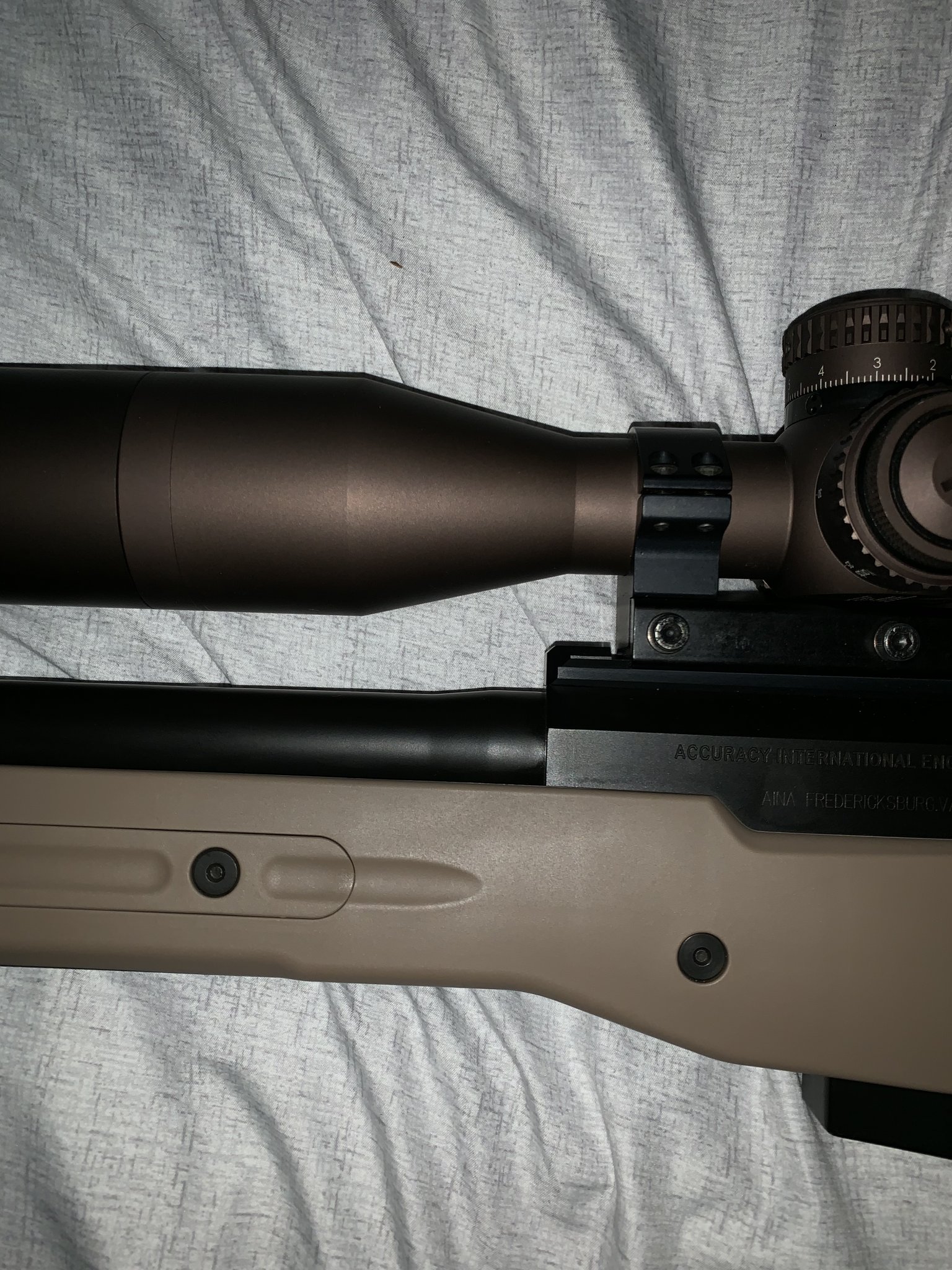

From what I can tell from pictures I’ve seen it will be close, but it should work.
My current set up for reference

I have the High Action Rail with 1.18in high Spuhr SP-4001 in my 34mm Kahles K624i
I tried with Low rail and 1.18...but i had to tilt my head too far forward that I felt my eye were looking up through my forehead just to get ok-ish line of sight. Not ideal for me.
Option 1: Low Rail and Spuhr SP-4006 1.35inch
Option 2: High Rail and Spuhr SP-4001 1.18inch

I have a solution for the too-tall AX cheekpiece that I have been waiting on for probably a year to see if anyone got around to doing this swap. I don’t know exactly when I’ll get them made but if people are popping up on SH that want them I’ll pursue it sooner than later.
Would this be what you're referring to?

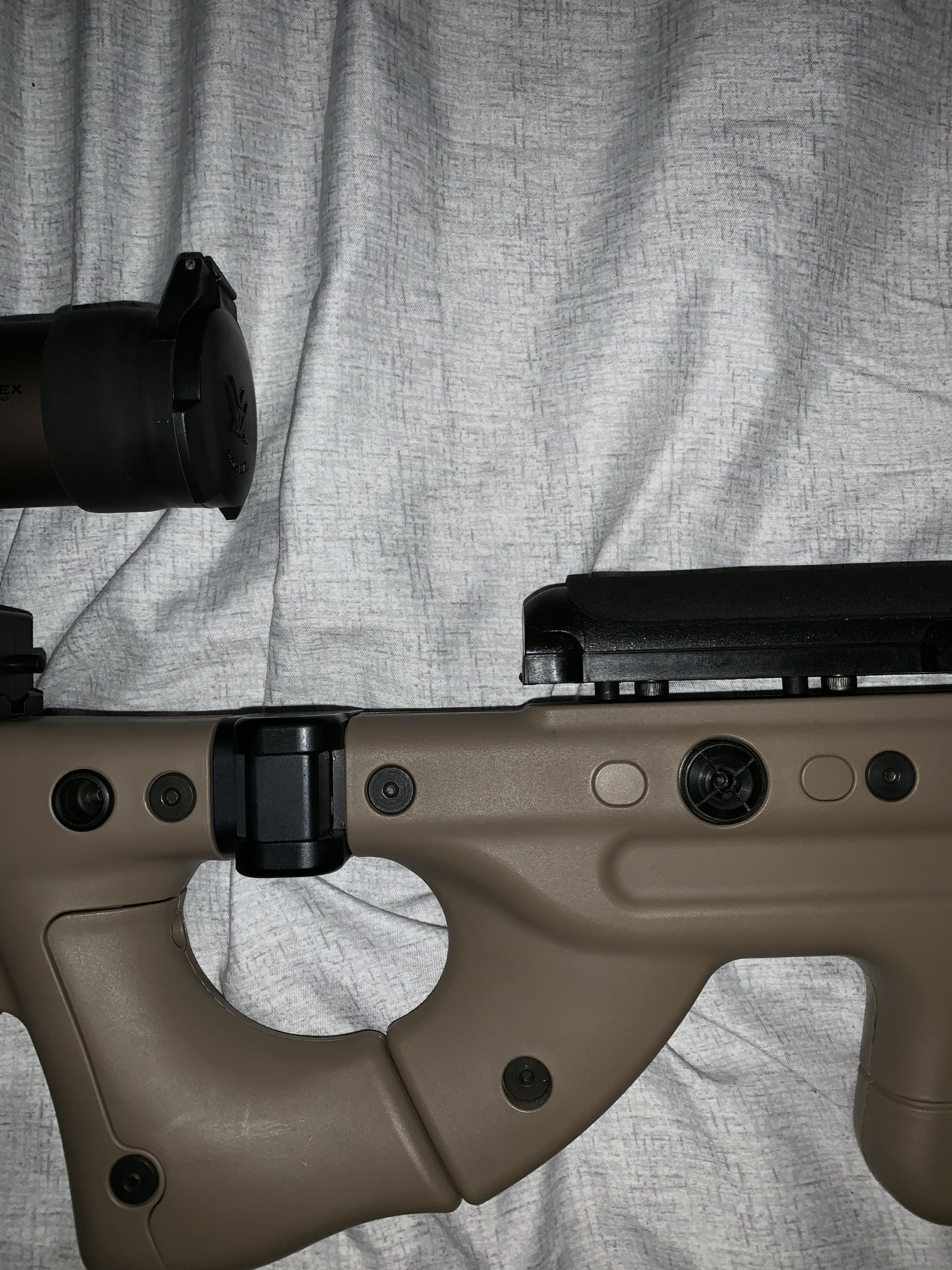

As for the AT to AX butt conversion, I had the AI low rail on my AT, and had to install the stock/high rail to get the cheek weld to work after the conversion. Rings are ARC mediums (I think).

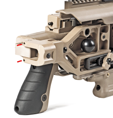

The tension can definitely vary from hinge to hinge. The only way I know to even try to tighten it is the two set screws on the hinge, you'll see them here:
If that doesn't work, I don't think there's much that can be done.

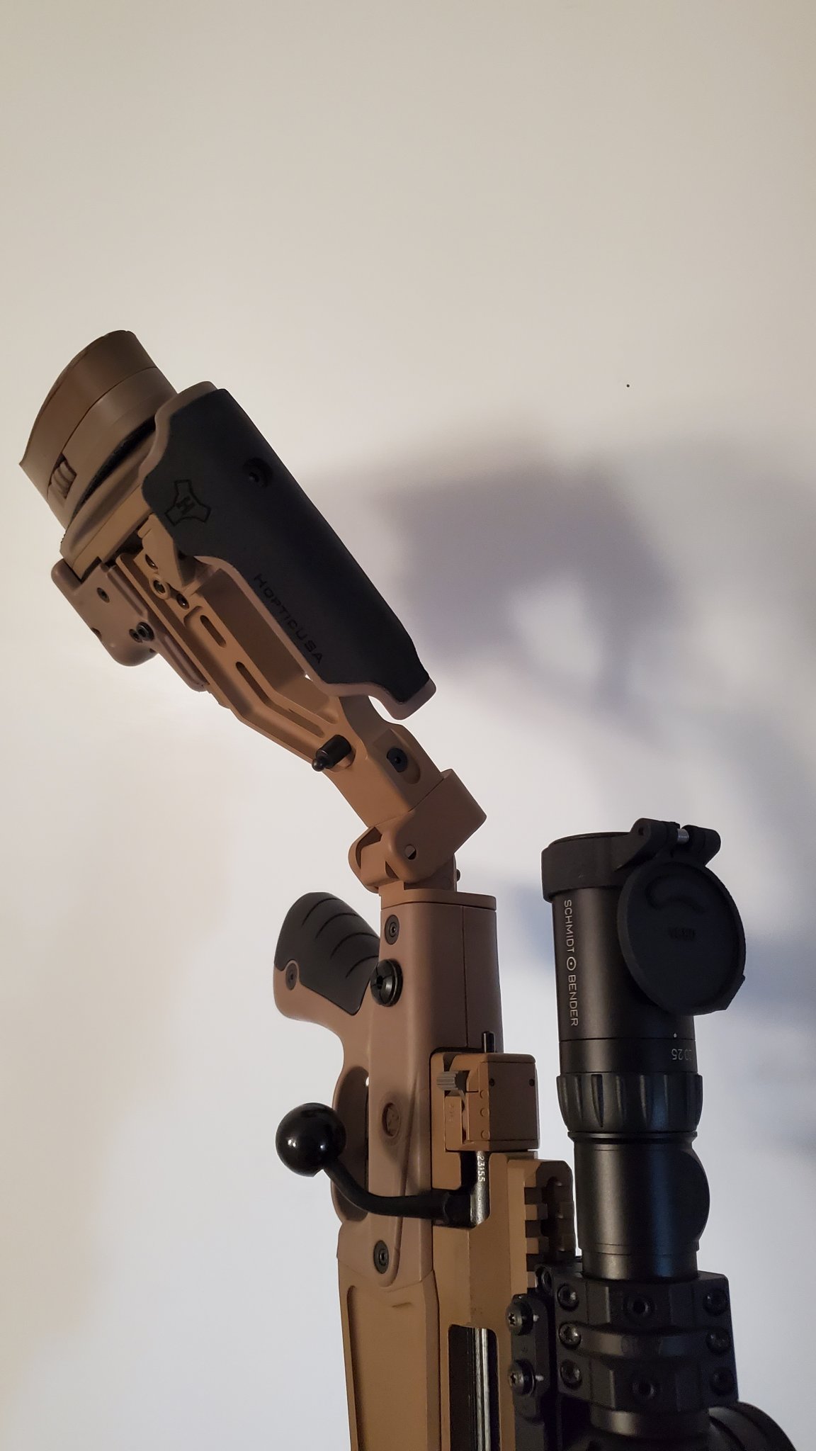

So on the original AT stock and my AX complete rifle you could hold the rifle vertically, muzzle down, and move the stock to a 45 degree position and it would hold there due to the tension that the hinge has. On the AX conversion I just installed it will just fall closed under its own weight once unlocked. This is not an issue if I had the ball catch installed, but I have to remove that catch if I want to run the AO thumb shelf. Not a huge deal but I wonder about it snagging in my pack or even just in the safe as I like to store the rifle in the collapsed configuration. If I can’t find a way to increase the tension then I may have to forgo the thumb shelf and put back the catch.
Request a resolution if it cannot do this

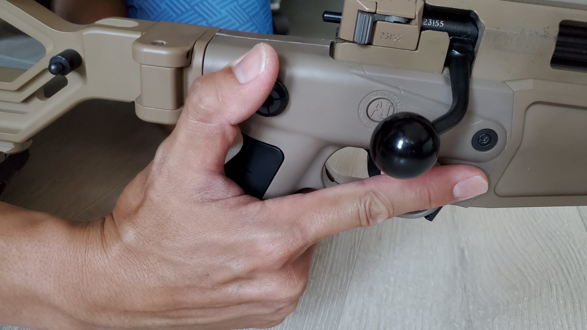

Worst case scenario, you can do what I do and you the side folder latch as your thumb rest 🤷🏽‍♂️
