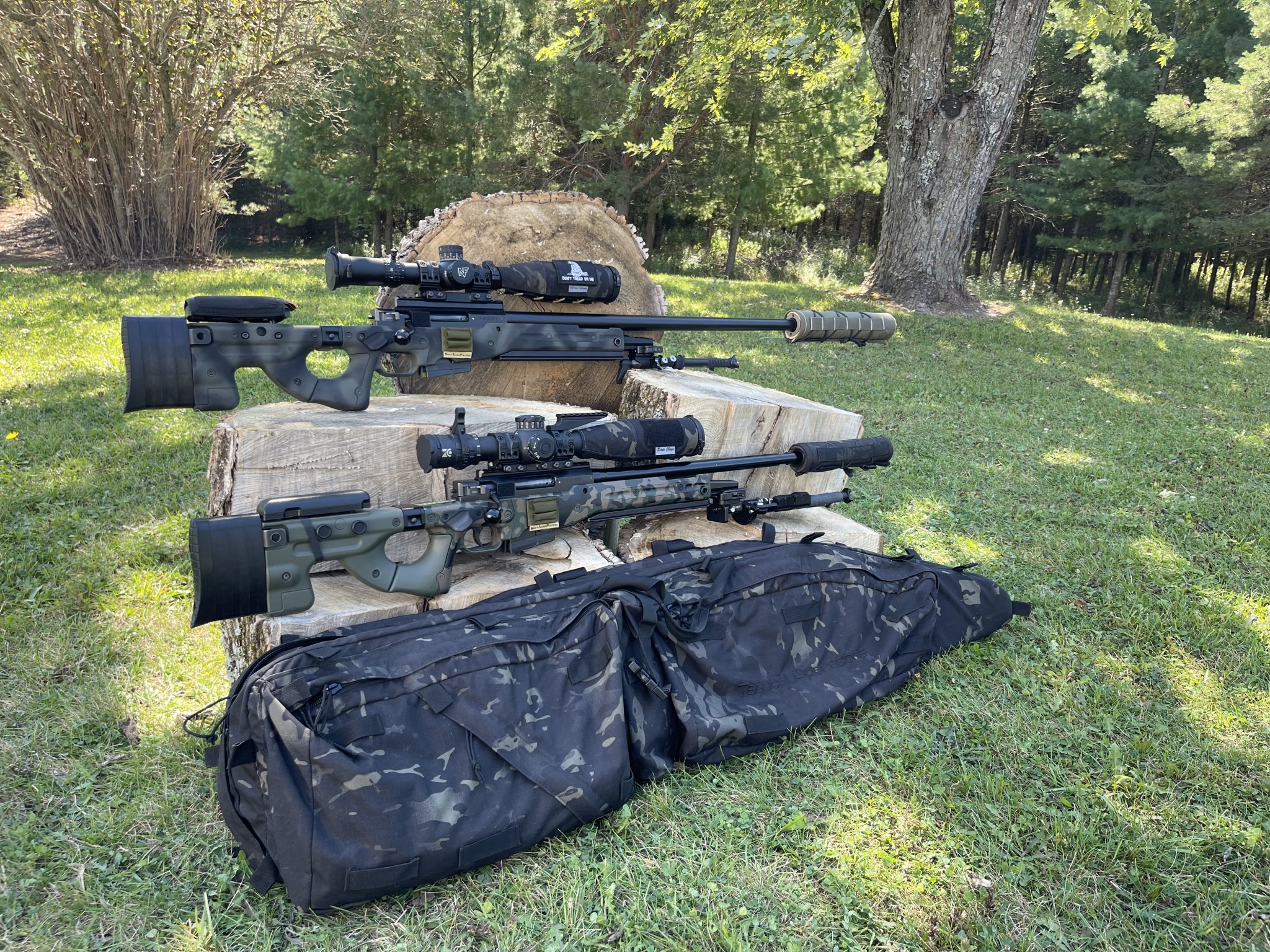

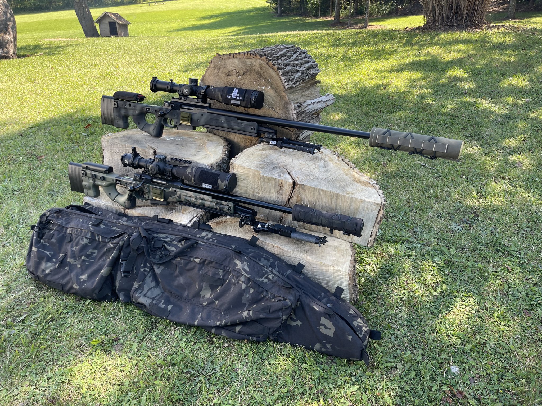

Bottom is my $3000 AT. 20” 308 LW barrel. She’s a hammer. This is a setup for crop damage and spends most of the year covering farm fields for damage control
Top is a 260 Rem. Custom barrel from Manzella. Soon to have a bolt mod and custom 300 WSM barrel from Fritz. This is more set up for switching barrels between target and long range hunting. Or at least that’s the plan. This gun was purchased for more than the first AT and had no barrel. I considered it a deal when comparing it to current prices
It doesn’t take long for accessories to add up when looking at these used. Mine are both folders and vs a factory AT have
Arca rail (RRS on bottom and Sawtooth on top)
Spigots
Thumbholes
I bought a NV rail and side rails for the top one which aren’t shown in this pic. But let’s say that ones approaching $800 just in accessories
If you’re shopping used the AT or AX market is where I’d be looking currently depending on what you want and want to spend. Probably $4000 vs $5500 in current market pricing

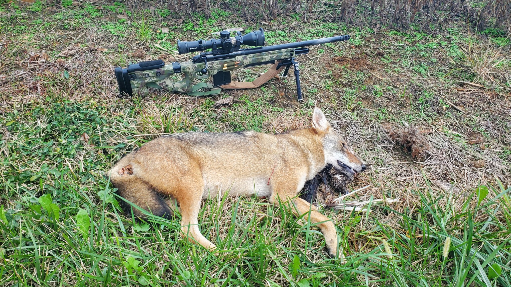

Yeah, AE, for its smoother bolt and better trigger, lol. I started with a mk3, then picked up an at, then got a deal on a pre14 ax. The at had the worst bolt lift and feel of the 3, bolt was just pretty meh. The ae was like butter and the trigger was light years better than the at(why they came out with the comp trigger for at's). I dumped the at, the qc barrel is neat, but alot of the guys that clamor for it won't use the feature until it's time to replace barrel. I can swap barrels on an ae in 15 min, so it's not a big deal. Got tired of the ax and it's weight for a short action .478" size case and unloaded it. Then I stumbled into a mk2 fixed for 1600, sold the 308 barrel for 450 and stuck on a 6creed barrel I had laying around. Someone on here upgraded their at butt to an ax and I bought their folder at butt for 225. Grafted it to ae mk2 and I've got a 1425 ae mk2 folder(not counting the 6creed barrel I had).
Edit for pic i forgot....
