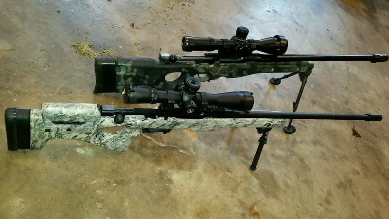

I have a .264 Win Mag built on a Badger 2013 from SAC. 28" 8 twist Bartlein. Though I also have an AI AWSM in .300, It will likely never get a .264 barrel. I love the .264 Win Mag and would never steer anyone away from it unless the intent was a long barrel life after long and/or fast strings on a regular basis. This is my 4th .264WM, and my advice is this - Do it, and run it hot, but not hard. Given the case capacity, reduced loads are super inconsistent, and in running low velocity loads you'd be much better served with a short action 6.5. Also, the data I have found in most manuals is kinda crappy, as it is a somewhat forgotten caliber. My load is Nosler/Norma brass, Fed 215M, 142gr SMK, and 80.0gr US869. This gives me 3,370fps and under just 3/4" 5-shot strings for a very flat, forgiving trajectory with amazing ES/SD. My rule of thumb for the .264 is that 200pcs Norma brass once worn out = the barrel life. It's been pretty spot-on so far. 6-7 loads and they are gone, so 1,200 - 1,400 rds and there is nothing left. I had one go south at 830rds before, but that is before I thought outside the box and got away from 4831 or 4350. I have read/heard many people proclaiming US869 to be "WAYYYYY TOOOOO Slow" for the .264, just because it is a .50BMG powder and they had no tried it. Kinda glad I did.

I'll see if I can send him over here to answer some of your questions.
"Nasty Nate" has referred me to answer a couple questions.
I have just under 400 rounds thru my 264WM TRG42 and the thing is still shooting fantastic. I used a standard reamer and a Bartlein 1-8.7 twist.
I've cleaned after every round for the first 20, and haven't cleaned since. I will be cleaning it before the next match though.
I went with a 21" barrel so that with a 9" suppressor I kept a pretty short overall length. I thought with that length barrel that I would have to use 123gr ELD's or SMK's to get up towards 3200fps. Which, that was true using H1000. I used Quickload before loading and found velocity to be pretty accurate.
There is no such thing as a free lunch in shooting though, I found H1000 to be very hot, my barrel and suppressor would get very hot to the touch, and the suppressor would be upwards of 350 F.
So, using Quickload, I sought out a lower pressure powder, assuming lower pressures would mean lower temperatures. I looked at dozens of powders, but found that Retumbo was the only one giving me good velocities and low pressures in my short barrel. Retumbo has allowed me to go lower with pressures, lower with heat, AND I'm able to step up to 140's. It should be noted that I did try to get greedy and use the 147's, but found those to give me high pressures (sticky bolt lift).
Here's my developed load:
Hornady brass
71.0gr of Retumbo CCI Large Rifle Magnum
Hornady 140gr ELD
COAL: 3.250"
Result: 3115fps, SD-4
I found that load development was pretty easy for the 264, but this was also my first time using Quickload too.
I've run this gun for all my matches this year and love it. It has a bit more recoil than my 6.5 Creedmoor, but less than a 308. I'm hoping to get around 1200+ rounds thru it, if I can keep the temperature under control. I have a Barrelcool fan to help with that between stages (works fantastic). The TRG is a great package to run this in, however TRG mags are ridiculous priced, and they only hold 7 at a time (Sako kept them flush with the bottom of the rifle). I've also found the belted mag to be finicky feeding, the belt catches on all sorts of shit in the mag. It takes a special touch to load one, but that's easy to overcome.
I hope this helps answer any questions you may have.
-Ken
I am currently breaking in a 264WM barrel in my AXMC. It feeds great and with 67 grains of H1000 behind 140 hybrids I'm getting 3100 fps with a 26" barrel. This load is on the milder side. I'll update this thread later when I get more rounds down range.
