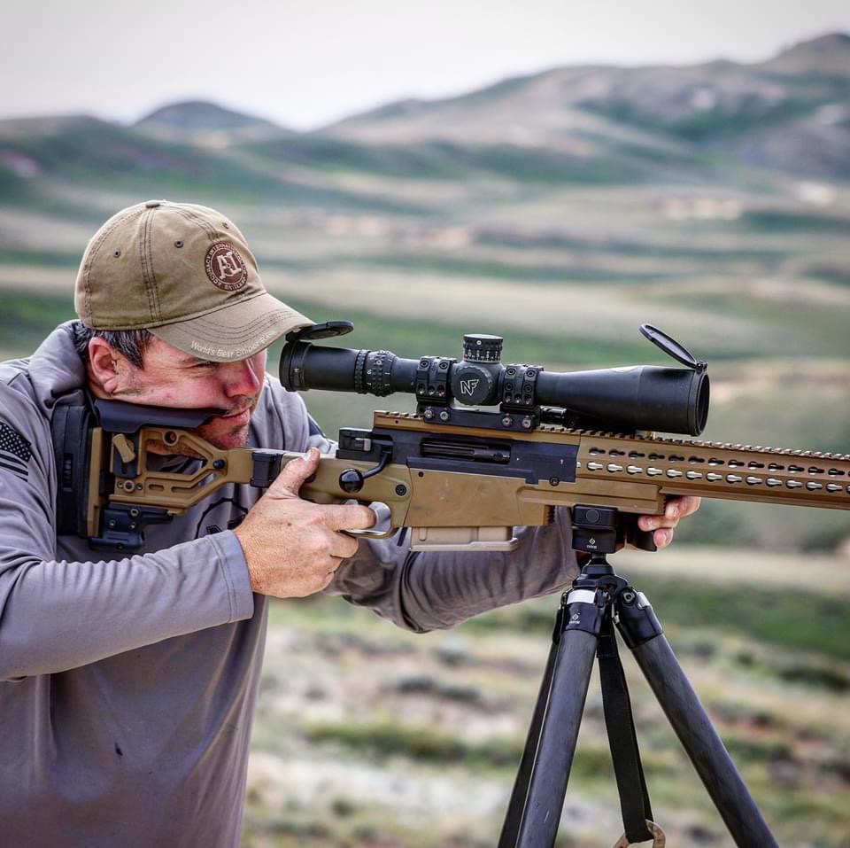

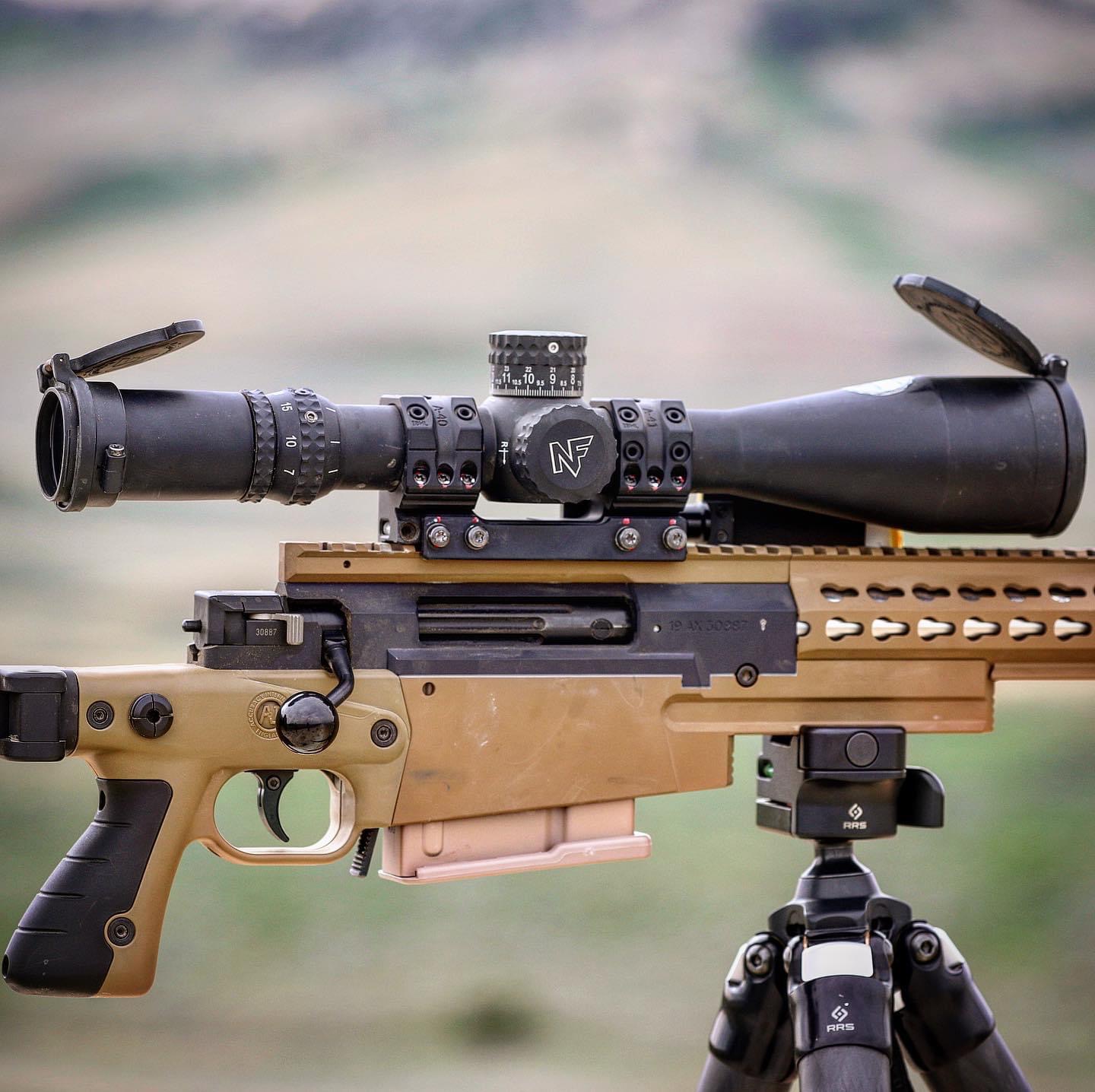

If I had to choose at this time, I’d go for the AXMC LE. I’m guessing it’s the AXMC with some of the AXSR furniture, the front mag attachment and handguard. I personally really like the AX buttstock, more over the AXSR version.
still wondering if this furniture will fit my short action AX and if the parts are available
Looks nice! I think the LE was something Milehigh put together. You can't get these here in Europe
