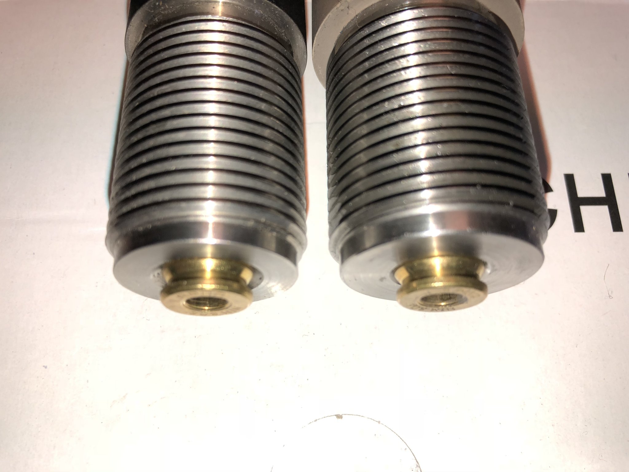

Black barrel on left is AIAW
Tan is the AXMC barrel
Both are in 260 rem
Brass is FLS for both
Can you tell the difference?
Eyeballing the pic is tough and adding to it the chamfered edge inside the chamberon the left hand barrel makes it deceiving. If you have calipers, use the depth end and measure the distance from the breech face to the top of the case head and they should be the same. We are talking .07" difference if they are close then they are both chambered for 260 and your problem lies somewhere else. Next I would suspect that the chamber may be cut correctly but the tenon thread length was cut incorrectly possibly.
Ok, so I measured both barrels with the same piece of brass from the breech face to the top of the case head
AIAW : 0.137"
AXMC : 0.148"
What do you guys think?

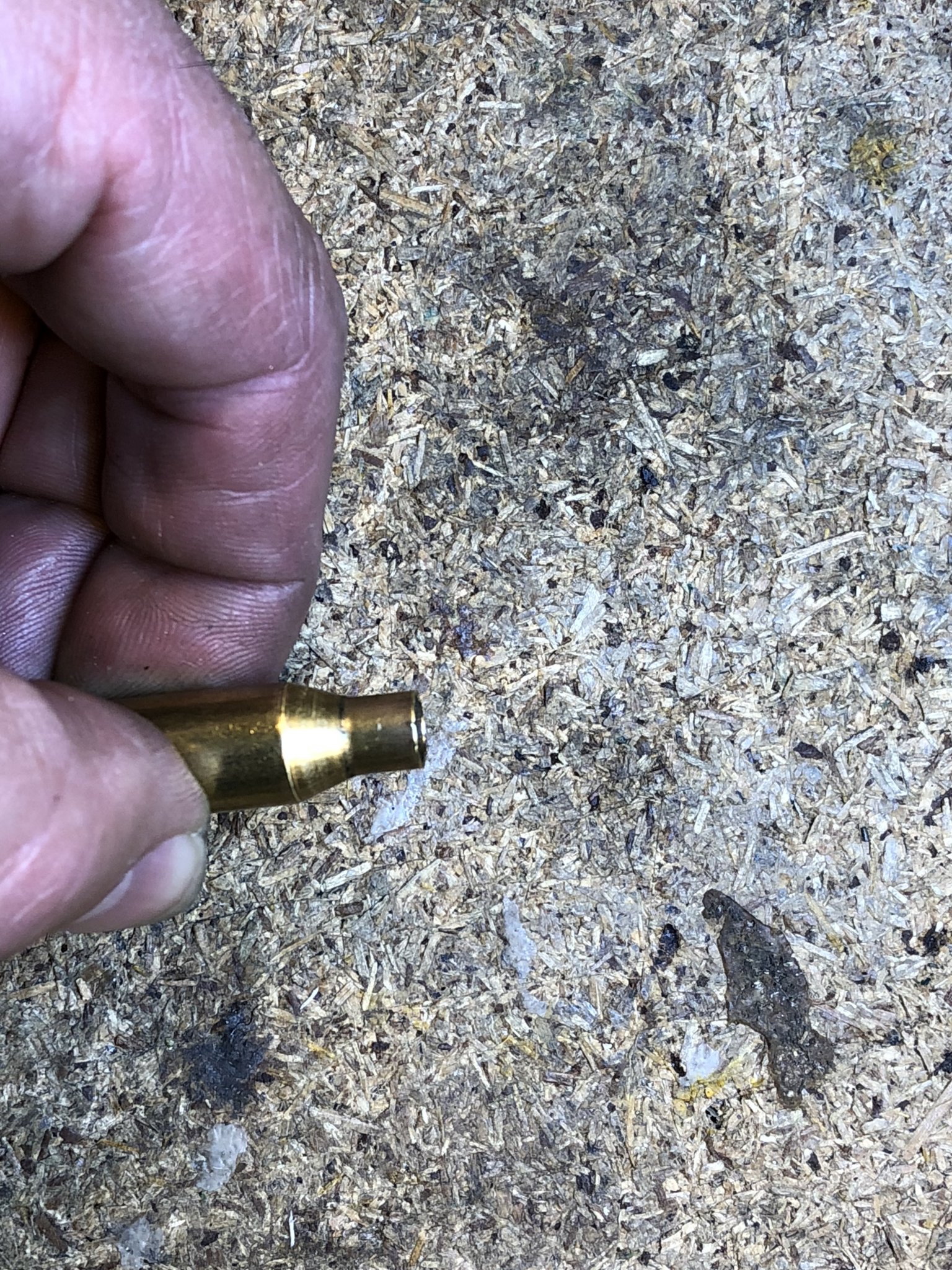

I also noticed that the once fired brass are dented at the mouth ( see picture). there seem to be material inside the barrel.
I have never experienced such a thing with the AW in the same caliber.
