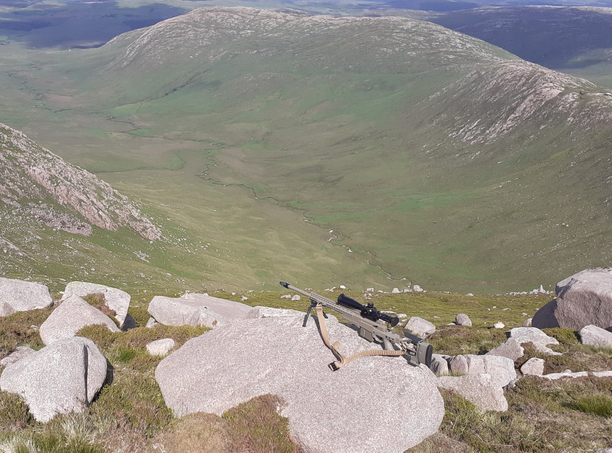

So I zero my axmc with the 338 barrell on and my turrets are at 0/0 When I put my 308 bolt and barrel on my zero shifts by 0.8mil vertical and 0.8mil horizontal, I have this set in my kestrel 5700 as an offset, so I dial the offset and my zero is always on, replace the 338 barrell and bolt and set turrets to 0/0 and my 338 zero is on. Fantastic setup
Pic for atte
ntion lol
