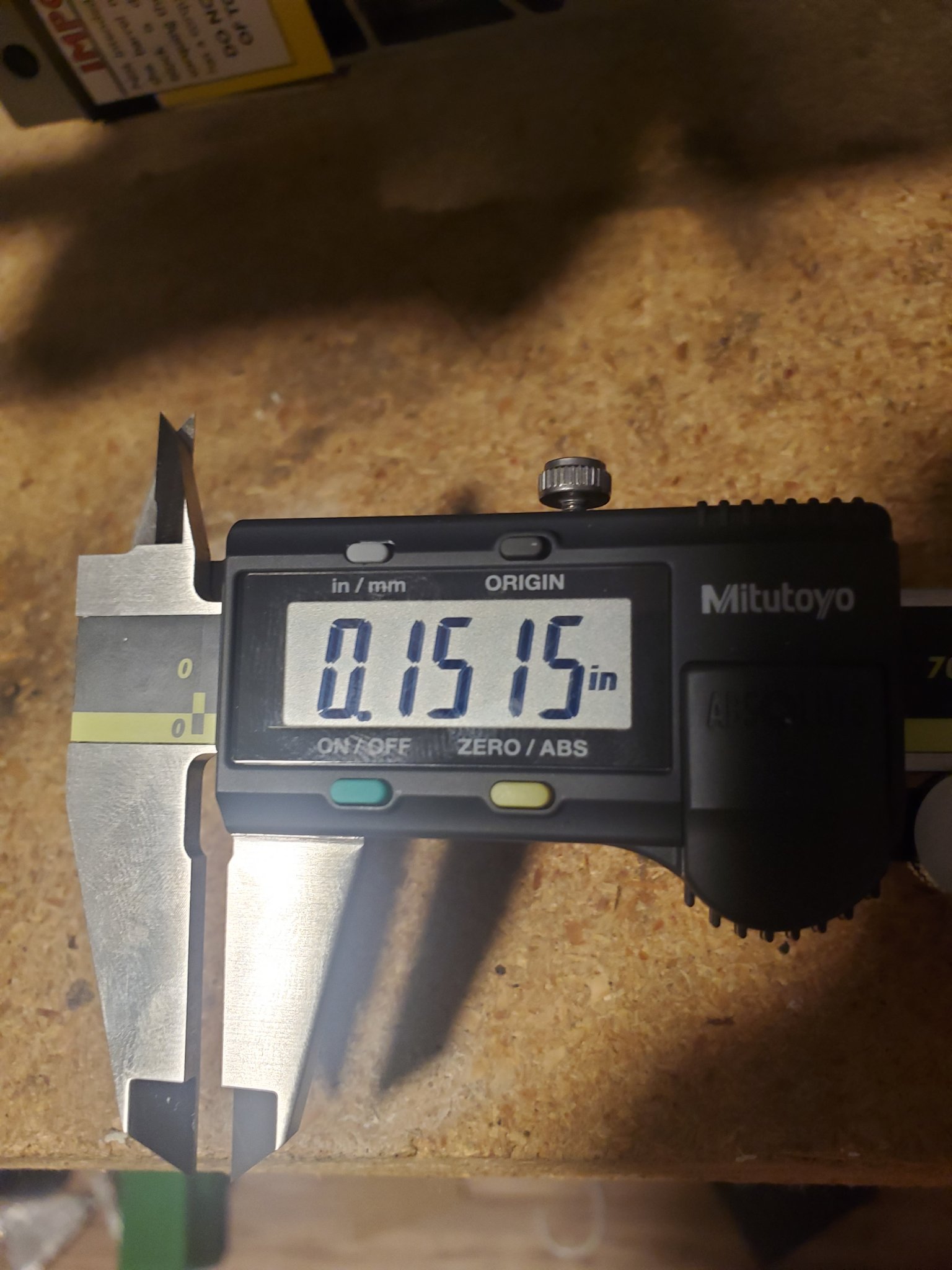

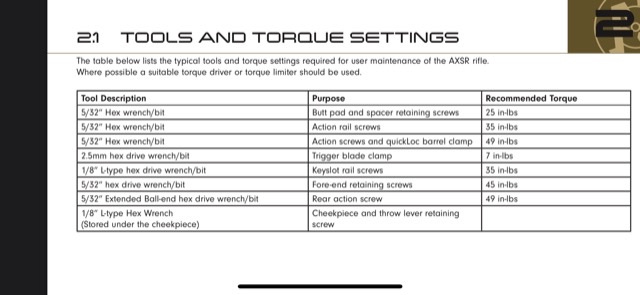

I can't get the quicklock screw to torque down to 49 in-lbs after I reinstalled my barrel. The barrel is screwed in all the way and does not seem to be twistable by hand but I can't get the screw to perceptibly tighten or trigger the torque wrench I am using. Any idea what the issue is?

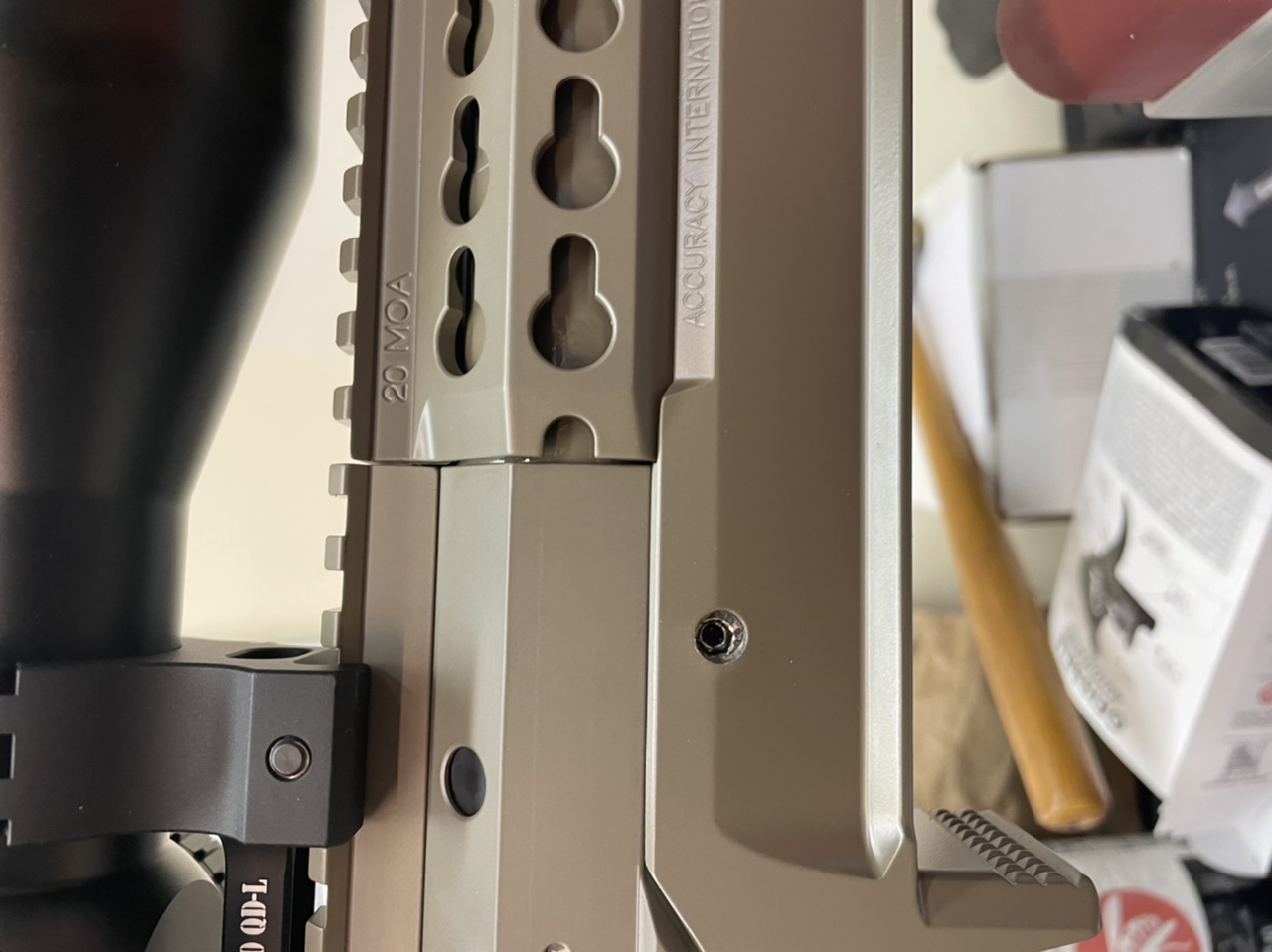

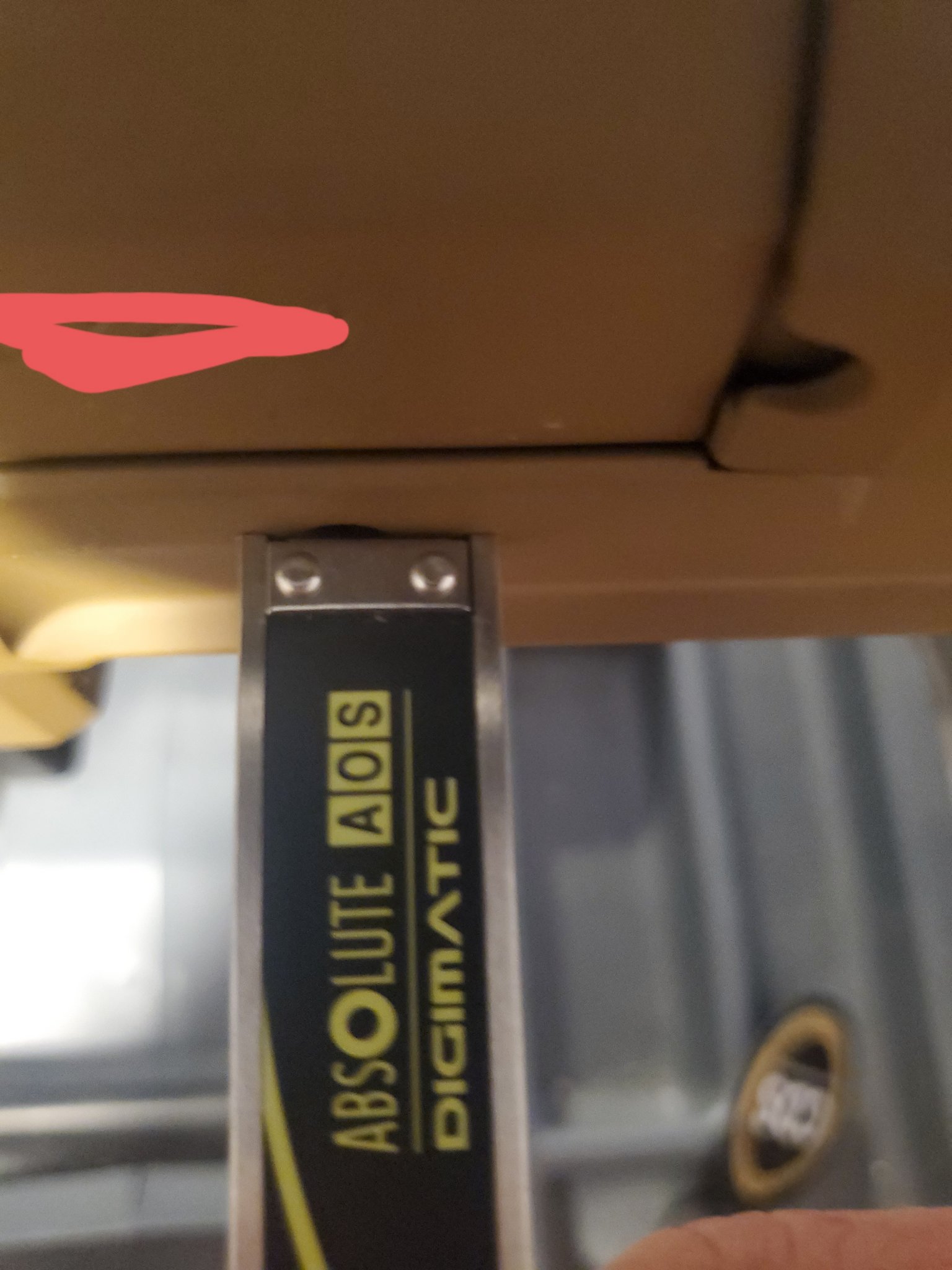

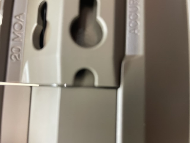

Pictures? Can you feel it starting to grab?
Here are some pics. The screw just spins. It feels a little tight and the driver ratchet will engage, then it will feel lose again. The barrel seems tight though.
AXSR isn't bonded, just separate the action and chassis and inspect it (assuming it's not just a stripped screw).
If it's just the screw, you can likely get a new one from Ace Hardware while you wait for a "factory" replacement from Mile High.
