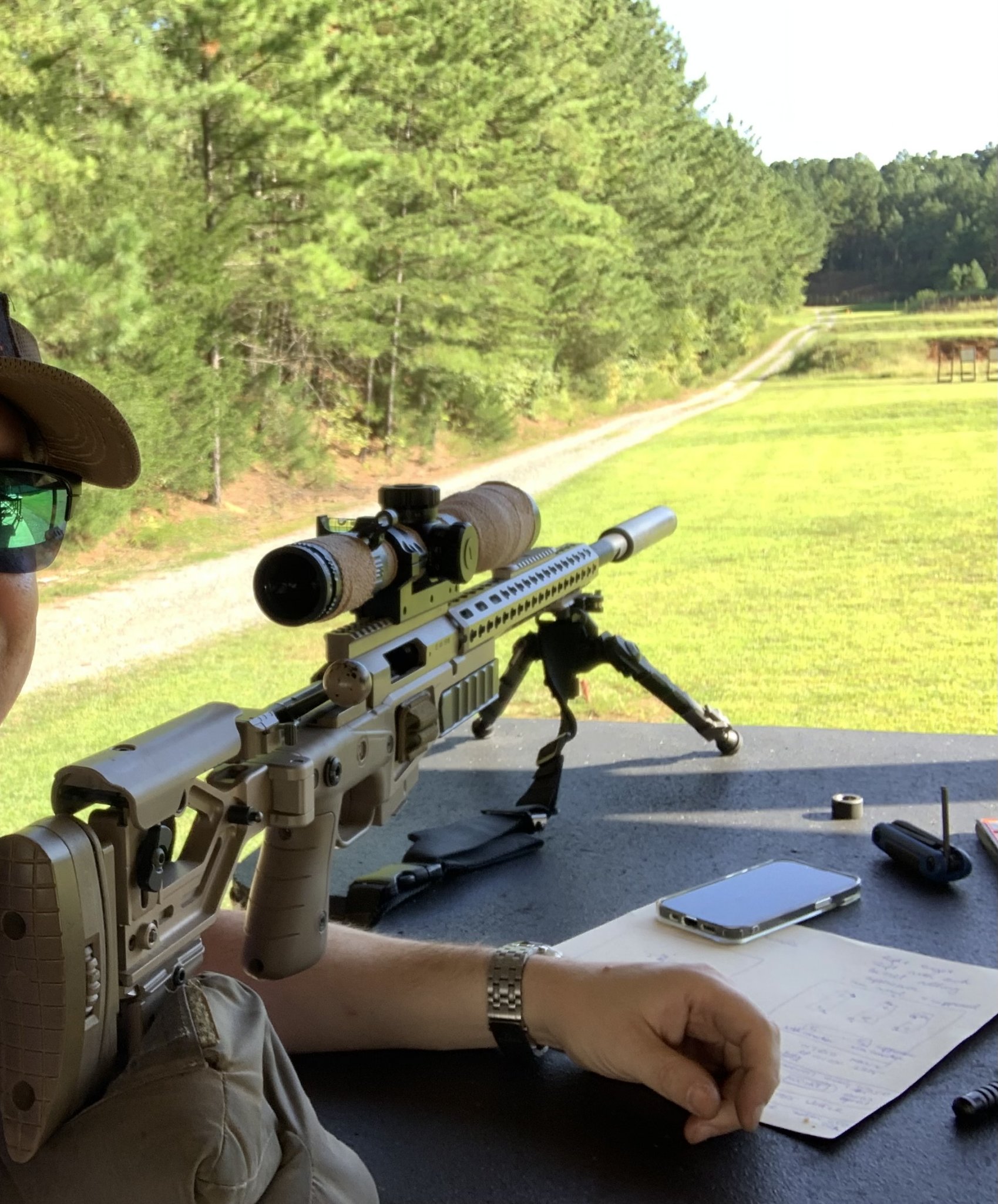

Today, I went to the range to check the POI shift that occurs when I swap barrels on my AI. I figured I’d also test the POI shift that occurs after attaching my direct thread suppressor.

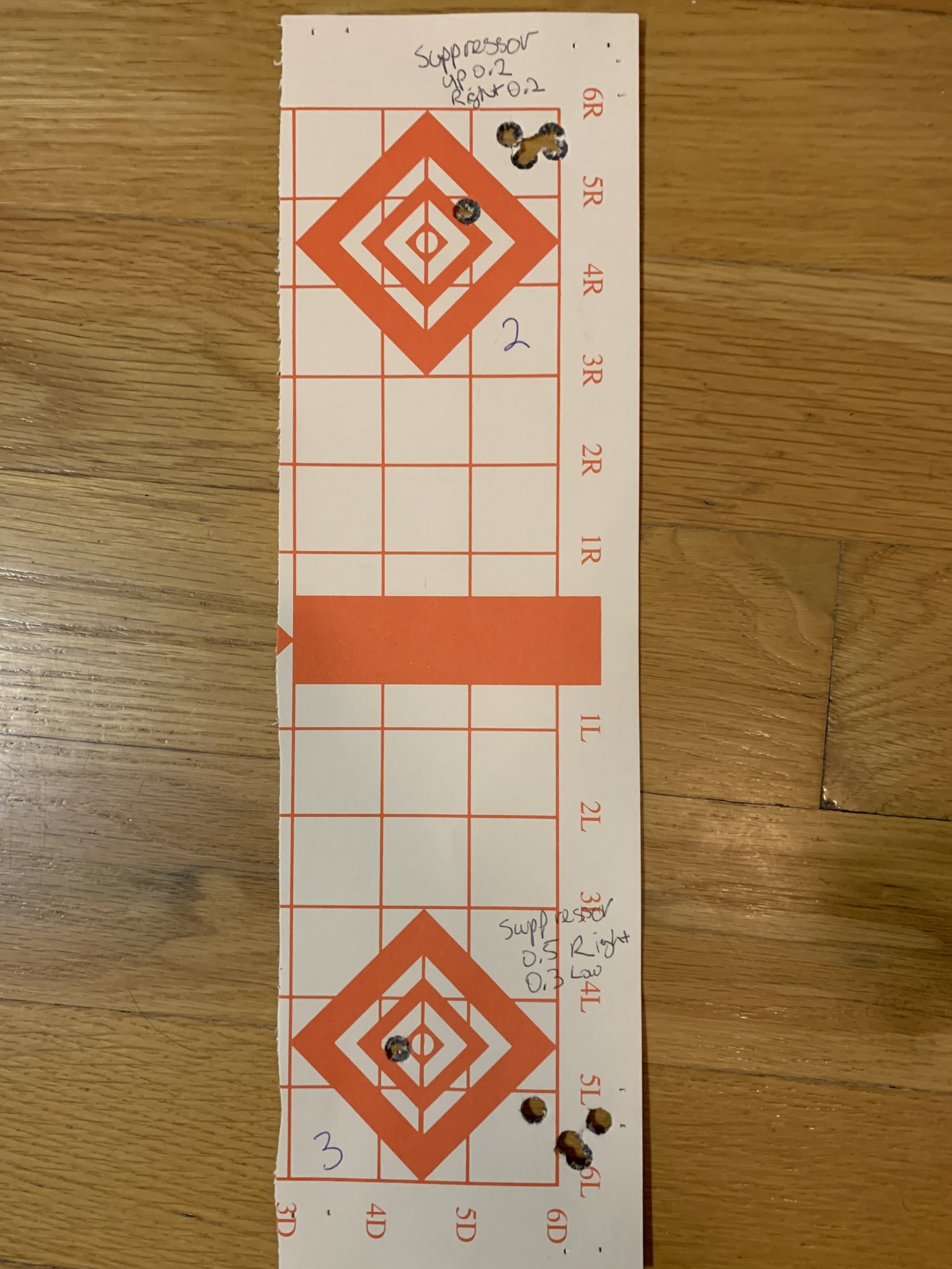

I set up two targets at 100 yards. On the first is a central POA. On the second, there are numerous POAs.
After attaching a barrel, I check the POI of a five round group. I estimate and record the shift. On the second target, I dial for the shift and take one shot. After attaching the suppressor, I take four more shots.
Target one

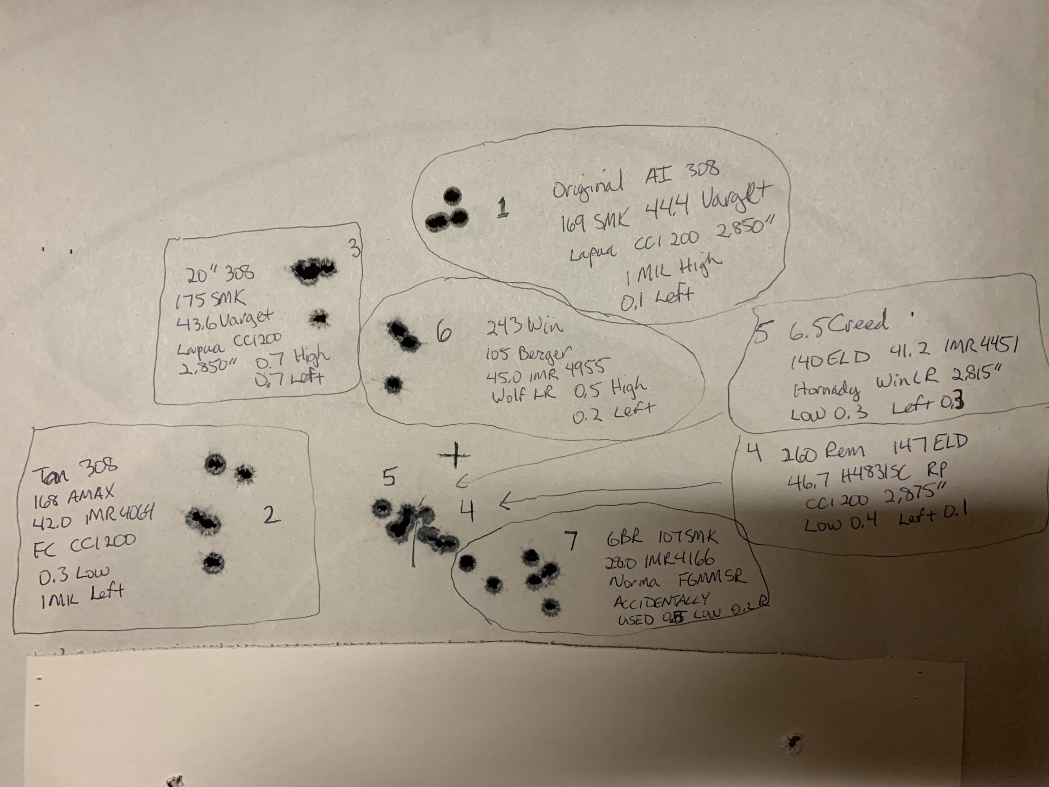

Examples from target two.
If I zero the scope and set the zero stop on the highest impacting group, I can use offsets in the Kestrel app with a profile for each barrel to keep track of everything.
