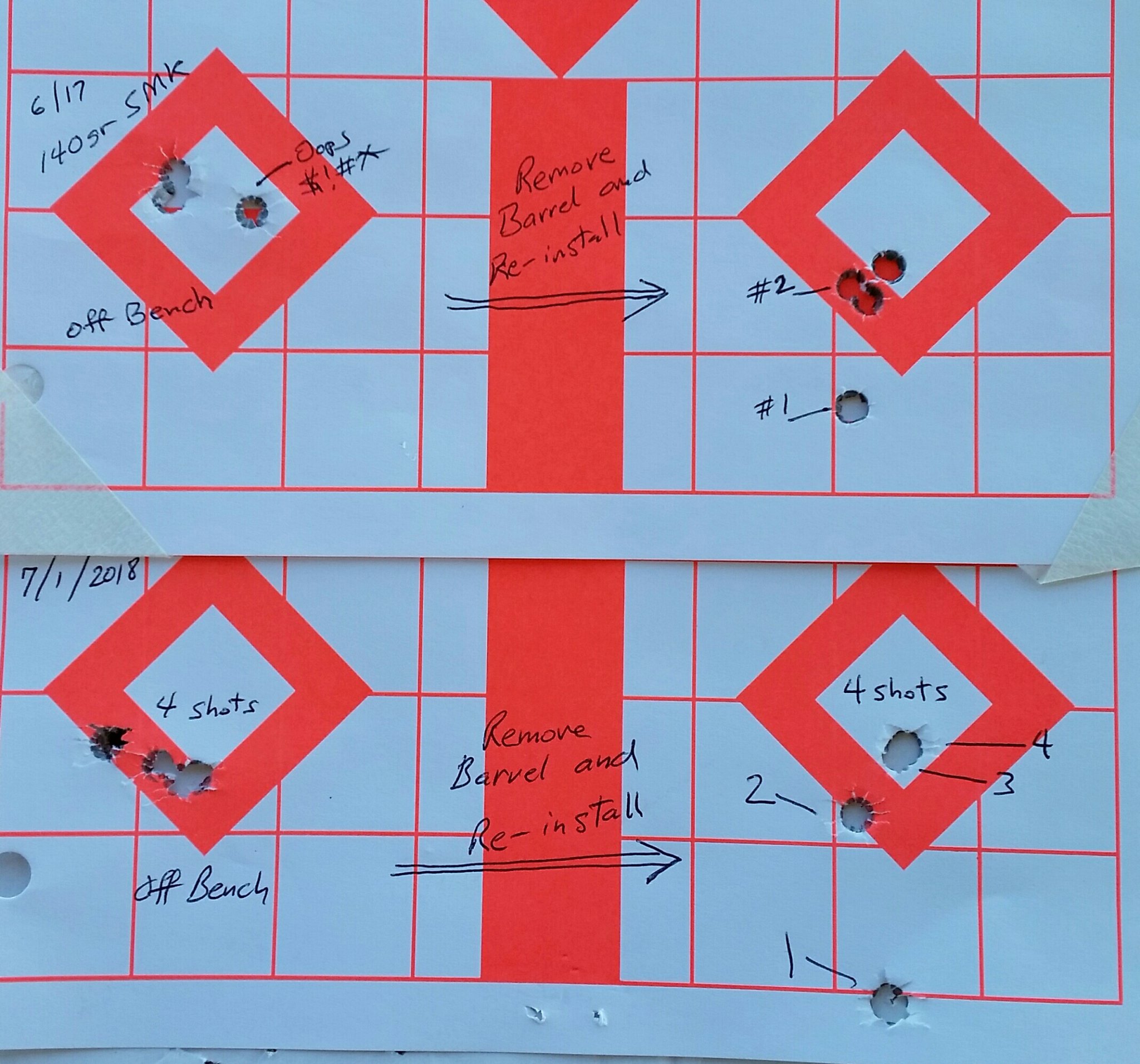

Over the last few weeks I've tried removing the barrel from my AI - AT to see where the next few rounds would impact after re-installing. In the attached picture, the group on the left was before removing the barrel, and the bullet holes on the right are where the first few shots impacted. This matches closely what Roddd describes. Very little horizontal but tenths of a mil vertical.
