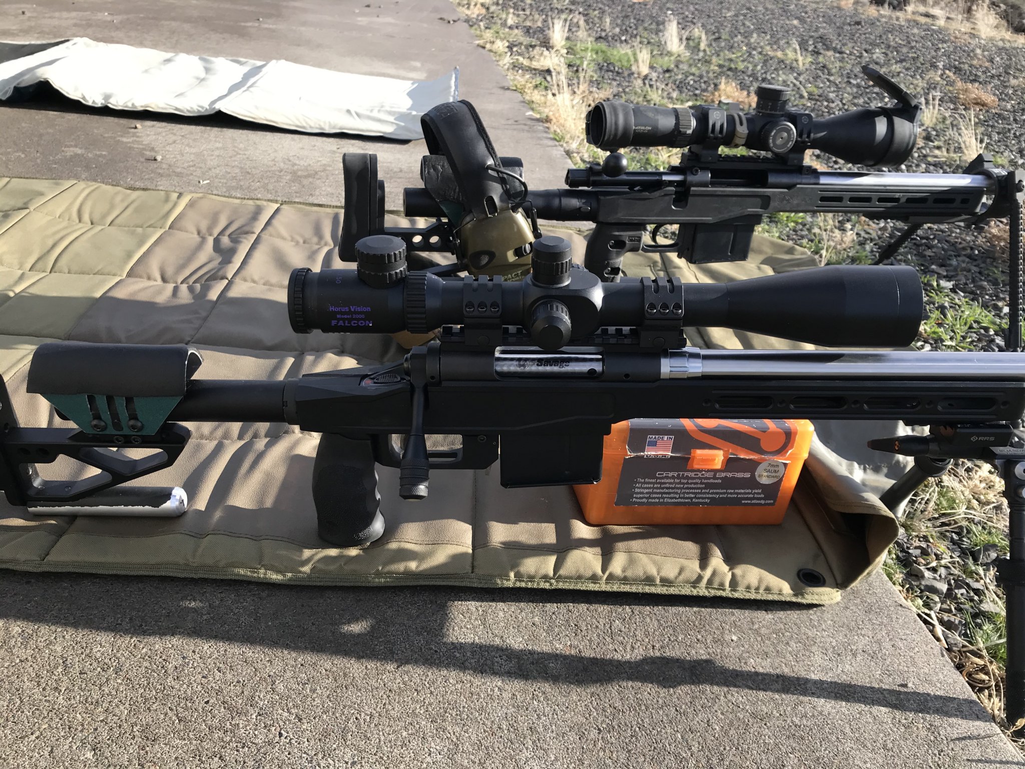

I have a Choat stock and it took a bit of work to get the PTG bottom metal in it but it worked well.
I eventually went to an XLR element chassis with bottom bolt release years ago and still run it.
