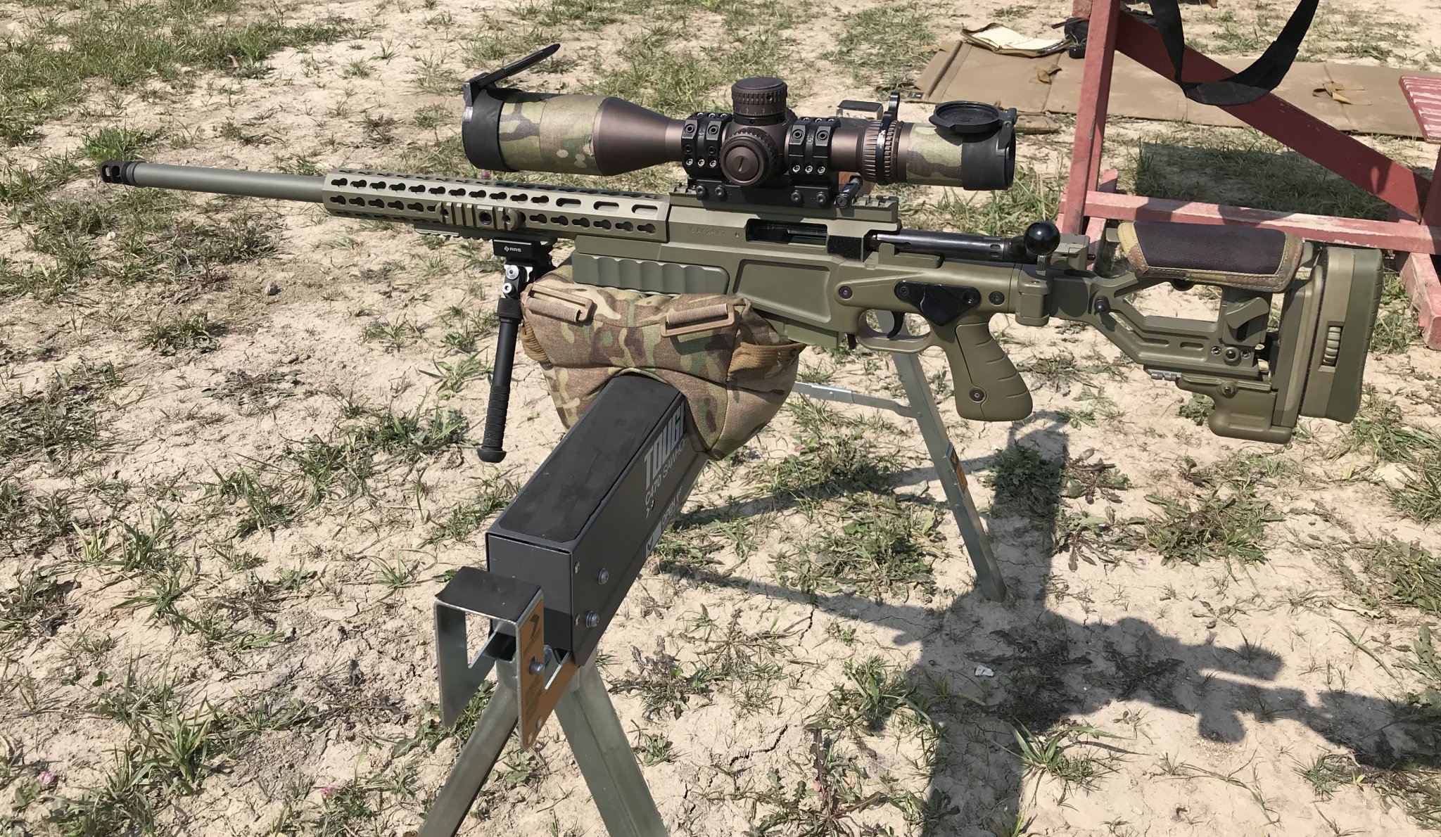

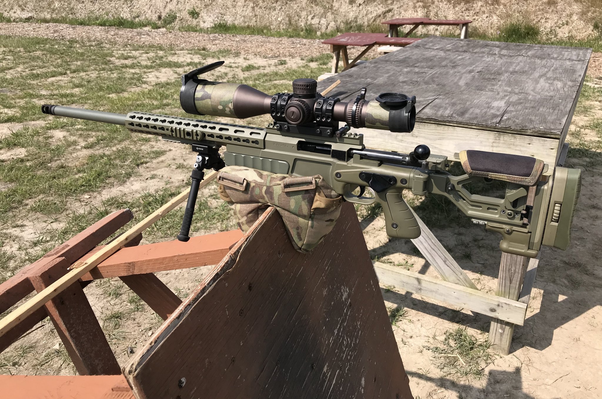

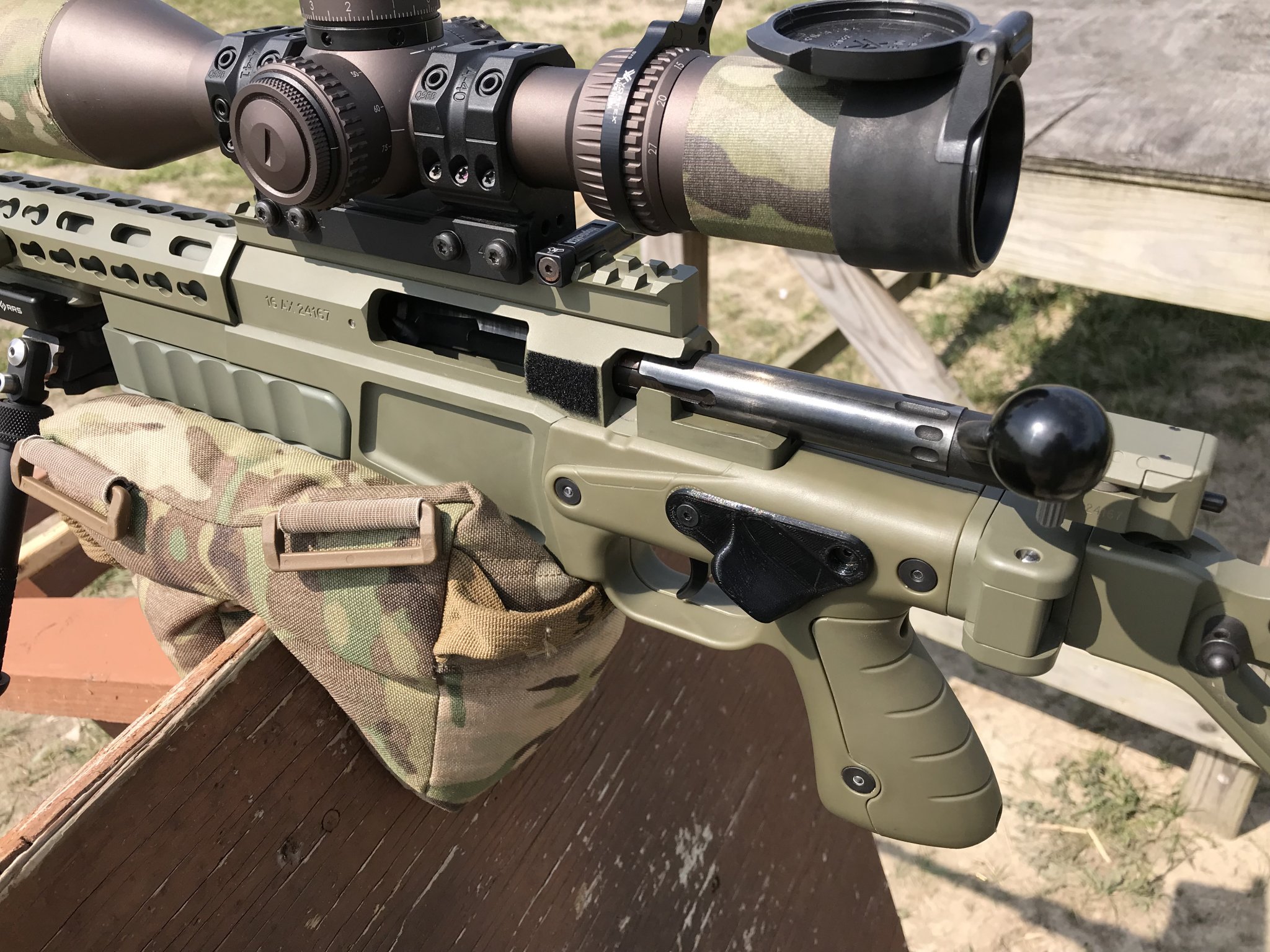

I got out to the range today for a practice session to try out the new Comp trigger for the first time. Currently have it adjusted to approximately 1.25#, or 10oz/10oz for 1st and 2nd stage weights.
I have to say, this trigger is pretty incredible and made me feel like a stud off barricades for the first time. I’ve never been able to free-recoil with this kind of consistency, let alone shoot such small groups from any kind of barricade. Even with my thumb rest, I always felt like I was fighting the 3# pull in the “wobble zone” of a barricade, now I’m not consciously thinking about when to break the trigger since it’s so much lighter. The break is so crisp as well, there’s no vagueness or creep whatsoever - you know exactly when it’s going to break.
Disclaimer- my local range is under construction so all I have access to are 70yd temporary ranges. Even so, I’m feeling extremely confident that the typical 2MOA barricade targets at most matches will be significantly easier for me now.

Yo
What type of pad do you have on your cheekpiece?
1. The new trigger is awesome. Such an upgrade.
2. I rarely see a lefty AX and I love it. I haven’t seen one other than mine in the wild.
3. When is that thumb rest coming??? ?

The thumb rest is coming...soon. The final design has been with the printer for a while now. Unfortunately their machine went down for a bit and they are finalizing the settings and hopefully working on the first batch. It’s a little out of my hands right now, but once I get the go ahead that they’re making parts, I’ll start taking orders.
