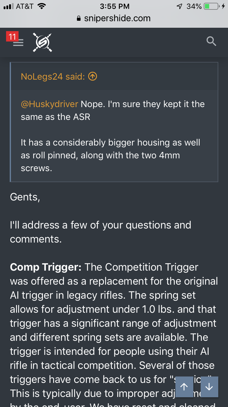

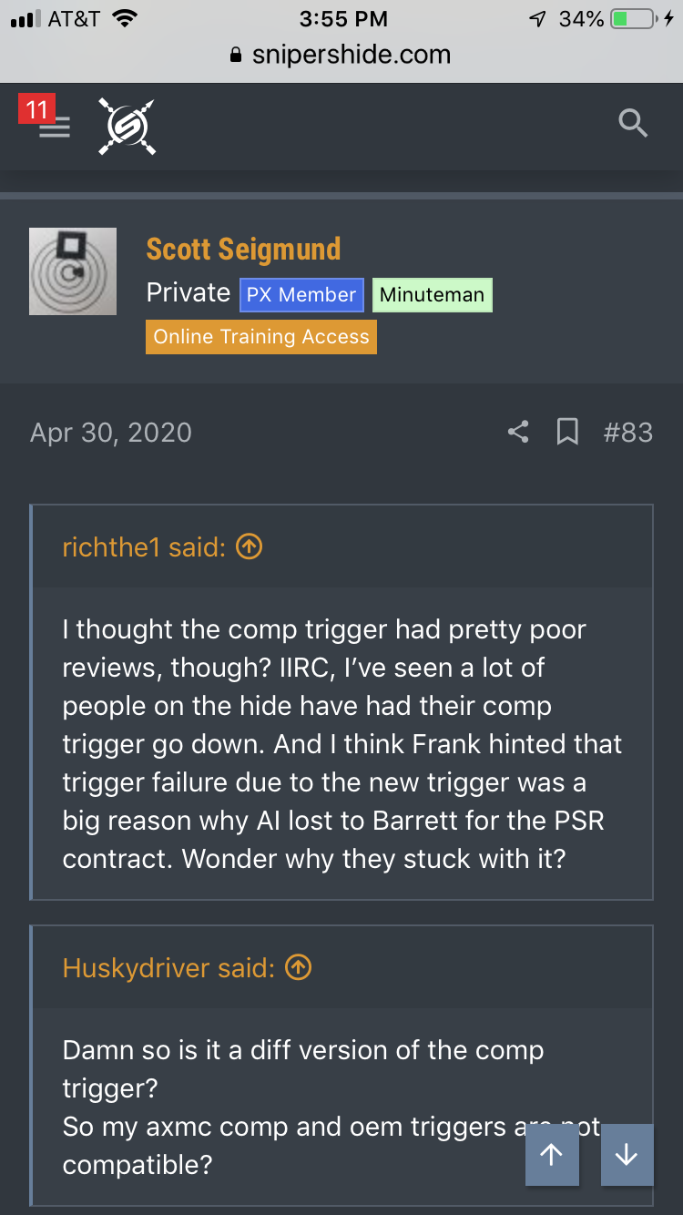

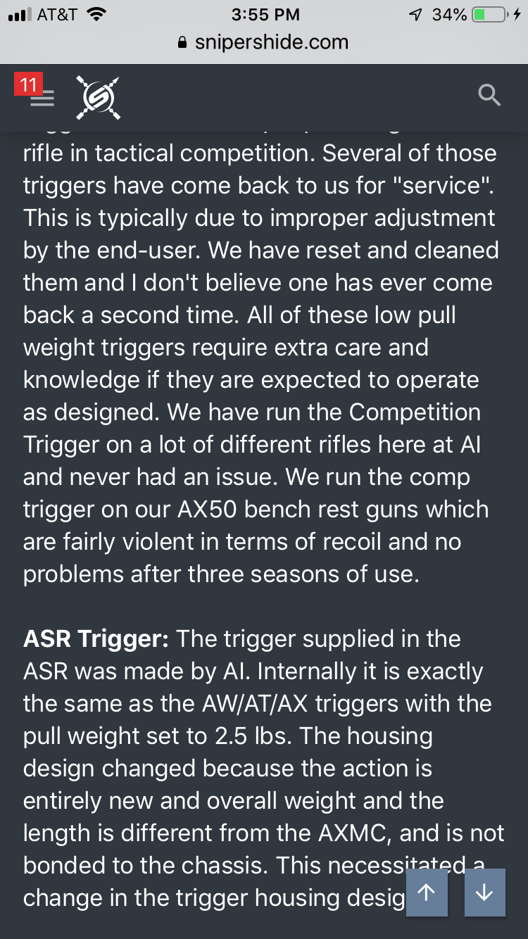

    What’s the consensus on these?
    Still 100 percent reliable and a great upgrade ?
    Or unreliable and or a meh upgrade.
    I see some have bought it tried it then sold it
    It sure seems like AI trigger problems started with that trigger.

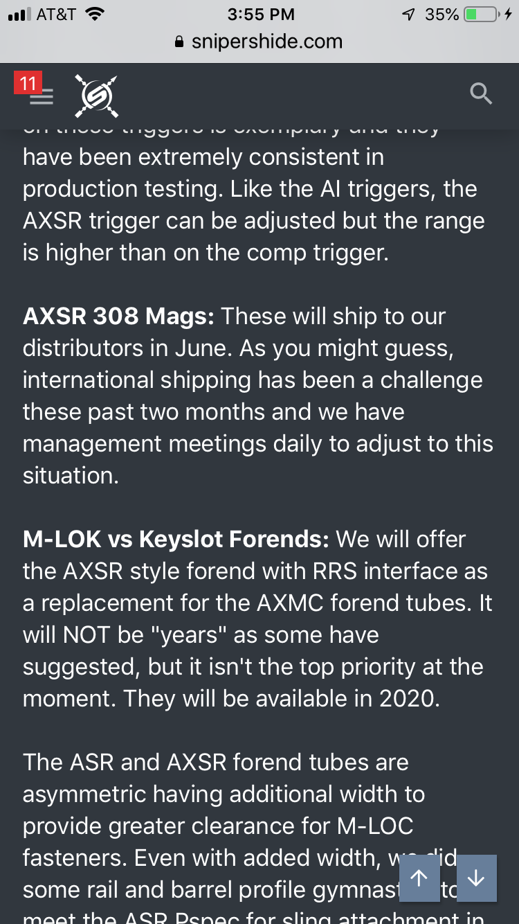

    You may look into the new AXSR trigger. Don’t remember if it backwards compatible. I think it’s a new design, and had its own hiccups, but it’s an in house design.
    • Love
    Reactions: deersniper
    It's just they can be over-adjusted too easy and I have seen them come out of adjustment and stop working.
    Also, we've noticed on our range in the sand, they quit working much quicker and have to be cleaned out more often. They don't handle the conditions like the original ones.
    Most of the problems I have seen are people trying to really squeeze too much out of them, they don't stay adjusted when you over do it.
    This is the reason it's the Barrett and not the AI, the Comp trigger was adjusted wrong and failed during the Army tests. It was all because of the trigger.
    I had to be that guy that did the adjustment
    Why would you put a comp trigger into an Army test vs the proven time and again original ?
    The competition trigger is a nice upgrade but the consensus from those trying to run them in any "not perfect" conditions is that it will degrade your reliability.
    I had one, didn't have any problems and it had a nice feel, but I traded it to have a spare factory trigger instead.

    In my mind, they are technically different but come from the same Non-AI Place as the comp trigger,
    if the same people make it,
    Yeah I think you guys are right
    The more I read the more it is a comp trigger in a different housing. Would think they would be reporting issues by now though.
    I had read a AI employee saying the axsr military competition failures were from a in house AI trigger and not the trigger currently being used but that could be bs
    In this in-depth review of the AXSR the author described a trigger issue he had, although it sounds like it was a pre-production model.
