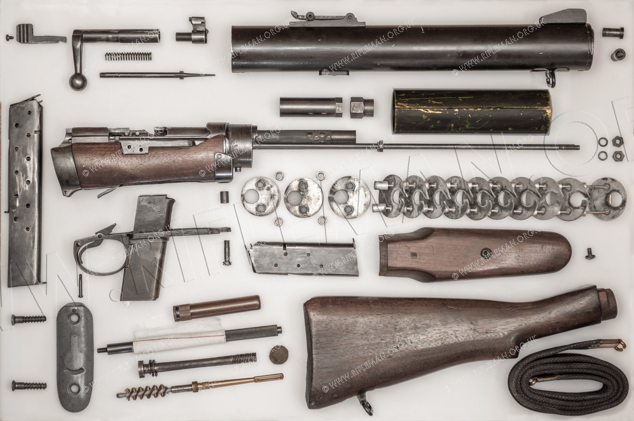

I've gone down the rabbit hole on this one being stuck in the COVID Corrections Center. I've developed a dream/concept and I'm looking for input from the experts on feasibility which doesn't include potential cost. It is a good place to put the government stimulus check though. I hope this is the correct thread on the forums to post this.
1. Accuracy International rifles are the current tits!
2. The Delisle Carbine is the historic tits!
3. Making a modern day reproduction of the Delisle Carbine using the AI action re-barreled in .45ACP with a modified bolt length, the chassis modified to accept 1911 magazines, and a modified chopped chassis fore end for a 2" x 12" can with the AI BUIS would be tits!
Thoughts? (I have to wipe down my keyboard and wash my hands now)

Lol well seeing as how AI doesn’t sell just actions, you have to buy a rifle first. So cheapest would be a non folding AT probably from the PX. Then find someone to make a 1 off bottom metal, which could be Uber expensive. I think you’d run into some of the same issues that those of us who wanted an AI in a manners/foundation stock run into. Also, what about the bolt face?
Yeah it’s quite complicated. I know of one company that makes aftermarket AI receivers and bolts. It would be criminal to chop up a real one.
Problems;
The bolt length to engage the locking lugs and bolt travel relative to the position of the magazine to chamber the round from the mag to the chamber, the barrel/chamber depth in the receiver relative to a modified bolt length that will still engage the lugs, the receiver bottom lugs that mount to the chassis (can’t be cut into without some issues), proper bolt face for .45ACP, will the extractor hold the .45 shell, and will a .45 shell properly eject from the port, just to name a few issues.

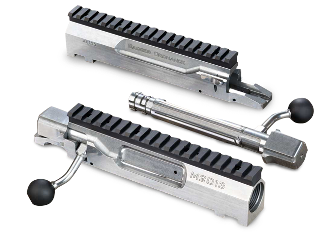

Who makes an aftermarket AI receiver????

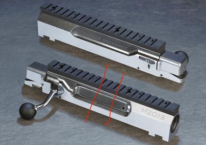

I figured out one possible fix. Cut the receiver in the middle of the ejection port and shorten the overall length of the receiver making the port large enough for the .45 round as well as cutting the bolt length to match the shortened receiver.
I figured out one possible fix. Cut the receiver in the middle of the ejection port and shorten the overall length of the receiver making the port large enough for the .45 round as well as cutting the bolt length to match the shortened receiver. View attachment 7296167
Dude, just stop. Seriously. It would not be awesome.
What’s the significance of an AI/AI clone action? Why pick the biggest, clumsiest action made. Other than being a bolt action, it has absolutely nothing going for it with regard to your project.
Cut the receiver ? Wtf ? Then your magazine system, stock and action screws won't work.
Why not shorten the bolt and extent the barrel thru the receiver like a normal person ? It's how I build them, so much easier.
If you cut the receiver, you have to cut the bolt anyway...

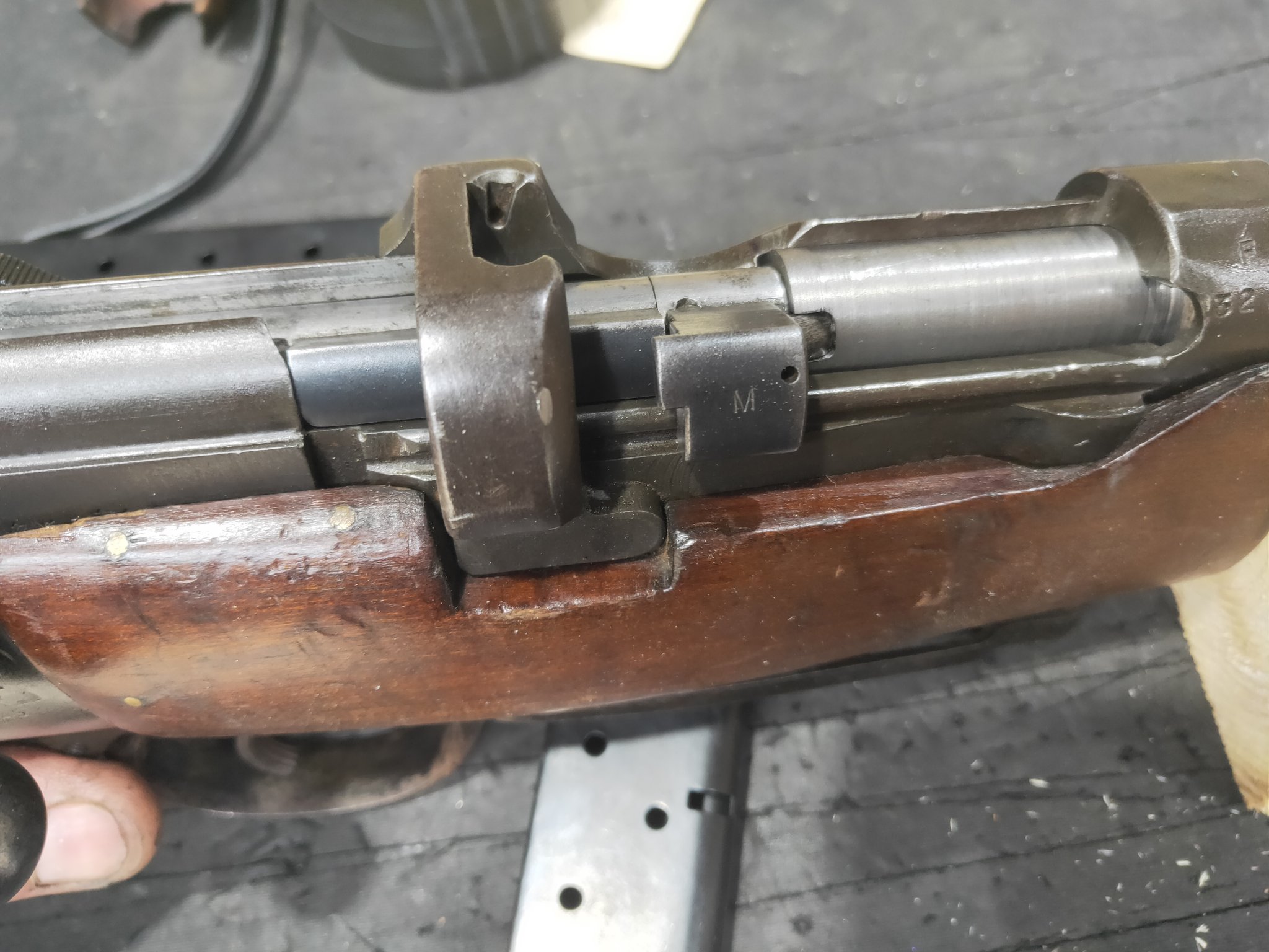

I figure that because the locking lugs on a SMLE are in the rear of the receiver and extending the barrel into the chamber area I lose the use of the locking lugs on the bolt.

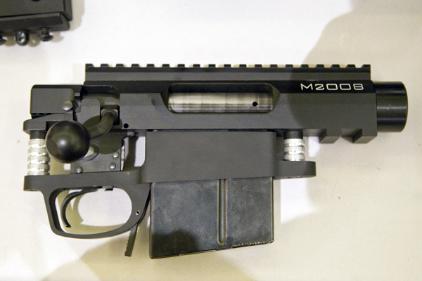

Look into Marshal Precision. They have already started the process for you. I'm not sure about when/if they will be available for import, but they may help you along the way.
Reactions: PBWalsh
