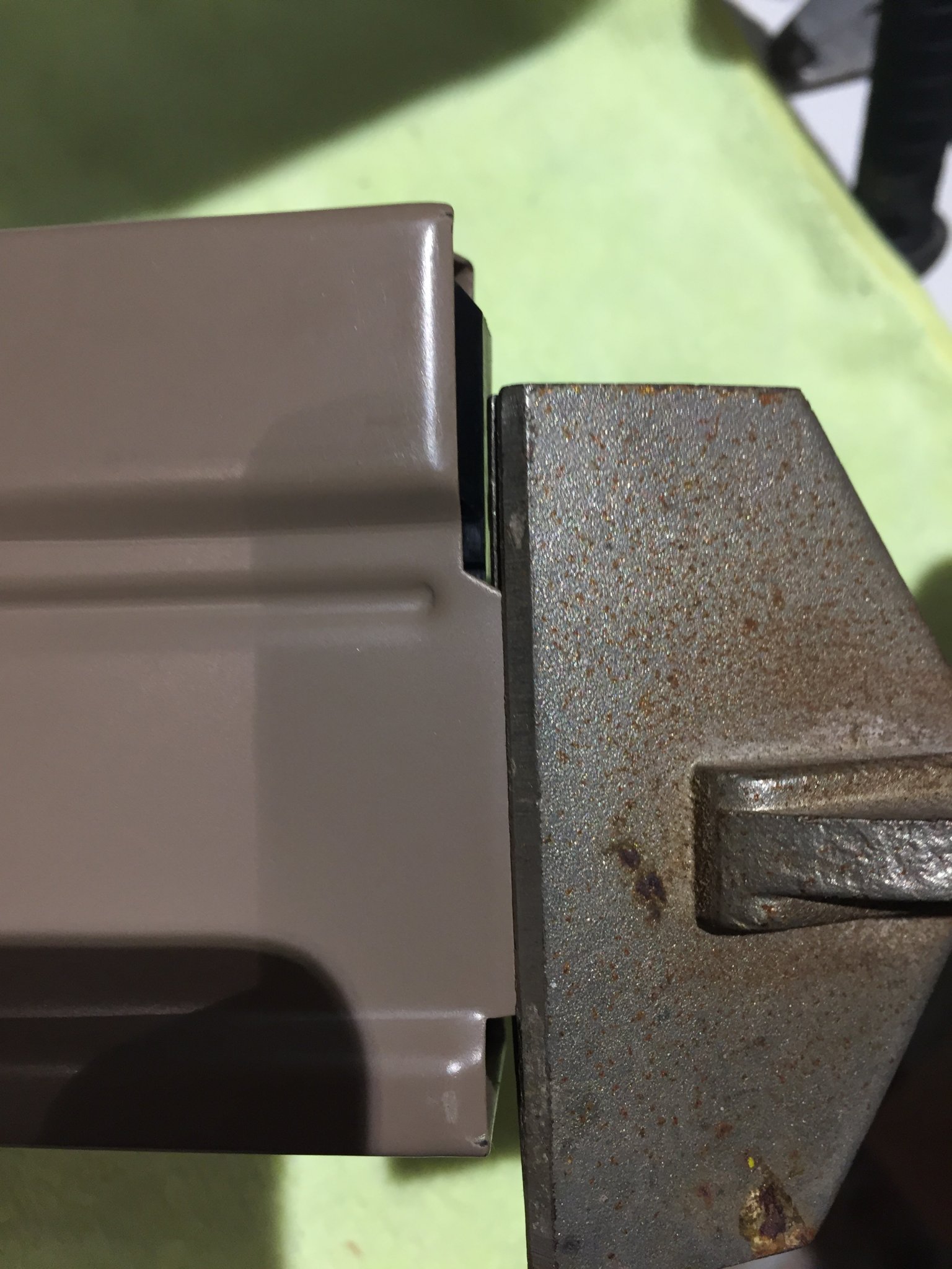

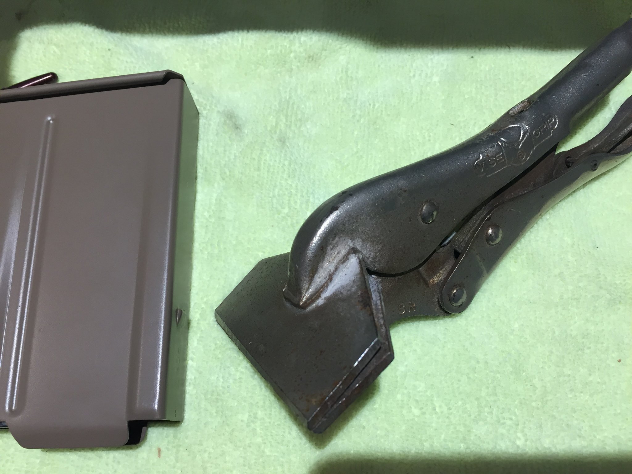

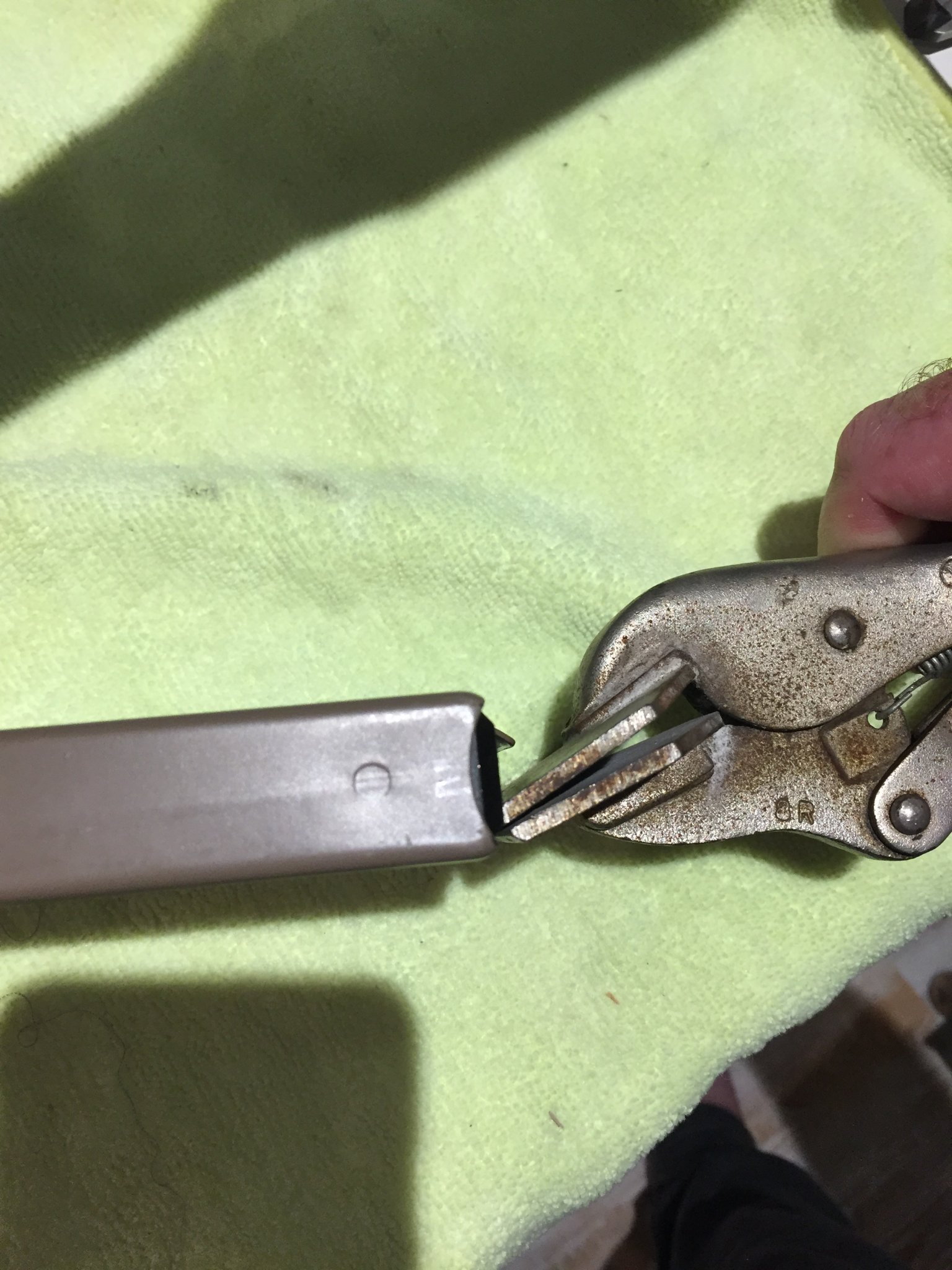

There are inexpensive tools made for modifying feed lips (MDT makes one). You could also improvise, but you don't want to tear the lips up with regular pliers. I happened to have some flat-James Vise Grips that seemed made for this.

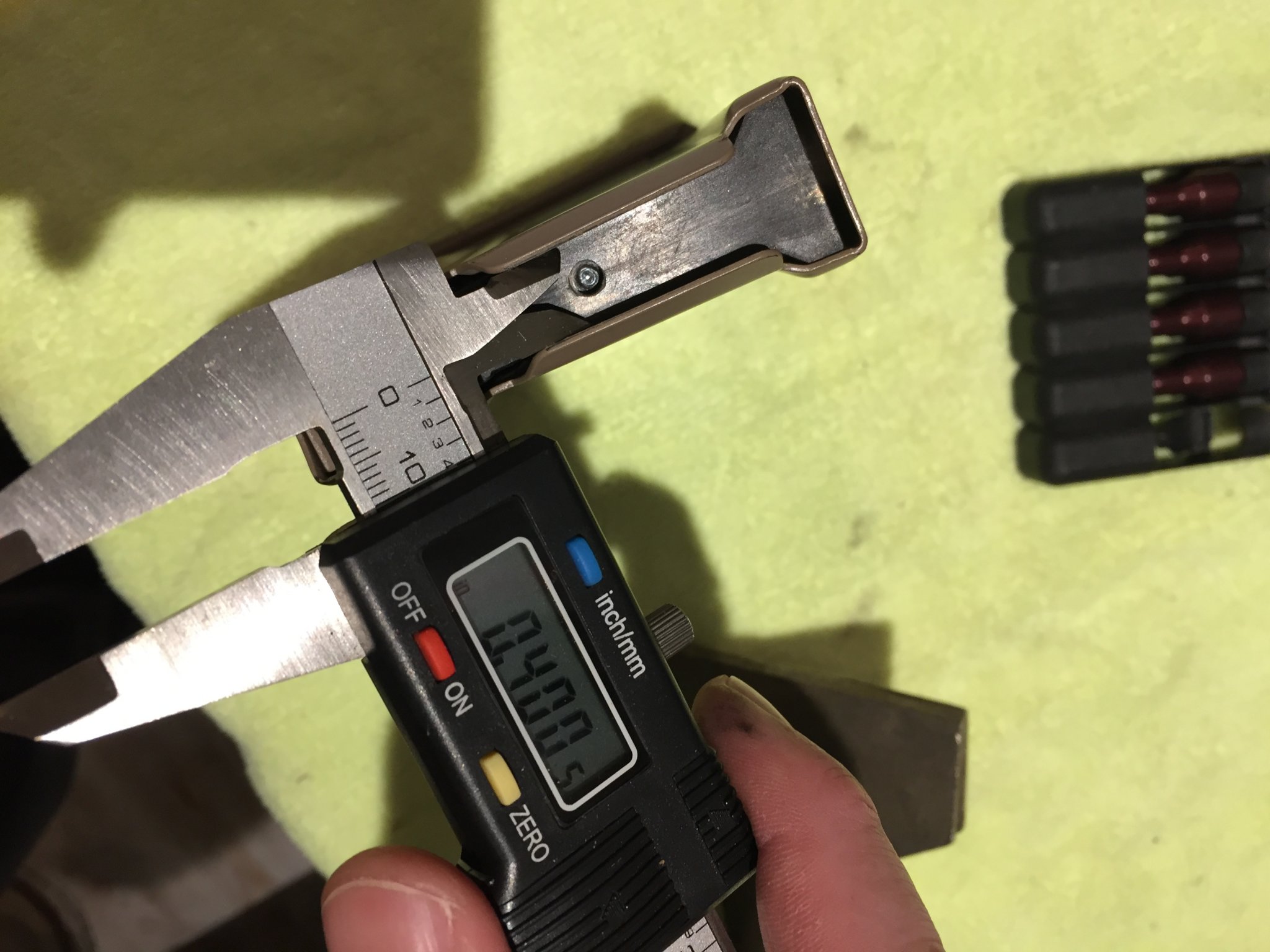

I measured the factory magazine feed lip gap at:
Rear; mid; front
0.397; 0.390; 0.337
And after a few times gently bending outward (pliers provide lots of leverage), I tried feeding again, with considerably improved bolt effort and cartridge behavior. I re-measured the feed lip gap at:
0.423; 0.413; 0.400.
I'll leave them here and run it at the range next time I go, but it feels good running 6.5 snap caps at home (snap caps are about 8 thousandths narrower than my 6.5 Prime cases, so more tweaking might be necessary.

I have been using the sheet metal vice grips to bend mag lips, only difference is I use some electrical tape on the jaws not to mar the feed lips.
Works great.
