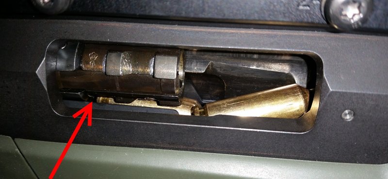

    Neat that it's running with AW mags. I tried getting 6 Dasher to run in my AT about 2 years back, but the "step" where the bolt head inserts into the bolt body kept snagging the next round in the mag and would hang up the bolt since the tip of the bullet was still against the front of the mag body. If you ran the bolt quickly like in the video above it was OK as the bolt body would "skip" over the next round down in the mag, but if you tried to run the bolt slowly it would snag the next round down in the mag after stripping the top round off the mag lips and stick the bolt.
    Here's a pic showing the issue I had with some 6BR cases I was testing with, you can see the bolt body snagging the head of the next case in the mag and the case tipping downwards because the bullet tip is jammed at the front of the mag:
    When I couldn't get the AT to feed reliably out of the double stack AW mags, I decided to test in my AE instead using AICS mags, initially with home made spacers and modded magpul followers... that worked great testing with 6BR cases so I had a 6 Dasher barrel spun up and the firing pin turned down and the bolt bushed. I've since switched to Josh @ PVA's AICS dasher mag kits which work great. 6 Dasher out of the AE is a nice combo.
    Would really like some more pics/details on that AW mag spacer and also videos of how it feeds when running the bolt slowly... if I could get my AT to feed dasher reliably I wouldn't need my AE anymore!
