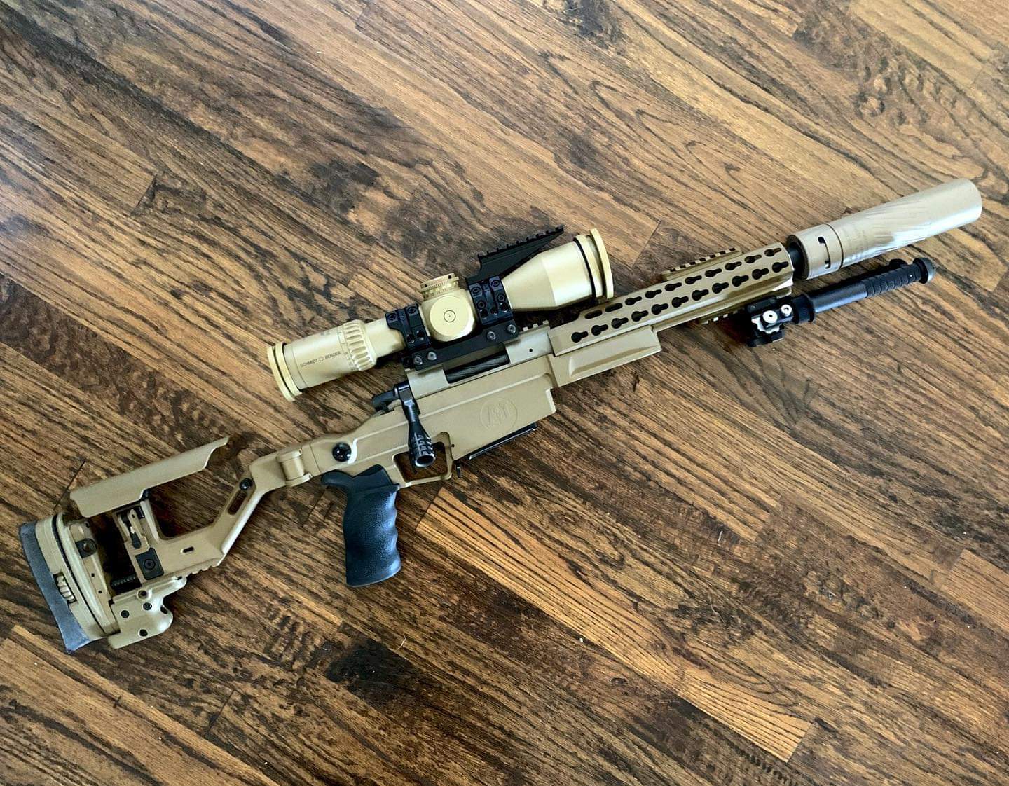

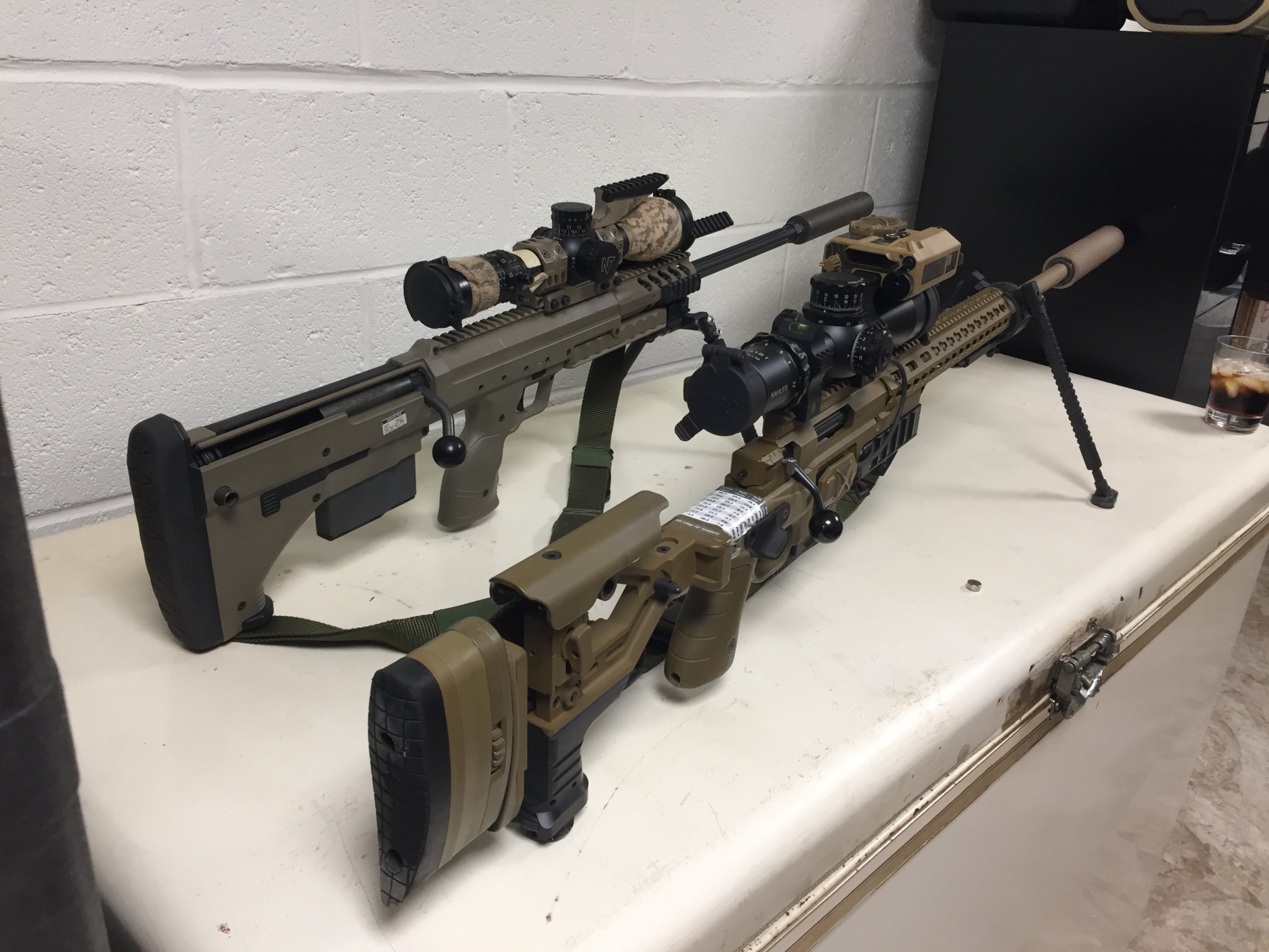

Of the rifles you listed, I have an AI AX short action and DT SRS, in addition to other rifles, like a Bighorn TL3 in an MPA comp chassis that serves as my primary match rifle. Between the AI and DT, I love them both for different reasons. I find accuracy and precision between the two are nearly identical, maybe just a very slight advantage to the AI due to it having a better trigger. The DT trigger is nice, for a bullpup, while the AI trigger is just nice, period (if that makes sense).
Fit and finish goes to the AI. For either rifle, I can go from one caliber to another in a matter of minutes, although the barrel change on the DT is faster, if that matters to you. Just loosen four bolts, pull out the old barrel, insert the new barrel, torque the bolts, and you're done.
What I love about the DT is how compact it is. With a 26" barrel and suppressor, I'm still significantly more compact than the AI. The downside is you either love or hate the bolt position on the DT. There doesn't seem to be any "in between". You have to get behind one to see if it's something you can tolerate, and that ignores if you have a stage requiring off-hand shooting. It's doable, just not ideal.
The other downside is DT mags don't lend themselves to the typical match stages. The 10 round DT mag is long, since it's a single stack, and considerably longer than even a 10 round AI mag.
I agree the DT single stack mags are a huge downside, offset only by the upside of DT's shorter OAL.
The DTA mag is its weakest point. The magwell is kinda just 2 plastic skins sandwiched together. The mags are expensive, single stack. Otherwise it’s a great platform but unlimited money Id get an AT-X. On a budget ? You can find an older A1 which is superior to the A2/M2 IMO.
The DTA is compact but harder to balance on barricade because of the weight distribution but from the bench or tripod it’s nice.
And, in my opinion, as a downside, it ranges from mildly irritating to significant, depending on your use. I also forgot about its balance on a barricade, as someone else mentioned. It's certainly doable, just not, as I said about offhand shooting, ideal. I've used my DT in PRS matches and done well, but I would've done better with my TL3/MPA chassis, especially when you consider some stages have 10+ targets at a stage. In field matches, where I don't have barricade constraints, my DT has performed just as well as any of my other rifles. I regularly shoot the Sporting Rifle Match at Whittington Center and have used my DT several times. Each stage only has 6 targets, so my DT mags aren't an issue.

I lurv my Desert Tech, once you get used to the compactness and the rearward weight bias for offhand or supported positional shooting it is hard to go back to a traditional, front heavy configuration rifle, the DTA is absurdly compact and easy to manouevre with the shorter barrels.
Traditional configuration rifles definitely balance better on tripods/barricades.
The bullpup bolt feels a little awkward for me in the prone, but better than a traditional action in any other position.

Not mine :
My PRS rig Is for prs only. In the event of the "end times" im not humping a 22 pound rifle on my back while carrying another semi auto, so OP builds a PRS gun or a light Weight field gun, I personally think u ain't gonna do both
