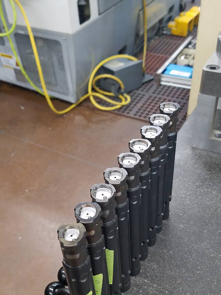

I can help:
https://www.longriflesinc.com/colle...ing-m700-striker-pin-hole?variant=49376970189
Reactions: Bradu

One thing that makes me nervous with bushing the firing pin, is when I read on LRI site “This will alter the headspace dimension of the rifle slightly. With the recent implementation of our new milling center and probing, we can now control this tolerance quite well. Expect your headspace to grow by .0005"-.0015".” Not to mention that it might void the AI warranty.

Getting my bolt bushed by LRI was the best money I could’ve spent. Or you can buy a new small firing pin bolt assembly from Mile High. They do not offer the bushing services.
