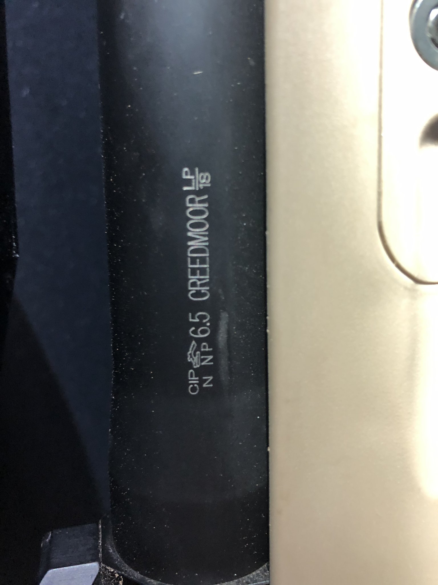

    Your “factory” barrel is likely a Bartlein. You can’t get any better in that department. Chop what you got and run with it.
    Actually he has an AT so his barrel is likely a LW barrel if it has UK proof marks.

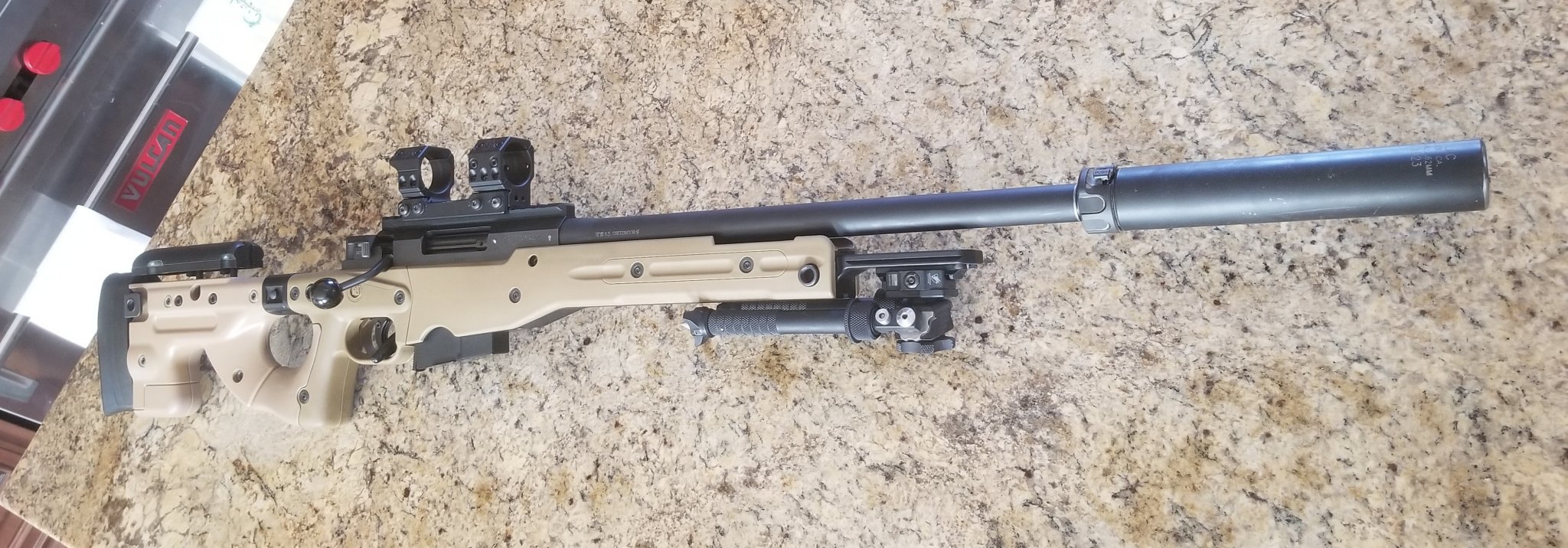

    I had my factory AT 6.5 barrel cut to 17.5" and with 8.5" suppressor attached it's 23.5" from the face of the action. Haven't shot it yet, I pulled the scope off and put it on a hunting rifle for this fall.
    Sorry in advance for the thread derailment but @Wyfox I think your pic just helped me decide on which SamB spigot to get. I’ve been going back and forth trying to decide between the Picatinny or dovetail spigot.

    I didn’t think that division between models still existed. Good to know.
    So I'm assuming you're referring to Lothar Walther when you say LW? Does this mean the barrel was spun up in the UK before it made it over here, or the blank came from LW over there and it was spun up in the states somewhere?
    Regardless of where it's made, I am not worried about it. That's why you buy an AI to begin with as far as I'm concerned. Just curious to know the story behind my equipment.
    Yes LW is Lothar-Walther.
    It’s my understanding that AT’s have barrels that are spun up and proofed in the UK, and AX’s have barrels made from Bartlein blanks spun up over here.
