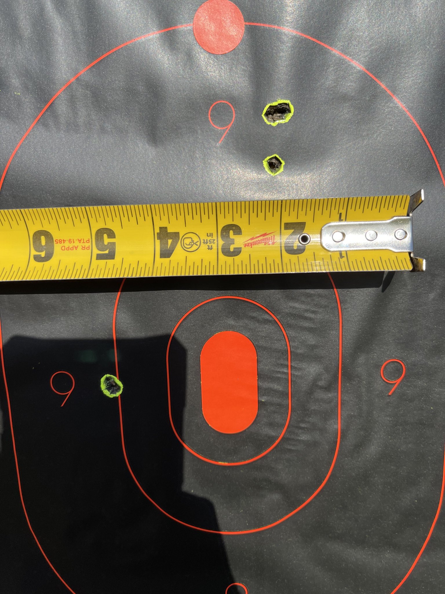

And I was thrilled, to say the least. The first shot to the bottom right of the nine was my fowling shot. The group above that is three, and the group to the bottom left is three...

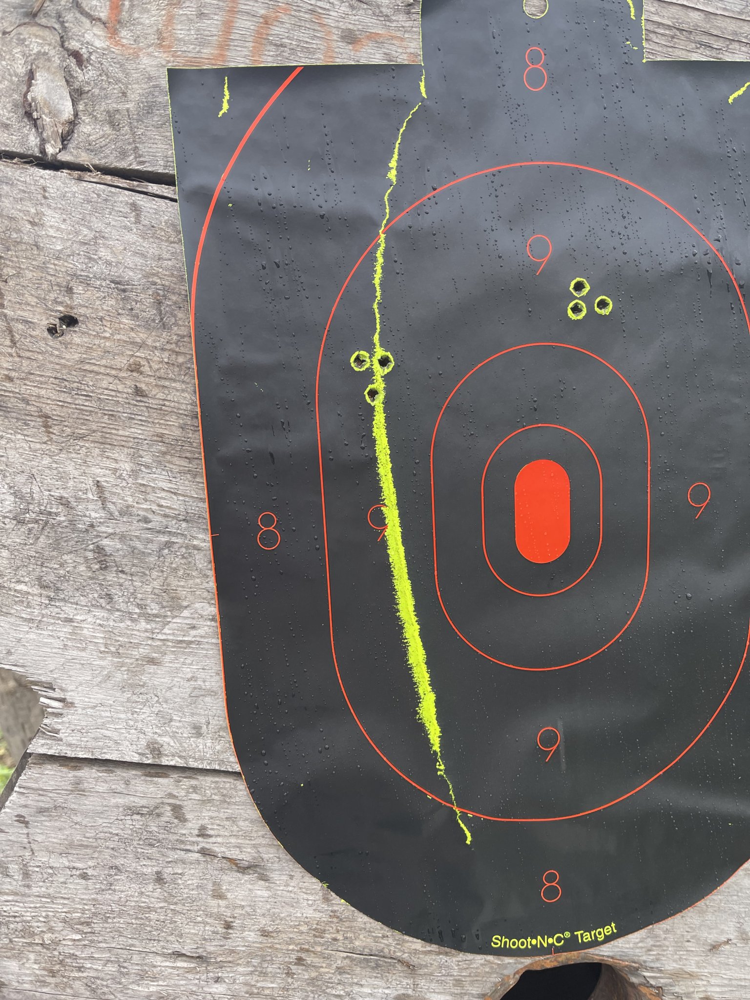

And this is what I got.
I shot more after this and couldn't get it squeezed down. I even swapped barrels to a different caliber with Copper Creek Ammo and couldn't shoot anything too impressive. Certainly not on Par with the TL3.
I have checked the usual culprits, scope rings, base, muzzle brake, and the retention screw for the QC barrel, but I got nothing.

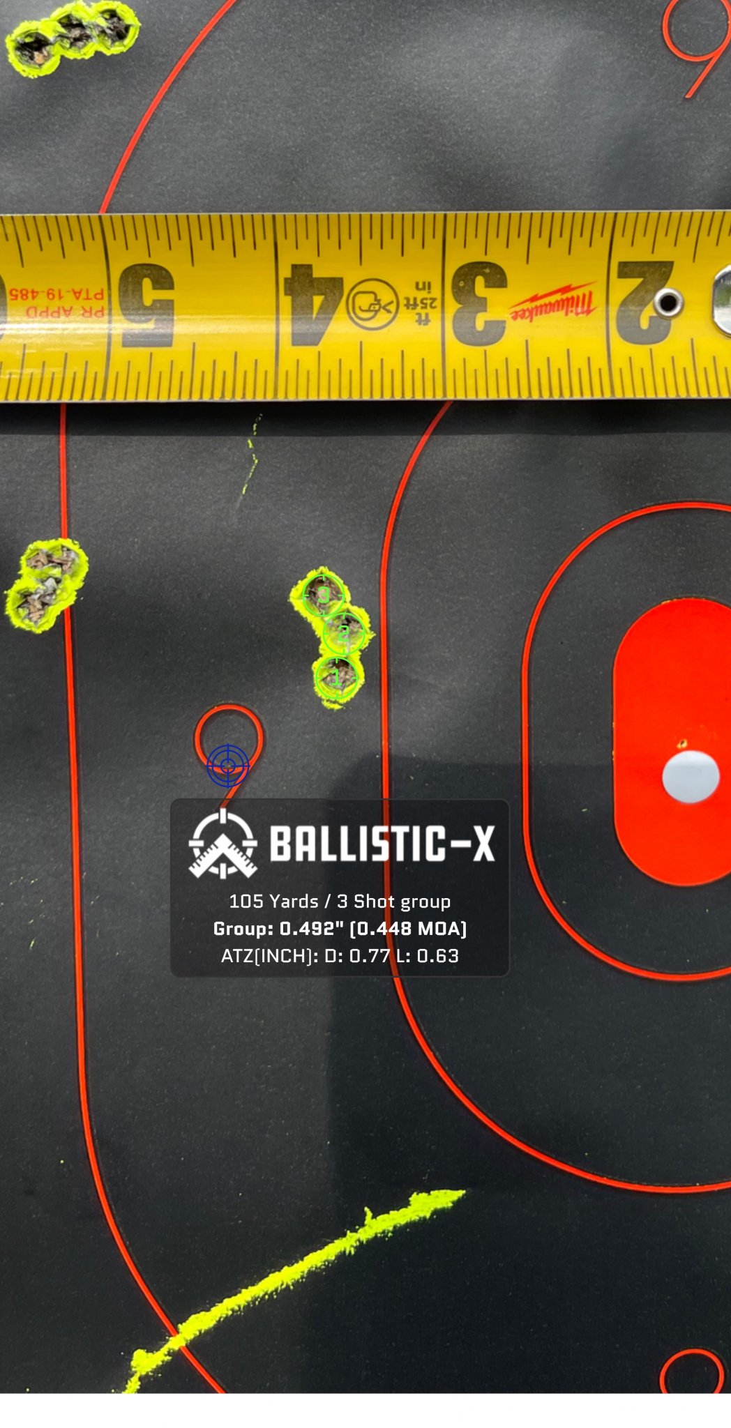

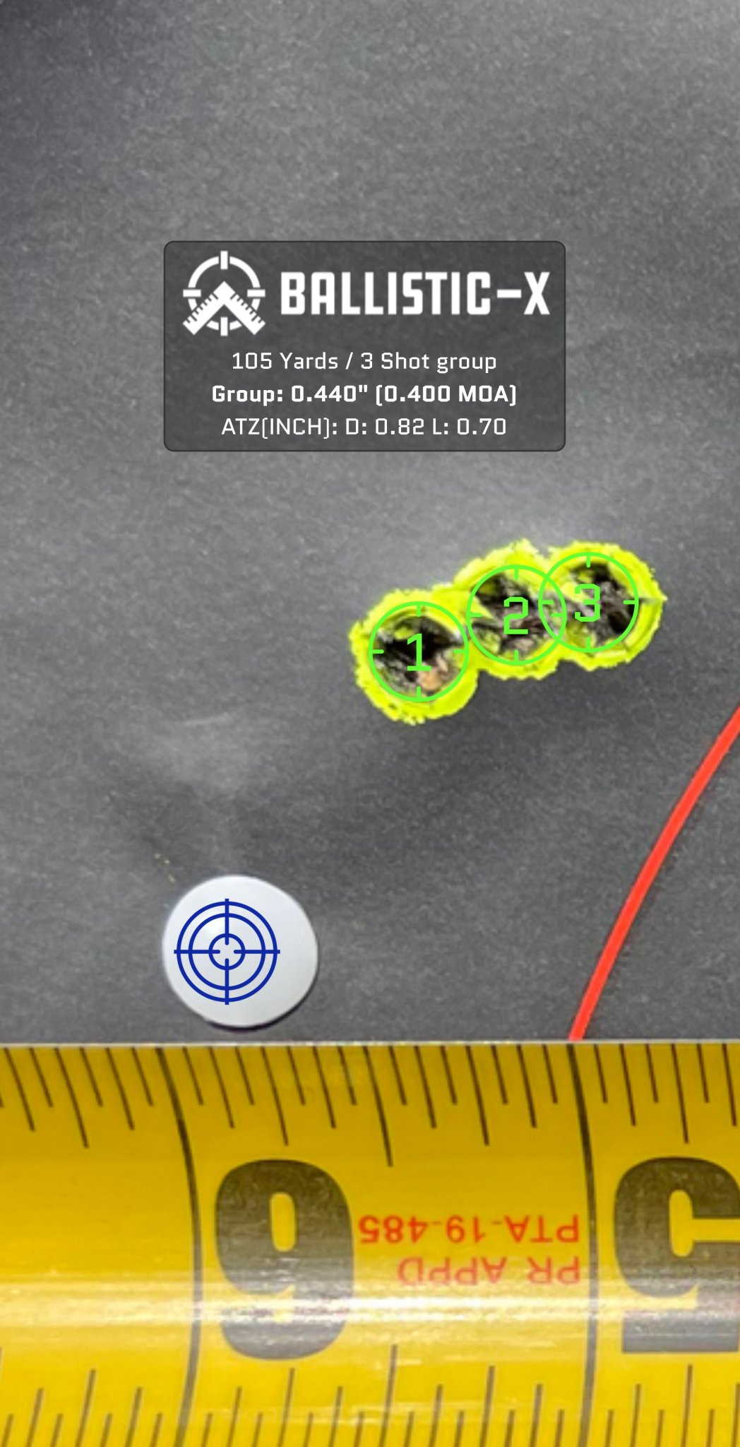

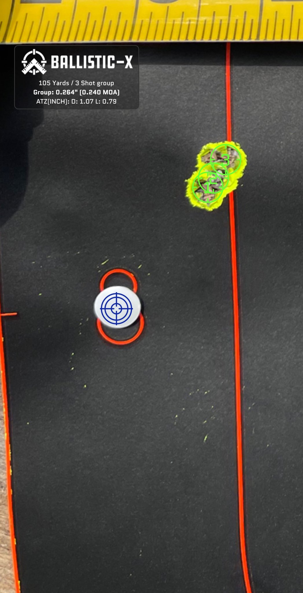

I was able to take the AX back out this morning and give it another go. Heeding the advice others have offer above, it was much better. I removed the brake, installer the thread protector and changed the bipod to an Altas Super Cal. The previous bipod was an accutac.
It seems to me at least, that this rifle really wants to be “drove” more so than the TL3. And the PSR allowed me to bear down on the rifle more simply due to the feet vs the Accutac. Has any one else noticed this? In regards to the effort put into the rifle. Maybe it’s just my shooting ability or lack there of with a heavier trigger on the AX vs the light trigger on the TL3?
I shot the same Hornady 140 ELD M factory loads used previously.
While not as tight as the TL3, it’s much better and I’m not going to gripe about it. If I average the three, three shot groups I get an average of 0.362 MOA. I’ll take it.
Thank you for all the suggestions offered above, they made a difference!
