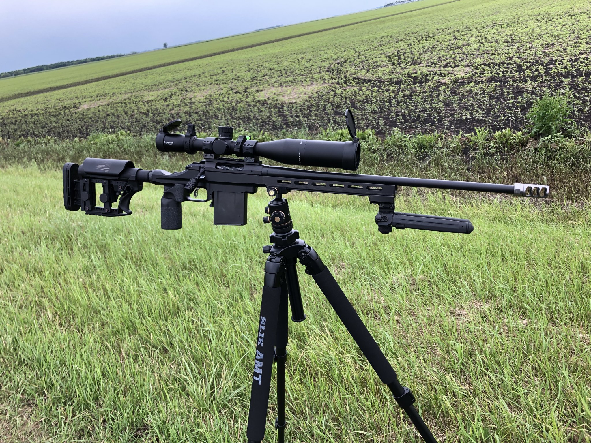

If you do want a Ruger American 223 to work in a new stock/chassis. I can not recommend highly enough the Indian Creek Design MoFo chassis. Using this chassis, and the “Ruger 90458” magazines I was lucky enough to find...my RAP 223 runs FLAWLESSLY in the ICD MoFo chassis and Indian Creek Design has the best customer service you’ll likely ever experience. If interested, talk to Gary with ICD. I can put you in contact via email if you’d like.
Attached is my RAP 223 in the MoFo chassis. It has a modular fore end system, and uses basically any AR15 hand grip or buttstock that can go on a buffer tube.
