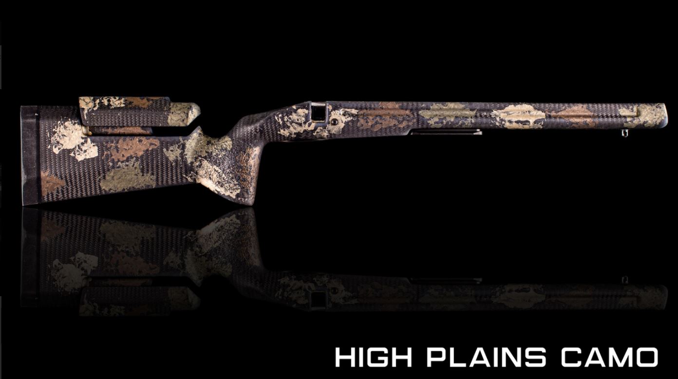

My LRH order was placed 5 days ago. I have the flush fit Hawkins bottom metal and magazine already here.
Mile High and Unknown Munitions were a few that had the hardware in stock. I went with the High Plains Camo. The image is from Altus.
