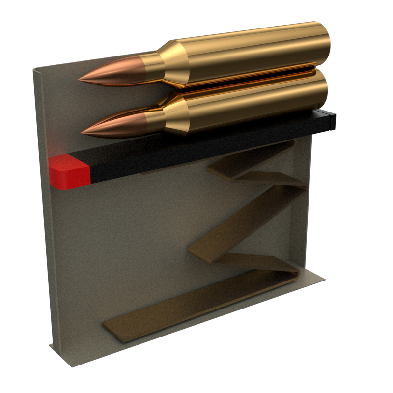

Thanks for the replies. My current mag does not have a binder plate, and I am not sure that the binder plate would be thick enough to ensure reliable feeding on a new mag that has one. I disassembled the mag and the follower spring is centered towards the back of the mag. I was thinking I could file away the front of the follower as shown (part to be filed in red) on the image below:

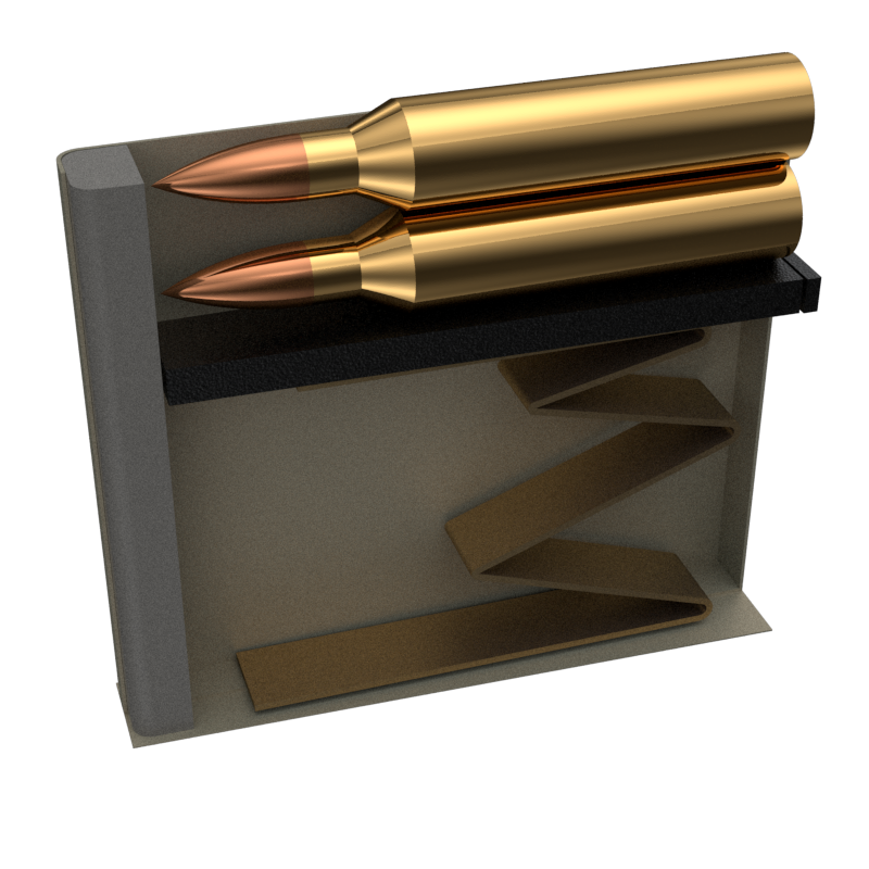

And then I could print up a spacer as shown below to prevent bullets in the magazine from sliding forward until they are at the top of the magazine. Can anyone see any problems with this approach?
A n unmodified Tikka long action will not function with an unmodified 3.715” AICS magazine.
MDT produces their LA Tikka chassis with a proprietary 3.560” AICS pattern magazine for this reason.
A spacer in the front would work in theory, but bullet noses dragging on a 3D print is a recipe for nose down jams, and you have to consider spring clearances as well.
I would either notch the feed ramp, or if you have the ability, solder strips on the interior of the magazine to keep the cartridges back at the shoulder.
