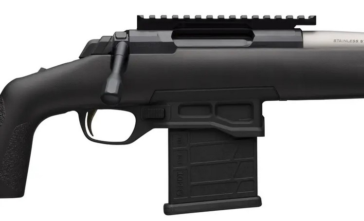

Who manufactured these mags? Are they genuine 5rd AI mags? I bought them for the Browning X-Bolt Target Max Competition Lite rifle and they will not latch in fully.
The Magpul 5rd AICS mags latch in place, but they are slightly too big and difficult to remove. I really hate to have to order the 5rd MDT mags.
I am actually beginning to hate this rifle and I haven't even sent a single round down range.
Well the bottom would indicate they were made by/for Accuracy International. The top looks like an AICS magazine for the 308 family of cartridges. It sounds to me like the magazine catch is too long. If you were to hold a loaded magazine up into the stock will it feed the catridges.
Reactions: Darryle
@ShtrRdy , no they will not feed, the magazine base is hitting on the bottom of the front of the factory bottom metal causing the bullet to be below the feed ramp of the rifle.
@Rob01 , I tried it both ways before figuring out that the magazine base is bottoming out on the front on the bottom metal.
In the meantime, I ordered a 3rd and a 5rd MDT magazine, I also ordered the MDT Hunting Bottom Metal for a build around the Aero Precision Solus action, so, if nothing else, I can use these there.
If the magazine is hitting the bottom metal before the magazine latch will catch then your only recourse is to use longer magazines like 10 rounders. It's either that or change the bottom metal to a version that will allow the 5 rounder magazine to engage the catch when inserted.
Reactions: Darryle
Ah ok. I thought it was a latch problem but if it's hitting the front of the actual bottom metal then longer mags are probably the only fix if you don't want to go at the bottom metal with a file. That bottom metal does seem excessively long.

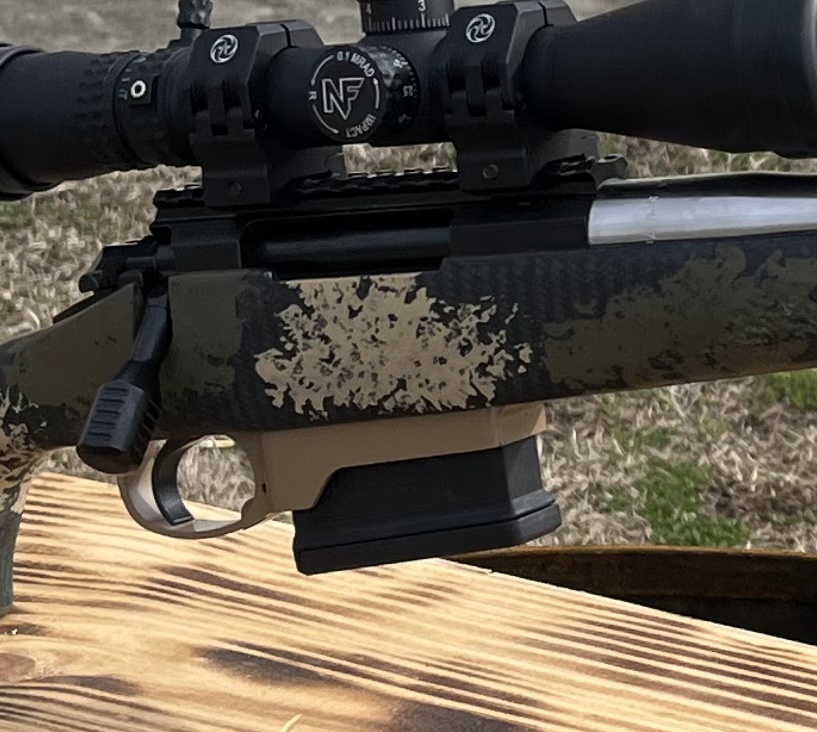

Reactions: Darryle

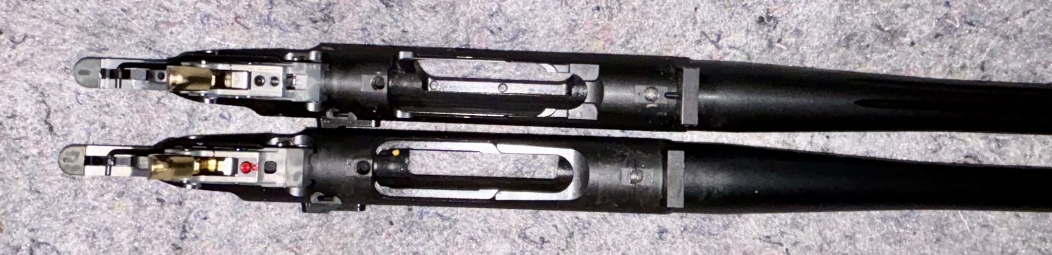

I would love to use the original style X-Bolt magazine for hunting, but they machined the action specifically to feed from AICS magazines and the rotary magazine sits too deep. I am hoping that the 3rd flush MDT magazine will work, if not, it's going to be the 5rd Magpul and just deal with fighting to get them out of the bottom metal.
Since Browning refuses to sell this bottom metal separately, it's am hesitant to modify it just yet.
Hunting action compared to the Target action, 6.5 Creedmoor target up top, standard 6.5 Creedmoor sporter below
Reactions: ShtrRdy
