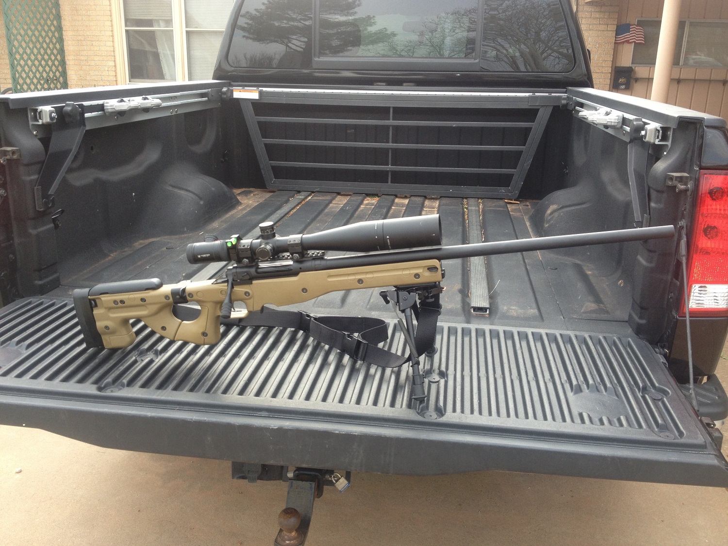

    I suspect that you wont be disappointed. Here is mine:
    It's a SS Varmint action from NSS (with the usual precision lug and barrel nut) chambered in .260 Match.
    I'm confident that you wont be disappointed. Here is mine:
    I hope it'll shoot as good as it looks.
