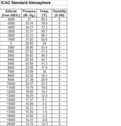

    The offset for Denver is 24.89 as I looked it up specifically so I can include it... this is due to the temperature offset for elevation.
    sorry, I wasn't disputing your numbers. I was just making a reference to the generally accepted lapse rates. The ones I used are quick reference for ballpark, not exact. they don't take into account the exact temp lapse rate as the chart above does, but you will notice the difference in 24.89 and 24.92 about as much as not accounting for Spin Drift (I'm messing with ya).
