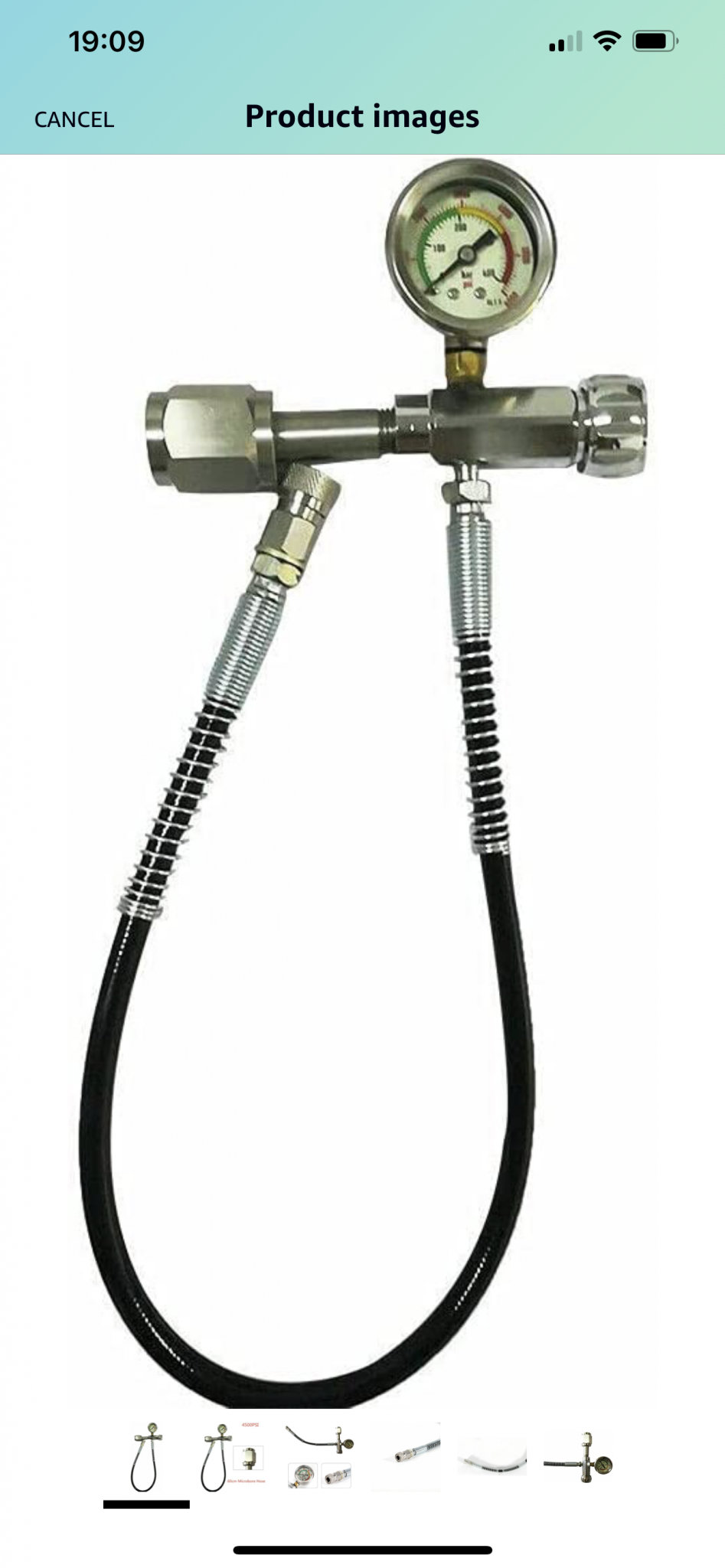

    Anyone know of a reliable fill valve? 4500 bottle
    This is what I’m looking for. But reliable
