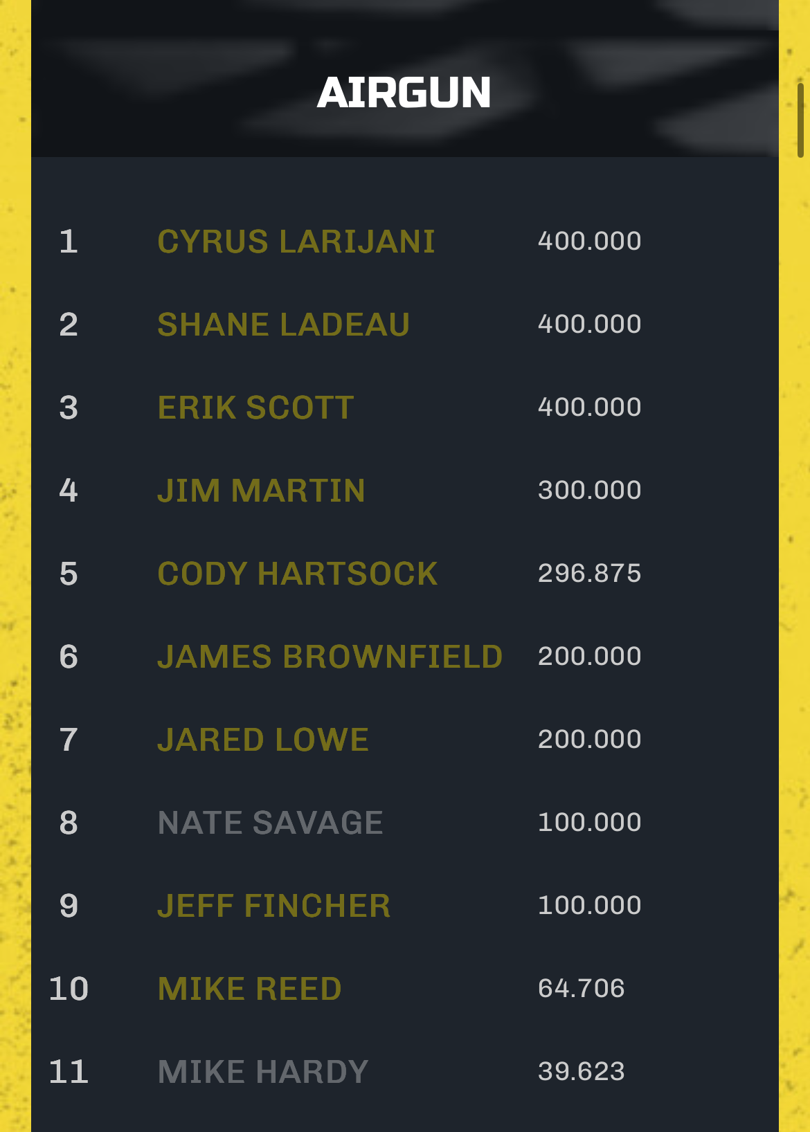

It looks like 11 PRS airgun competitors total in the U.S. Not more than one in any single state.

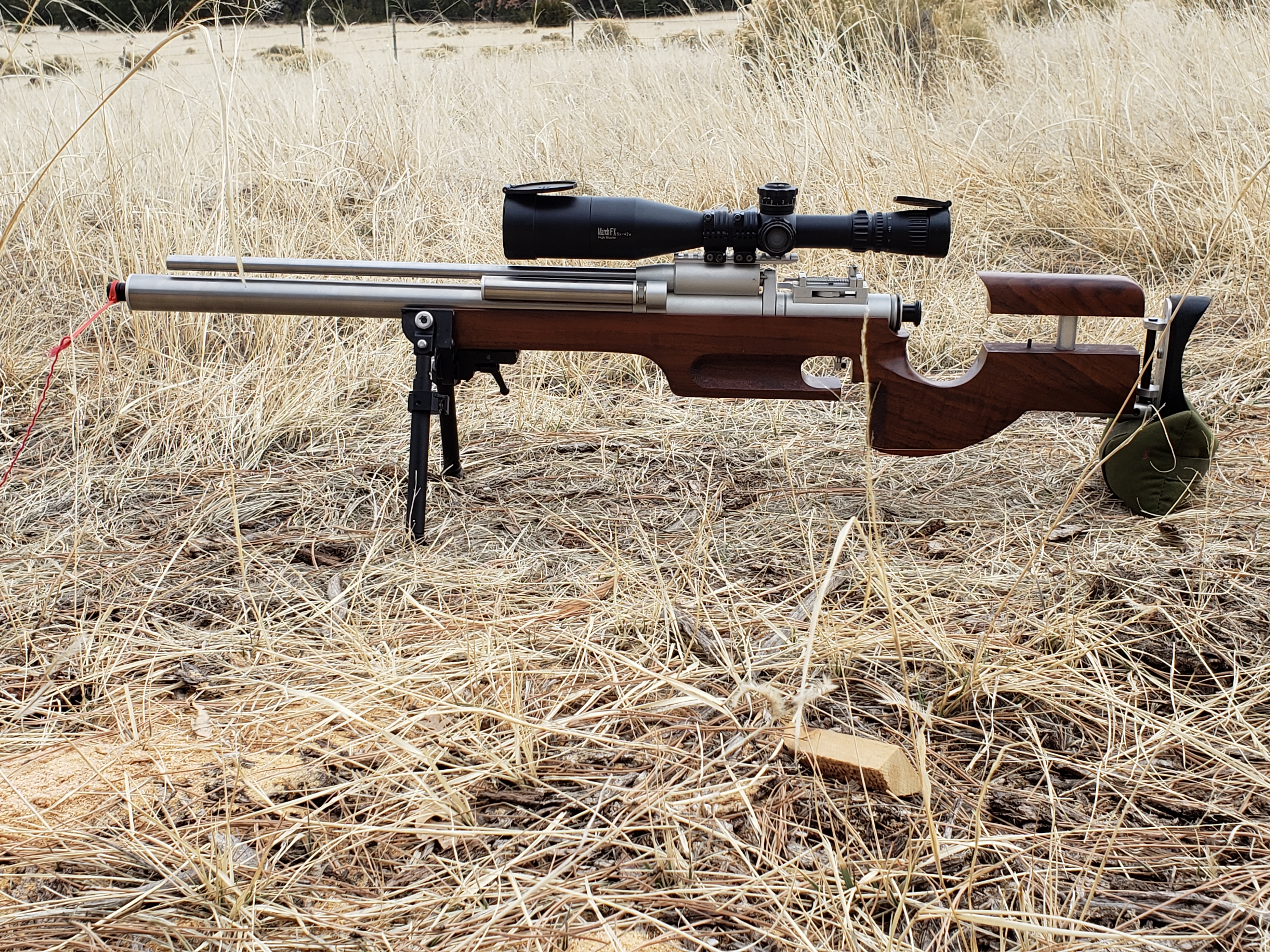

What is this particular rifle, please?
It's my 4 year old Thomas HPX custom and set up for 65-ish fpe.

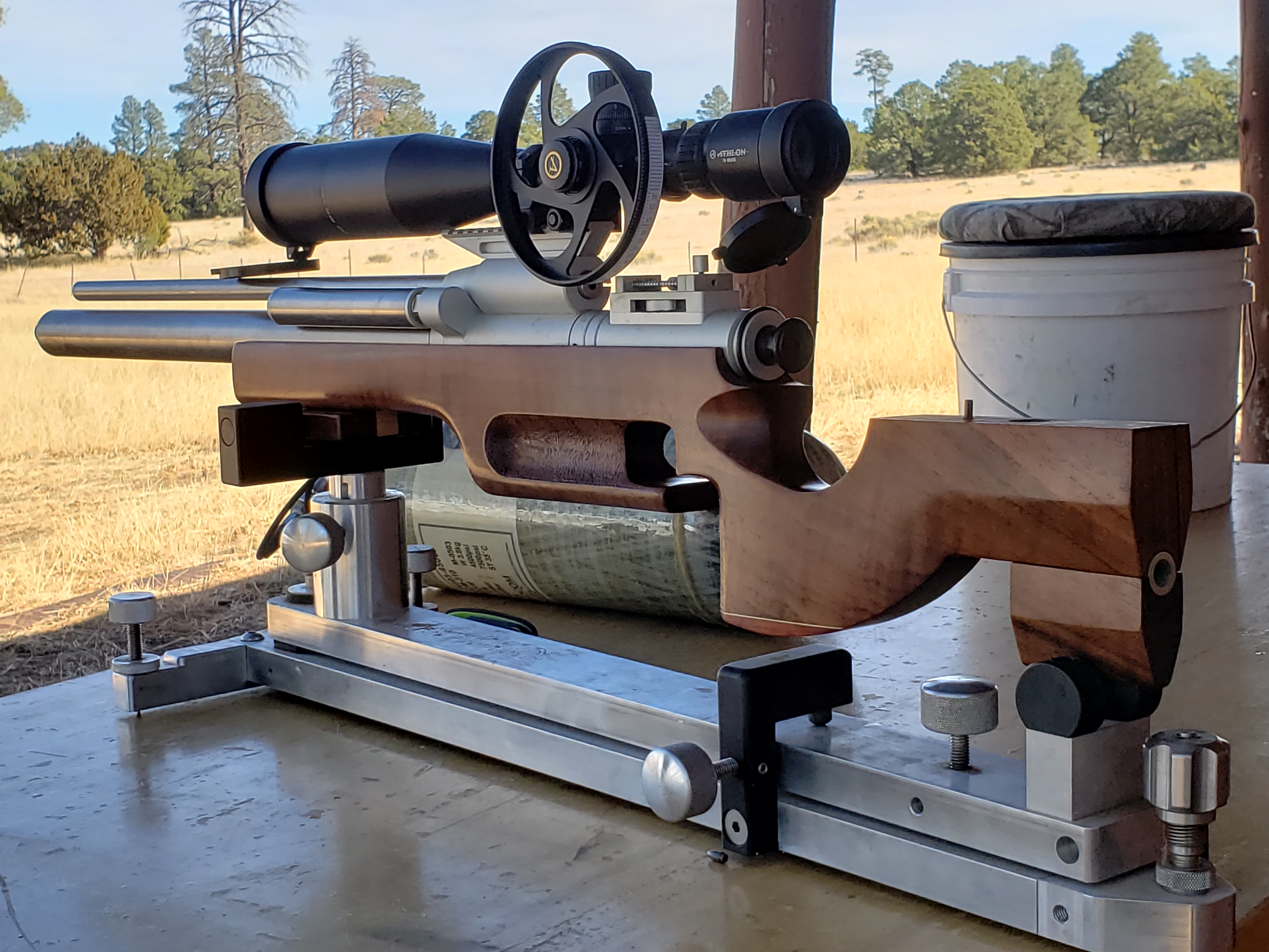

This is when it's in it's benchrest configuration.
This in it's normally used configuration, aka
bipod and rear bag, but I don't shoot it prone much anymore.

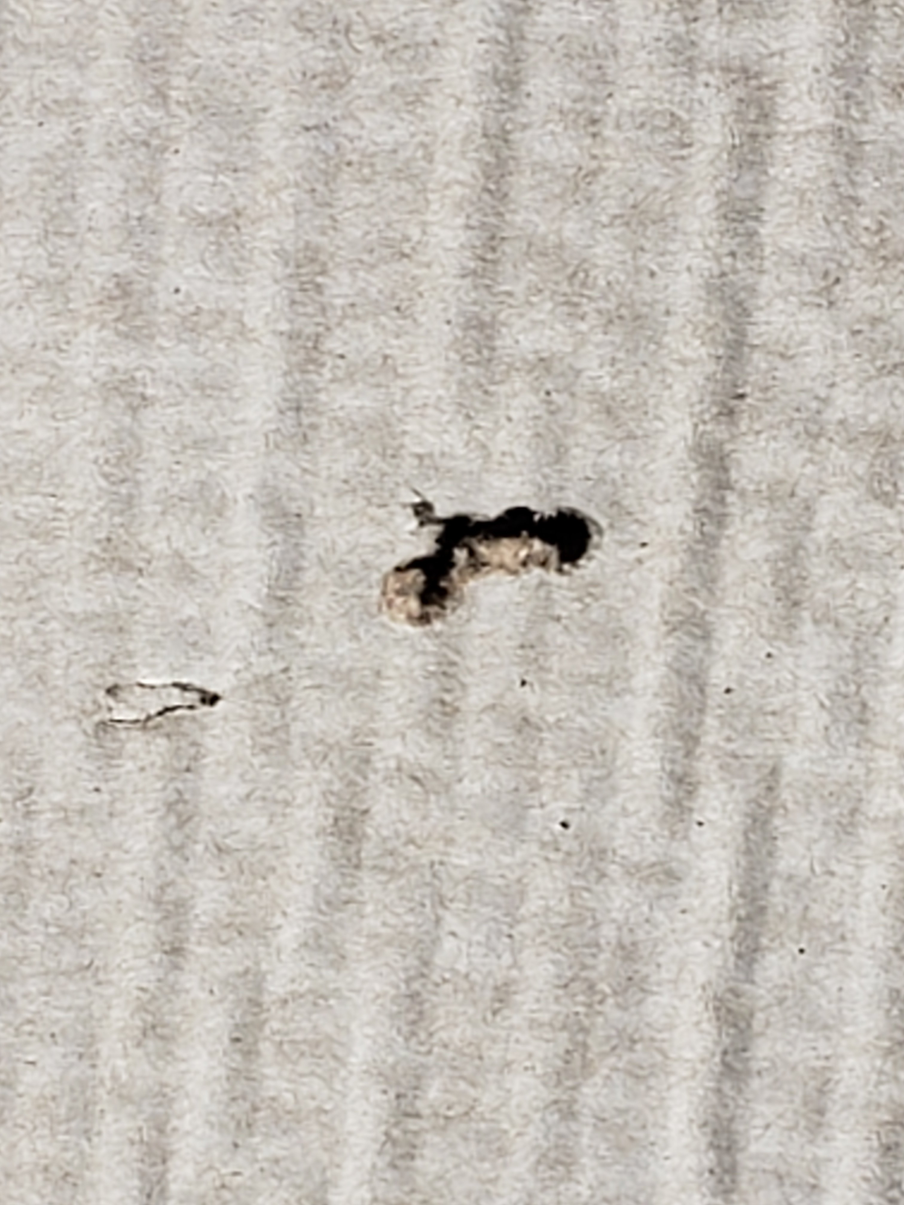

A 87Y group and that 100Y group with it.
One time I hit our 100Y 1" spinner 9 times in a row before I missed but I'd fallen off the reg or I might of done more.
This in it's normally used configuration, aka View attachment 8749103bipod and rear bag, but I don't shoot it prone much anymore.
One time I hit out 100Y 1" spinner 9 times in a row before I missed but I'd fallen off the reg or I might of done more.

That is a pretty stock, in a very utilitarian modern style.
And the groups don’t suck either. 👍🏻
Thanks Lash.
I let the woodsmith have free rein on the stock so it's all his design. A hybrid design to be used in different ways. I'd done things a little differently but to be fair the communication between us wasn't the best and I'm to blame for my part in this. Plus this was his first attempt at such and the poor guy was battling cancer.

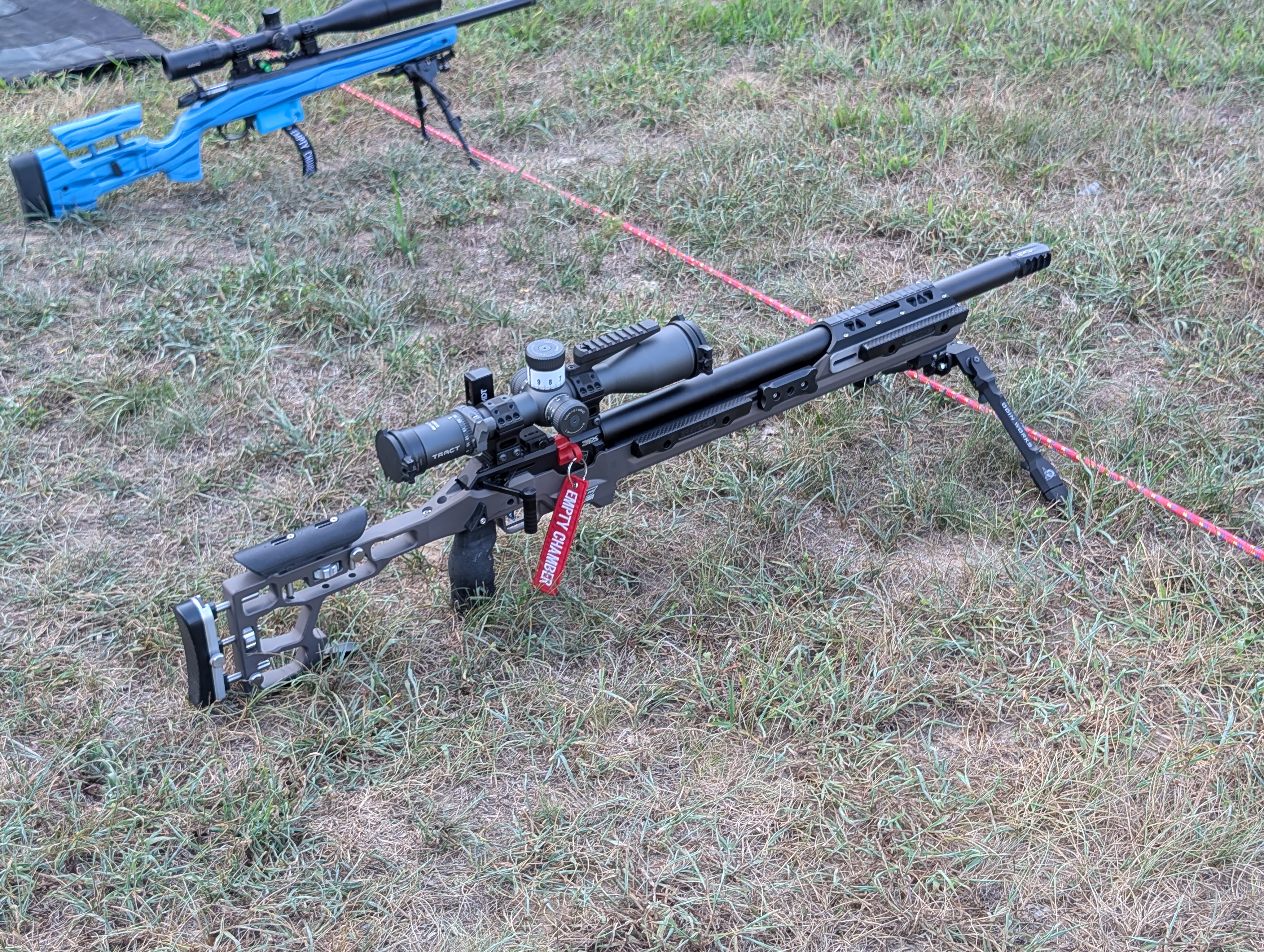

What muzzle brake are you using? And were you able to get the safety to work in that chassis? Thanks.
Looks like an APS muzzle brake. They are a South African company. Getting one is a fair pain, but they are great.
APW Raptor brake (Axis Precision Worx). It's a SA company as woogie_man said. I bought from Impact ProShop.
I was not able to get the safety to work. I got the King safety kit to try to convert it, but there are some subtle differences in the blocks that made it impossible. I'm not sure if that's because I have an early Panthera block, or it will just never work with any Panthera block? But if I were to put together the rifle now, I'd start with a King block that's meant for chassis systems.
