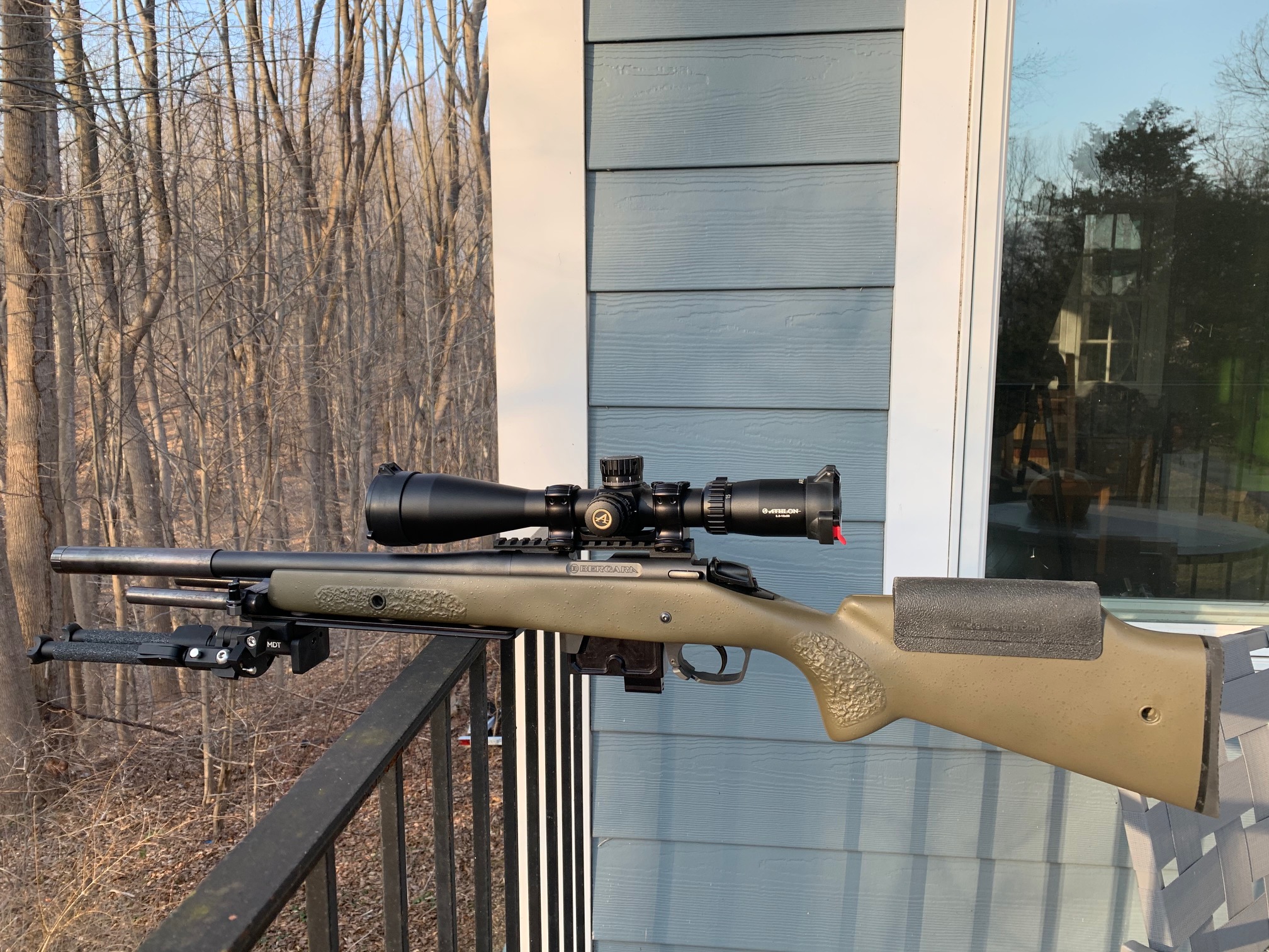

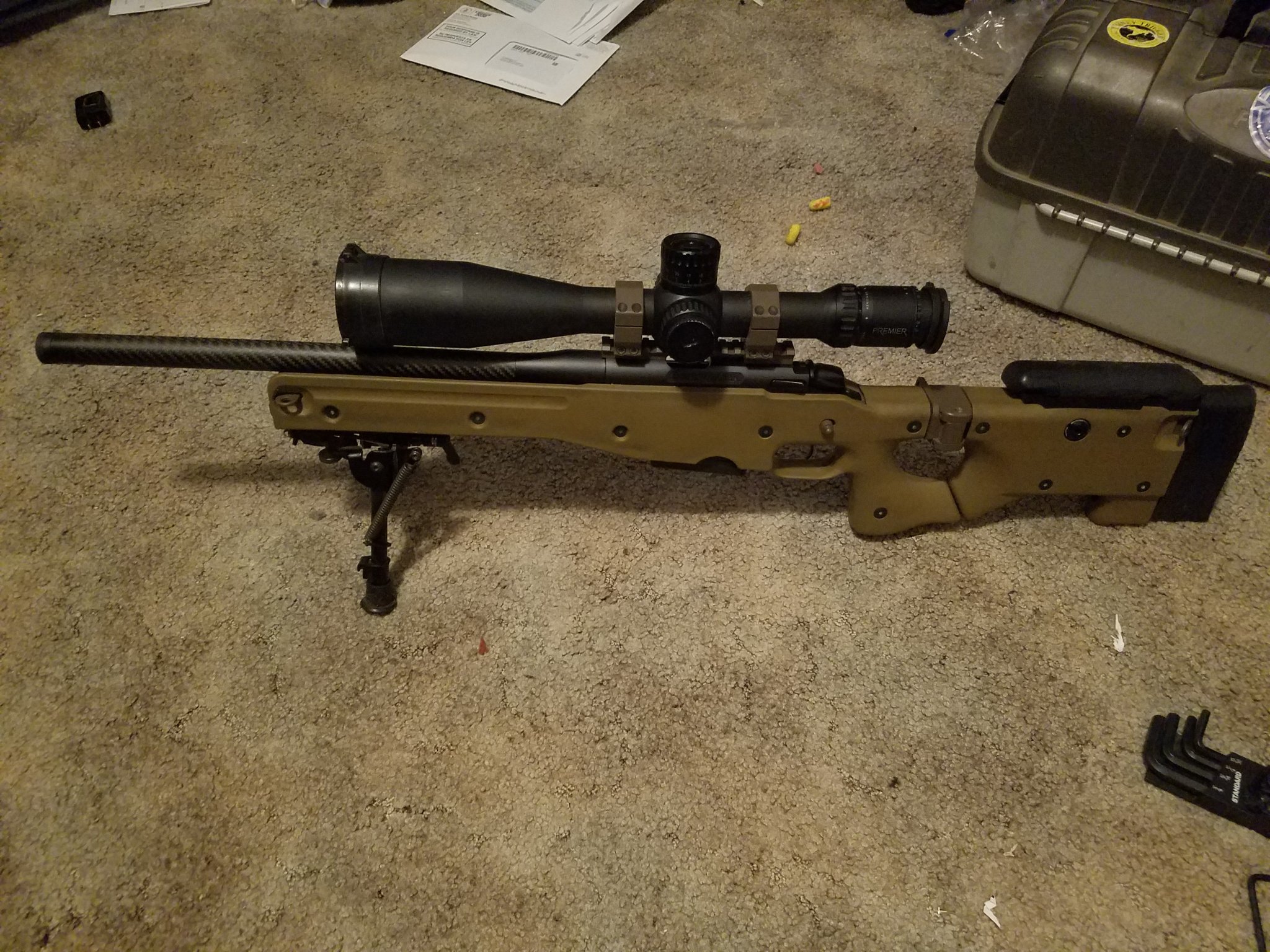

I did something like this....
I just put it in a AICS.....

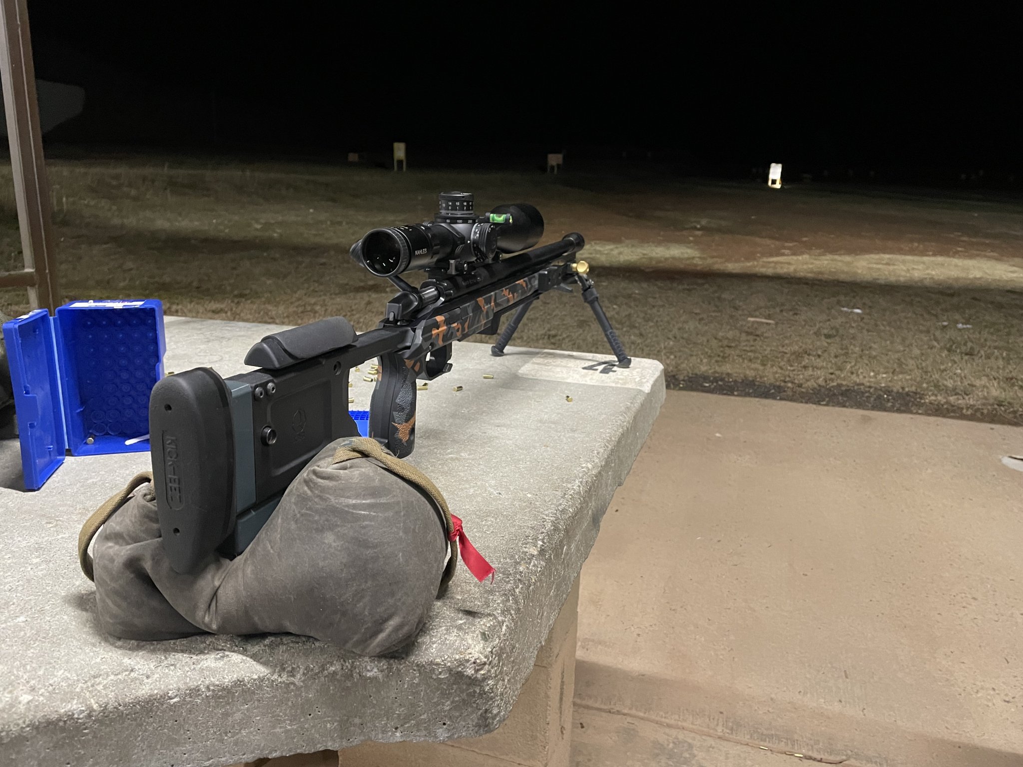

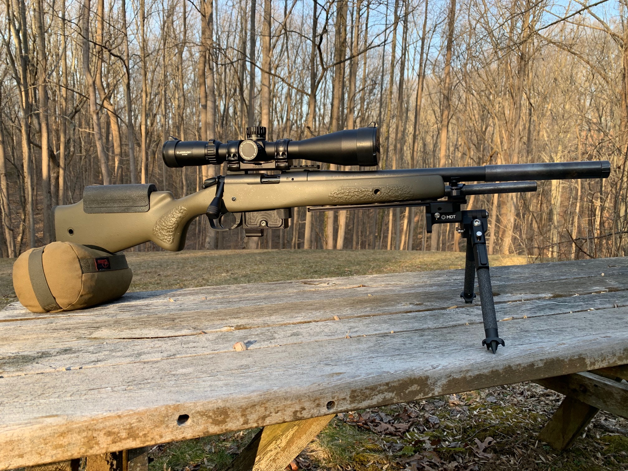

Manners EH4 with mini chassis is scaled about perfect for the B14R IMO.
A well assembled B14R will shoot with anything once you find the ammo it prefers.
SK LR match

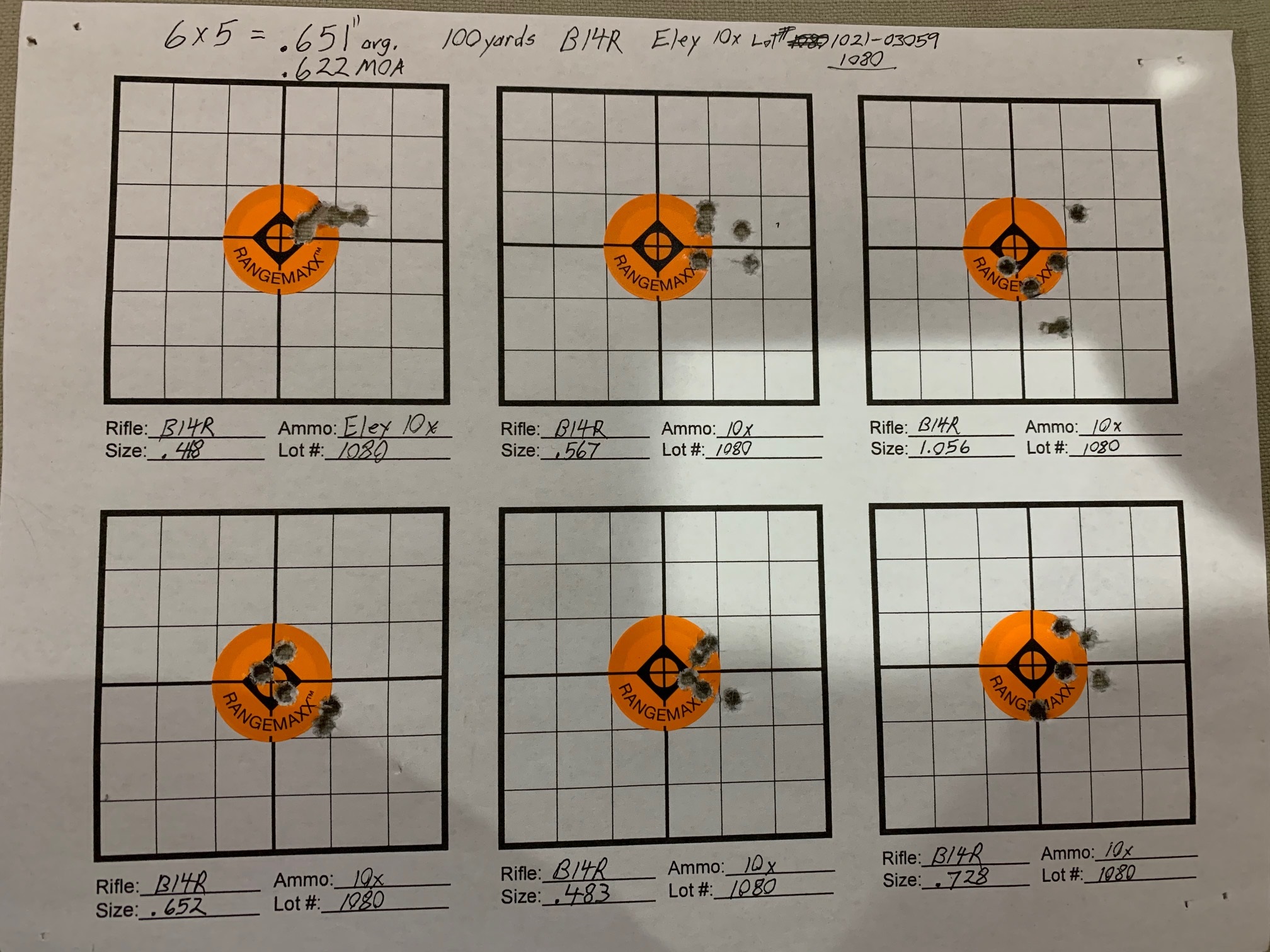

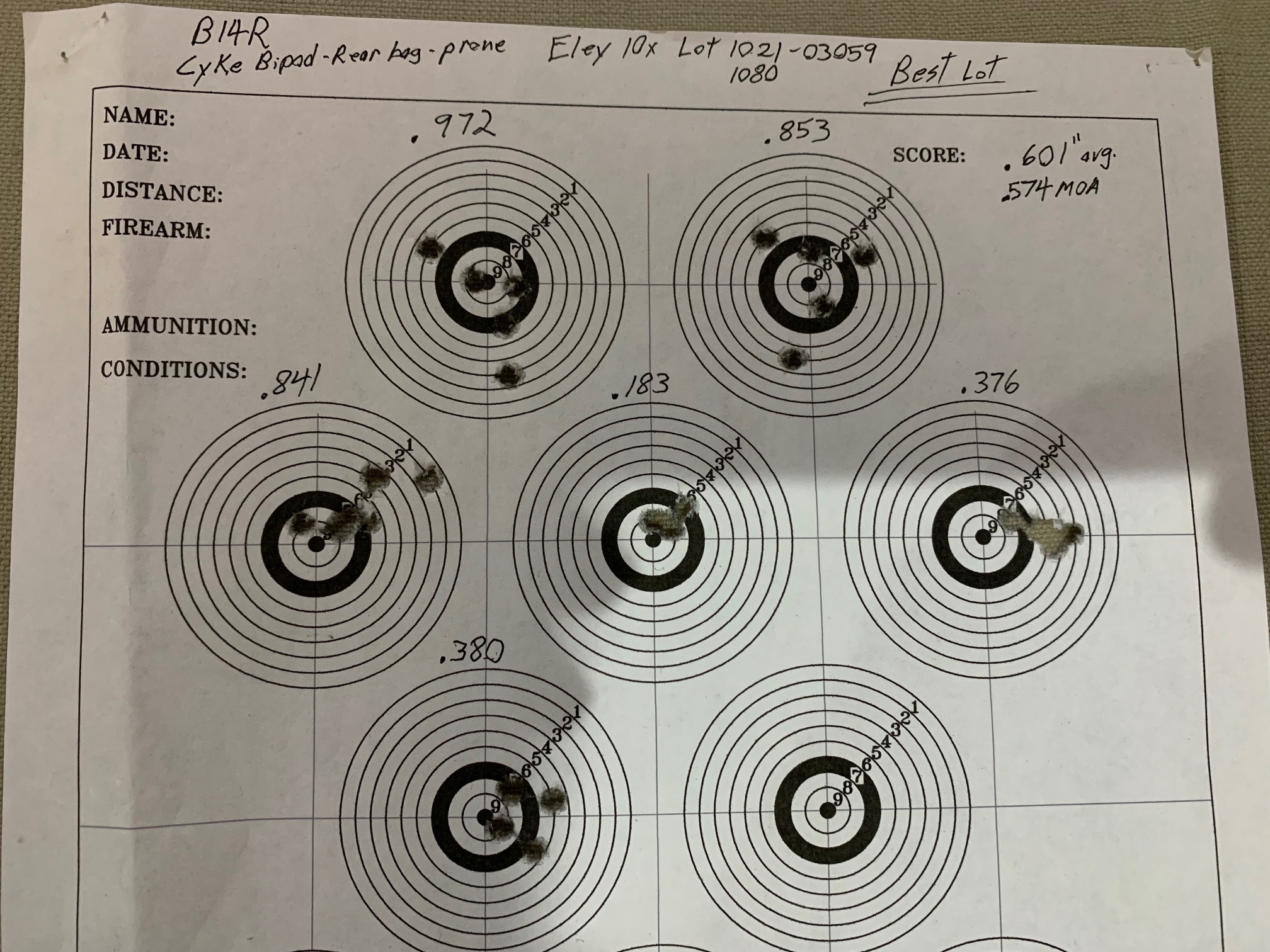

Eley 10X fast lots. 100 yard 6 x 5 groups below with my home made tuner/dampener surprised me. This thing is just fun as hell to shoot & I've since added a Razor LHT & a form 1 suppressor.

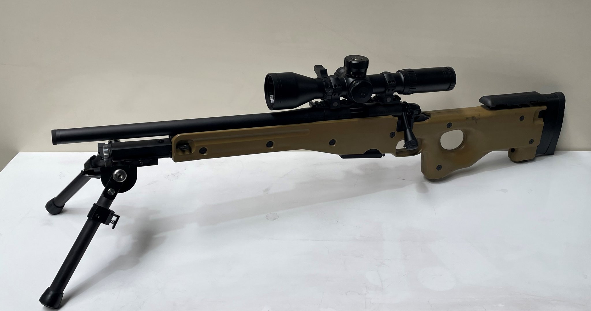

The airsoft AICS stocks are junk, you could get away with a 22 that has the magwell attached to the action like a CZ but they're still junk. I've had my Bergara in an AICS, it's cool but a little bum heavy.
