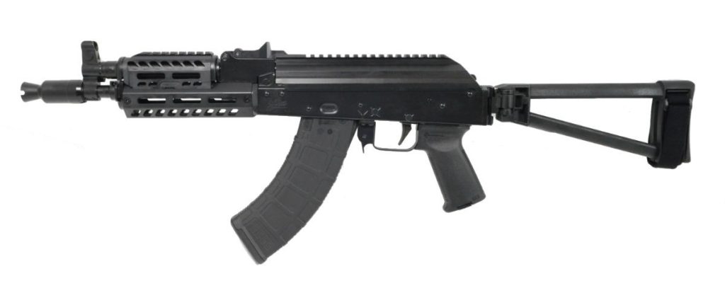

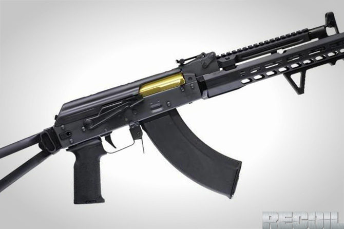

    The idea is to get something like this:
    (I do not want the gold bolt carrier)
    (I do want the railed dust cover that the PSA AK P has)
