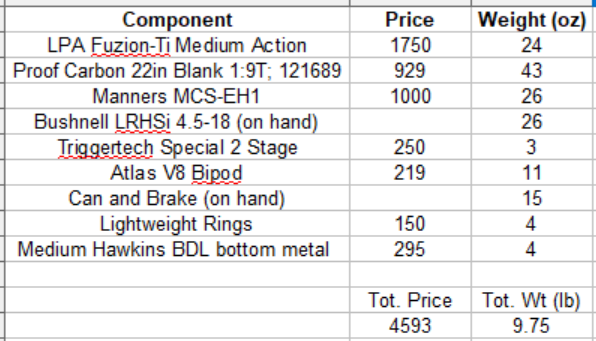

Any reports of experience with Nielson Custom Rifles? Finally to the point where I'm in a spot where I can start making plans for some hunting trips. I'm in WI and a seasoned whitetail hunter, and want to plan an elk hunt in 3 years then an Alaskan moose hunt in 5 years. Looking to get a gun built for these hunts since I don't have anything in the safe that is light enough with enough ass to make the shot count. I know, I know, shot placement blablabla, get stronger blablabla, but I can do all that and still want a lighter and better shooting rifle. The Proof Glacier Ti is prob what I want but can I save $3-4k and spend that on training and practice ammo?? I priced out parts for my ultimate dream build to do myself but then there's the lack of accuracy guarantee, time, tools, and doubt, plus the fact I've been a factory guy to this point. So with the time frame I'm thinking the custom or semi custom build is the way to go for me. I'd like to be sub 7lb rifle only, adding the fact that I have a LRHSi and Omega can which will being me up to around 10lb. I'm thinking some pro help might shave a few ounces and even more dollars. Where do I go from here? Who can build me what I want? How can I shave weight and money? Am I even thinking right here? Never been to AK, never been out west to hunt, looking for some help from the super deep knowledge base. Nielson may fit the bill? I have a Tikka CTR in .260 that is superb and I know exactly where my bullet will land at any range out to 500yd. Nielson will build off a Tikka action but how mush will a Lone Peak Ti action save me in weight compared to a Tikka action? Is it worth the dough? thinking 300WSM for chambering, I got time to source ammo and/or components. I reload as well. Want something that I can shoot 20-30 rounds at a range outing without turning my upper body into meat jello so I can get good practice in. Go easy fellas, I'm new to the out west stuff and genuinely looking for some real help.

I reminded of... hmm... Mark Twight? To paraphrase: 9.75 lbs of the most expensive, light weight shit you can get is still 9.75 lbs. You're buying down risk at the cost of weight in some cases (bipod, suppressor). That being said, I don't consider 10 lbs to be excessive - most women seem more than capable of carrying this weight near continuously for example, we just call it a newborn instead of a rifle. ;-)

your build looks really good. the weight will be far less of an issue than you think. I carried my 338 rum on my elk hunt in montana. gets you the horsepower you want, just weighs a little more. My rifle was 12.5lbs all in and rocks shit. as far as alaska, ss or ti, high quality carbon or fiberglass stock, maybe a nightforce 4-16. the weather can be worse than anything you've ever hunted in, for the entirety of the hunt. you don't want any part of your gear to let you down in those conditions. Like, i made a point of loading all my hunting ammo in nickel plated cases in AK to avoid another fail point, brass cases in a wet barrel for days at a time.

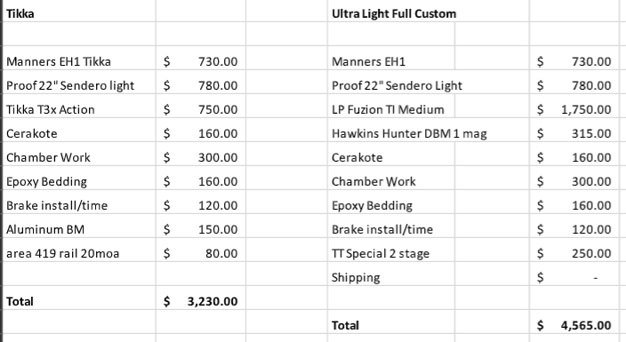

So I think I sorta hafta throw this guy my dough... the full custom build with the LP Fuzion Ti he quoted for less than I can buy all the parts. The build off a Tikka action saves $1300 and cost only 8oz so I think I have to go that way. Oh and the custom parts build doesn't count the 12 or so places that I would need to pay shipping to, plus all the tools, plus all the time. Almost seems too good to be true. From him:
So, if you're trying to save, use a ss tikka, and bypass the ceracoat. Sure it looks good on the internet, but won't really be necessary then. Also, look into a self timing brake. That's something you'll be able to take on and off easier as necessary, and could save a few more bucks. Amd the bedding isn't totally necessary either with a high quality stock. It's all down to how much you really want to save

Ended up changing my mind. No one heard of Nielson, no reviews, small volume = too big a risk for me, would rather pay a little more for someone with a reputation. Contacted Travis at TS Customs that has history, plus a friend in South Dakota vouches for him. Had a real nice phone conversation with Travis and he quoted $5800 for the lone peak option listed above plus the same other stuff, except Benchmark barrel and their KS1 stock which looks solid.
I grew up a poor and can easily afford this. But, damn, that's a lot of dough. What if I hate it? ALL of the production rifles I have to make a concession on something. I do not want to go that way. I want this to be the perfect solution. Tikka barrel twist is to long. Seekins Element is not available (although the reports of customer service are superb), Christenson has spotty quality, Browning et al is meh on reviews and accuracy and not sold on modularity, will NOT buy another Savage (had one that worked but the action I thought was complete trash), Fierce has quality issues from many reviews. Suppose I just have to suck it up and cough up the lettuce.
i'll second this, if you're counting the cons on any factory option, don't waste any time with one. Start shopping custom guns. you've already looked at TS customs. see if GA precision, Southern Precision Rifles, Alamo Precision or any other big name builder has what you're looking for. They all use top of the line components and stand behind their gear. Or, build it yourself. So many of the modern custom actions offer prefit barrels and are of the 700 action foot print. A friend recently built a Terminus Kratos LA 300PRC with parts he bought online. Action, Proof barrel, triggertech trigger, manners stock. All purchased online and spun together in his basement. The rifle shoots as if it was produced by a custom smith but was built with readily available bolt together parts.

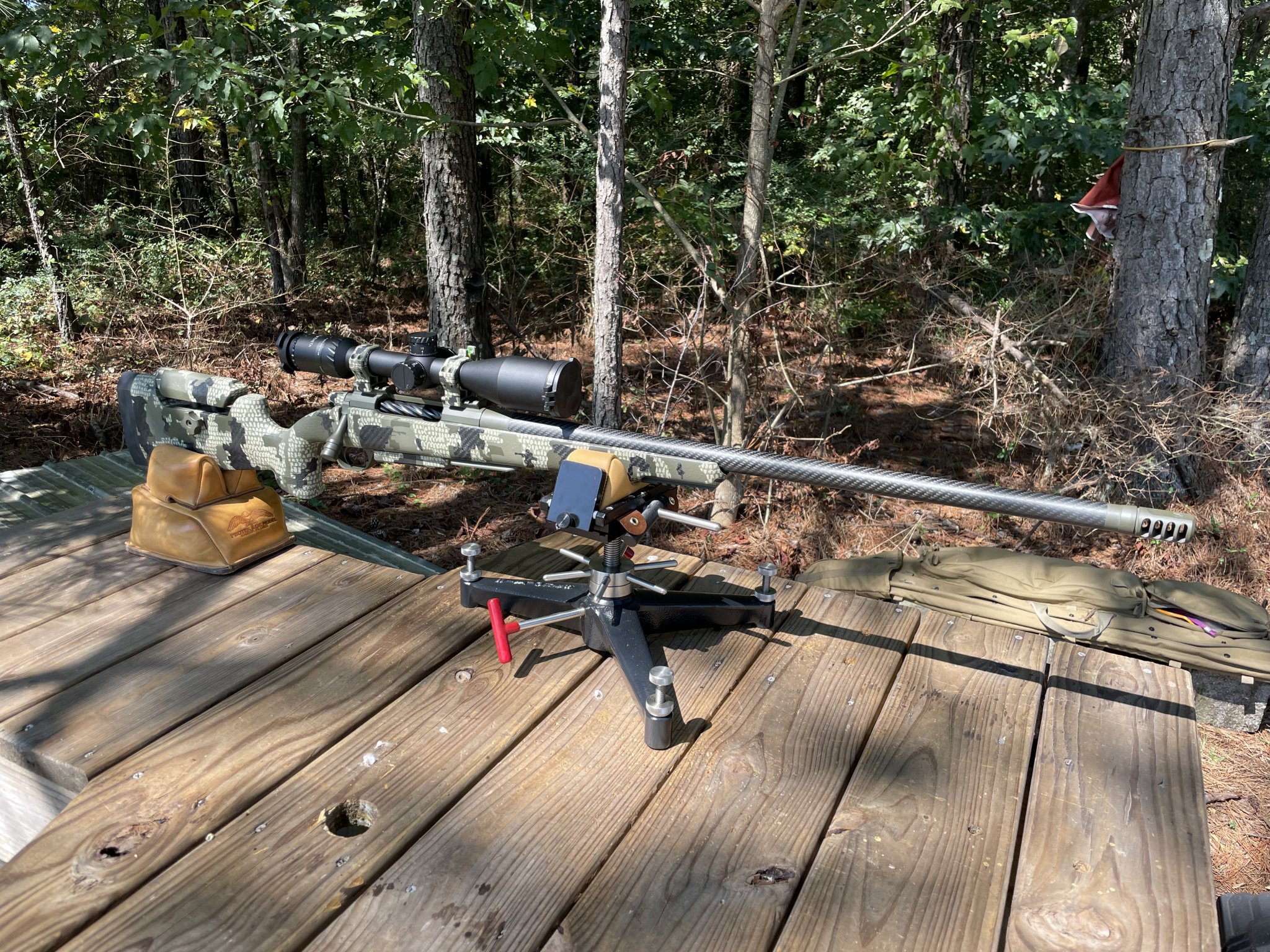

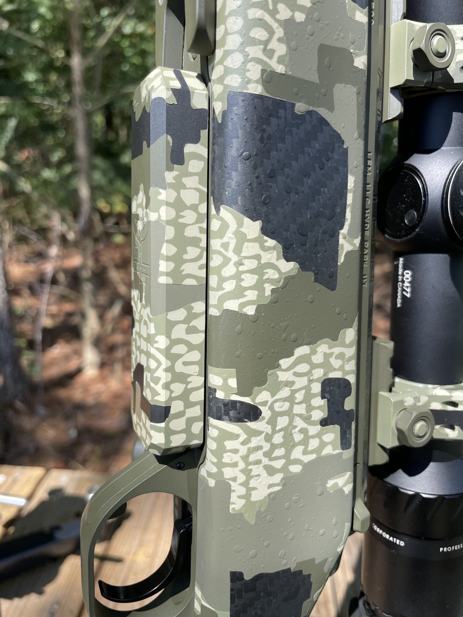

That’s awesome! Great looking rifle.
