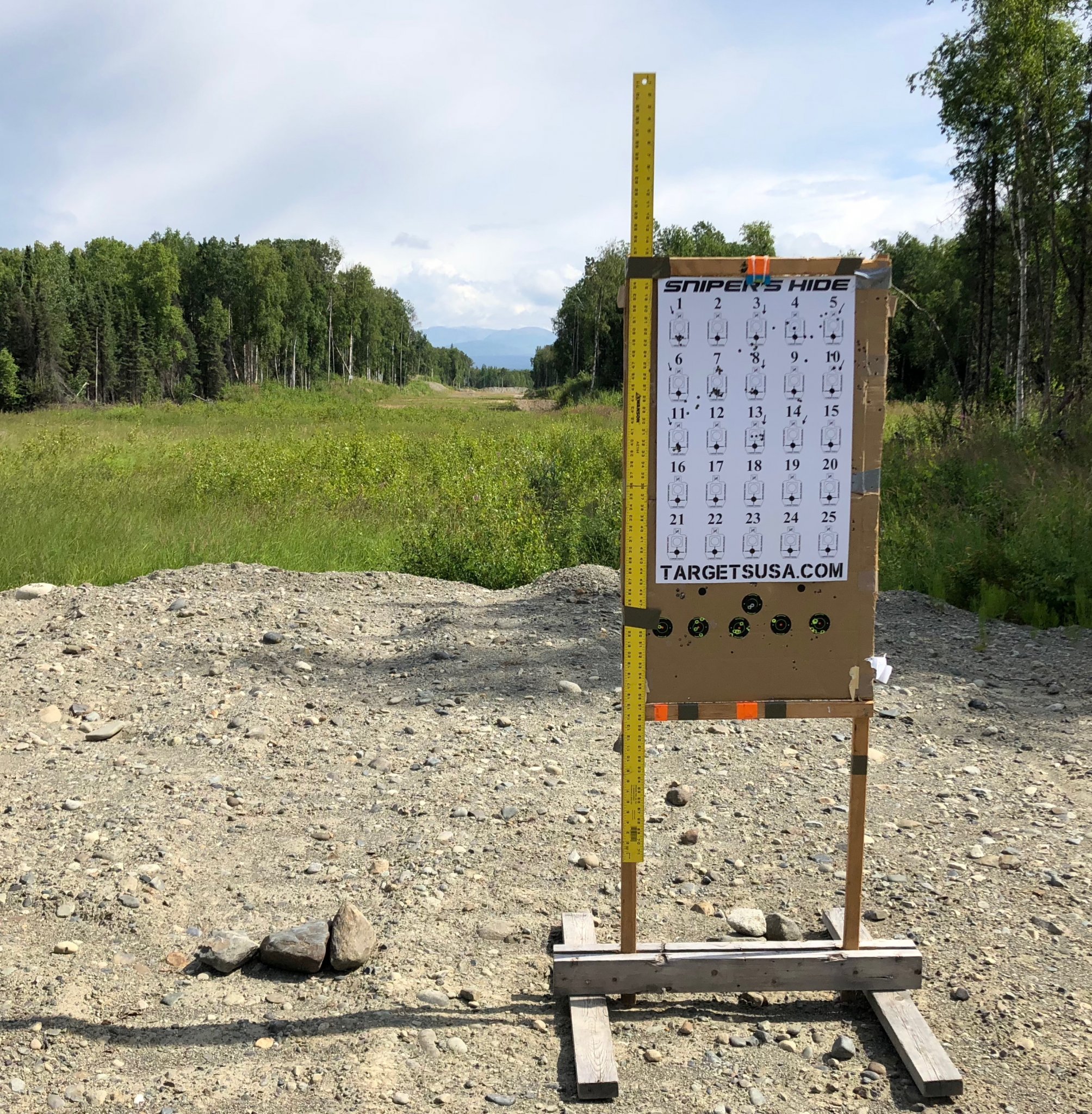

    During our Alaska Precision Rifle 2 course, we remove all the scopes from the class and do a tall target test.
    We started recording all sorts of data in our course manual book, so that means data is being compiled for every AK class we hold.
    Before you start digging into the Data, understand the two NF scopes that were not recorded as 100% were both MOA scopes that both recorded a value of .2499 or .25" at 100 yards.
    We measure to the foot from the top of the scope and we have a shooter downrange lining up the value alongside the reticle. So we try to be as accurate as physically possible.
    This data was double-checked by not only us but the owners in most cases.

    Here I was complaining about MOA and the only two NF scopes to show an error were both MOA models which tracked .25 vs .262
    This is the same thing we saw with several Leupolds and yet they said we were wrong. In this case we did not have any Leupold's in the class, but last month we tested 4 Parks Dept Mk 4 Scopes and only 1 tracked correctly, the worst case we saw 89% of actual.
    MOA is an issue, you can debate it, but the facts don't lie

    Sounds like nothing wrong with those nightforce scopes except they are labeled wrong. I think Frank's point with the MOA thing is it's become generic. MOA, Shooters MOA not the same. If those were labeled SMOA then they are 100%.

    Stop being a fucking asshole, we did it on the line in real-time,
    I am clearly rounding some numbers and pulling shit from memory, we had an ENTIRE FUCKING CLASS Of 17 Students standing there while we ran the numbers
    We do it all in real time, one scope at a time so stop being a fucking TROLL and understand we used a Scope Tool, 36 Inch ruler with a person watching the scope and then another downrange with a pen confirming at the target (ruler) and then running the numbers

    3/4 were 100% and 1/4 was 99%. That’s definitely a good showing for this sample. The only time its not a “good showing” is if it’s outside of the manufacturer’s spec and allowable error.
    I’m not an Athlon fan, but this batch looks good.
