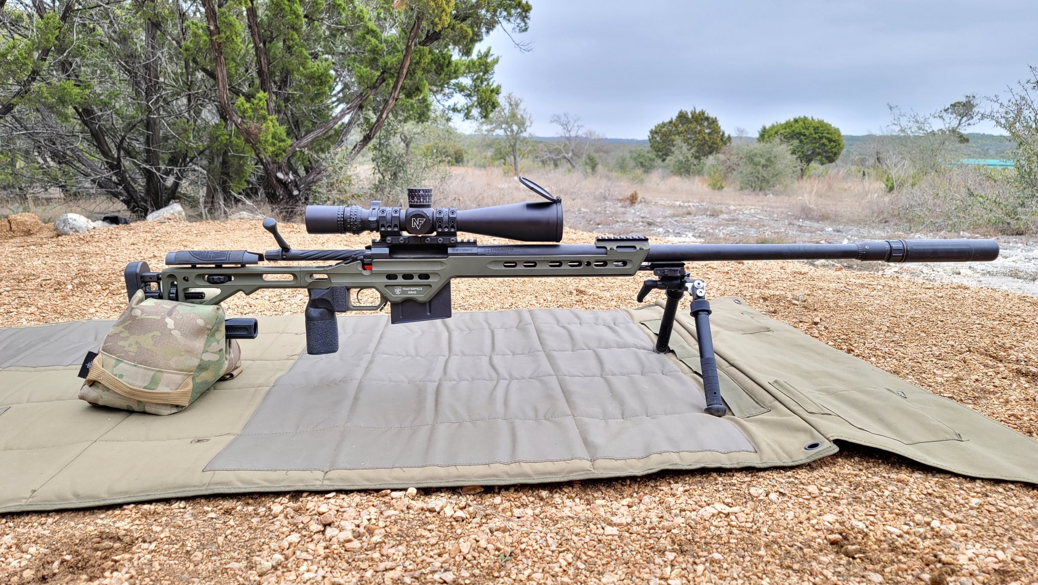

The 7saum definitely is going through a resurgence! This one is an ultralight built off the anTi-- should finish around 7.25lbs (with scope)
