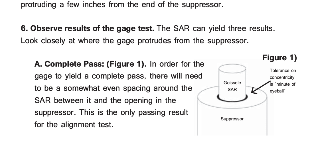

I have Geissele's but McMaster=Carr has some close-tolerance rods that you can pick to the thousandth in diameters; I have used them for some suppressed .22, and as Geiselle advises on his rods, you just need "minute of eyeball" accuracy.
