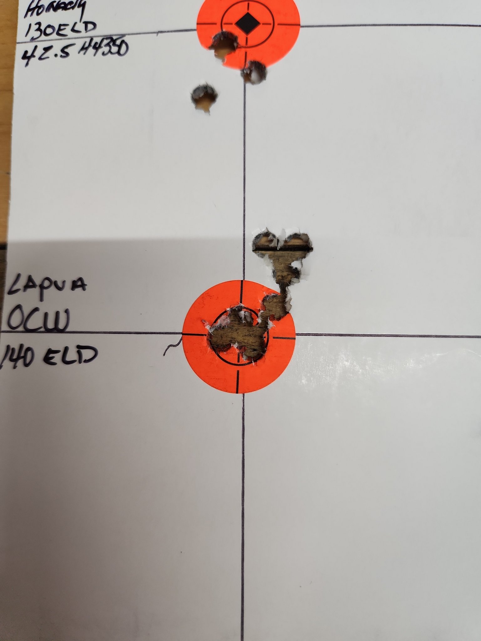

Got out and got a few more rounds down the pipe of my Daughters 6.5 Creed for deer season. (Bighorn, Proof carbon in a Masterpiece arms Chassis)
She shot steel out to 440 with the 130 load i tossed together. (It shot .4's Friday, loaded more with once fired brass from a buddies Tikka and the groups weren't as good. Maybe from having the Trigger cam installed? Anyway the 140 load started high at the lowest charge and really settled into the dot the last 4 charge weights. I'm thinking 42.1 looks like a great spot.

I don't, but this was just a very quick let's see what this looks like test.
Both 130's and 140's both shot .5's or better at the exact same velocity.. I will confirm more later. Just needed something to get my daughter out deer hunting with this weekend.
