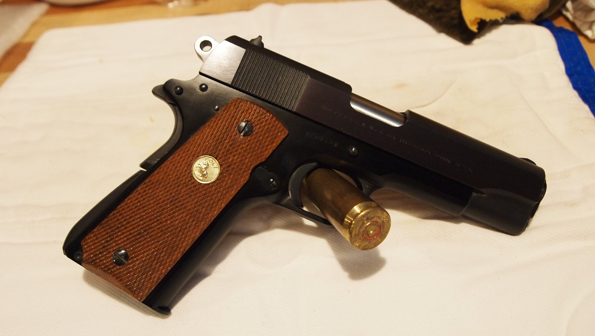

Found this 1968 LW in great shape at my local gun store.
Great piece but I tend to carry my steel Commander more often.
I have to do some work on the ejector on this one - it tends to eject right to my forehead.
Colonel Cooper had a maxim that is sound but I dont really adhere to it.
He thought if you were going to get a 4.25 inch 1911 you should go with the LW frame as the difference in weight between a steel Commander and Government 1911 really offered no advantage.
My advantage of the two isnt really concerned with the weight....more so its ability to conceal.
As a I tell the ladies fractions of an inch can mean a lot.

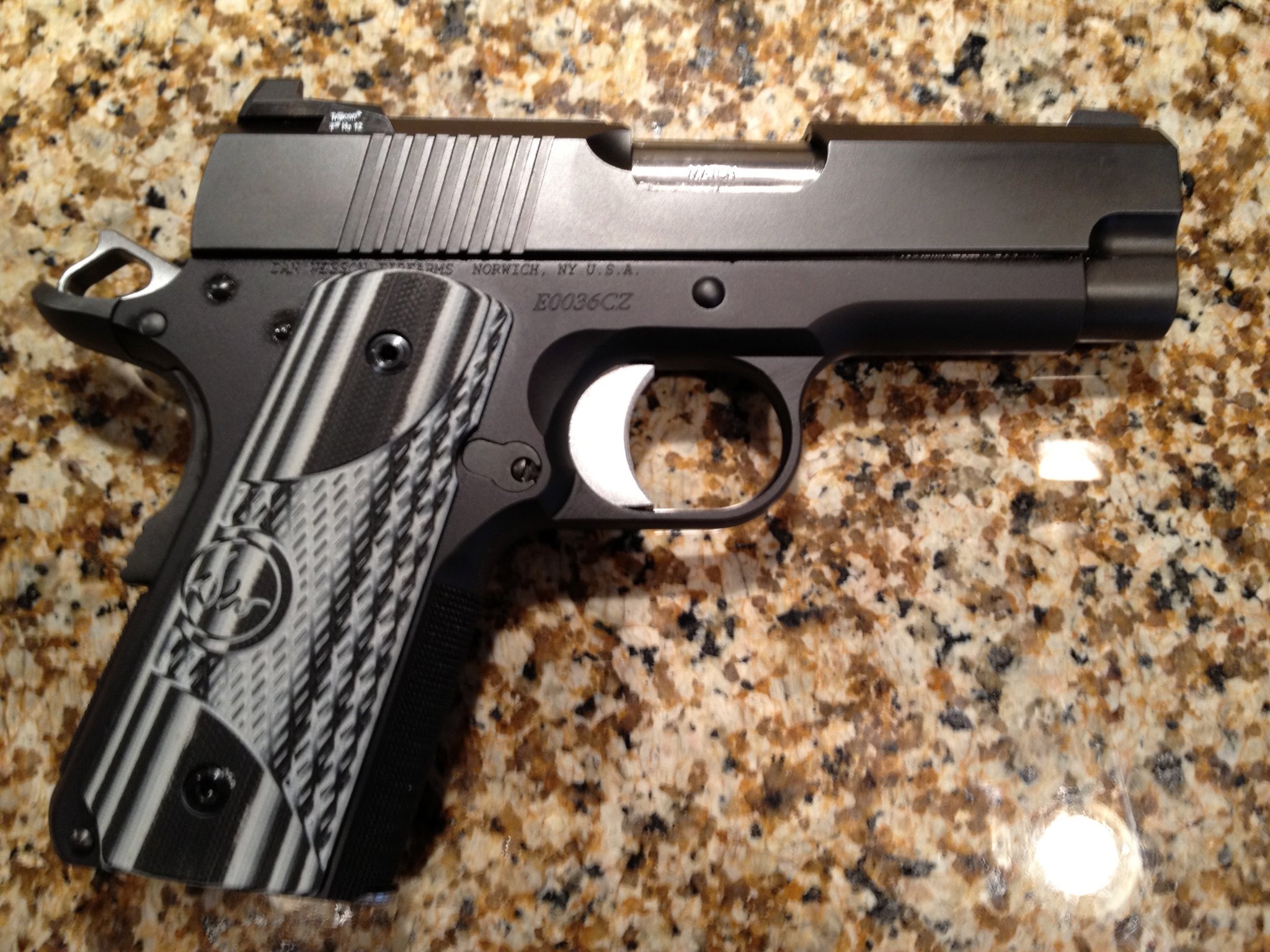

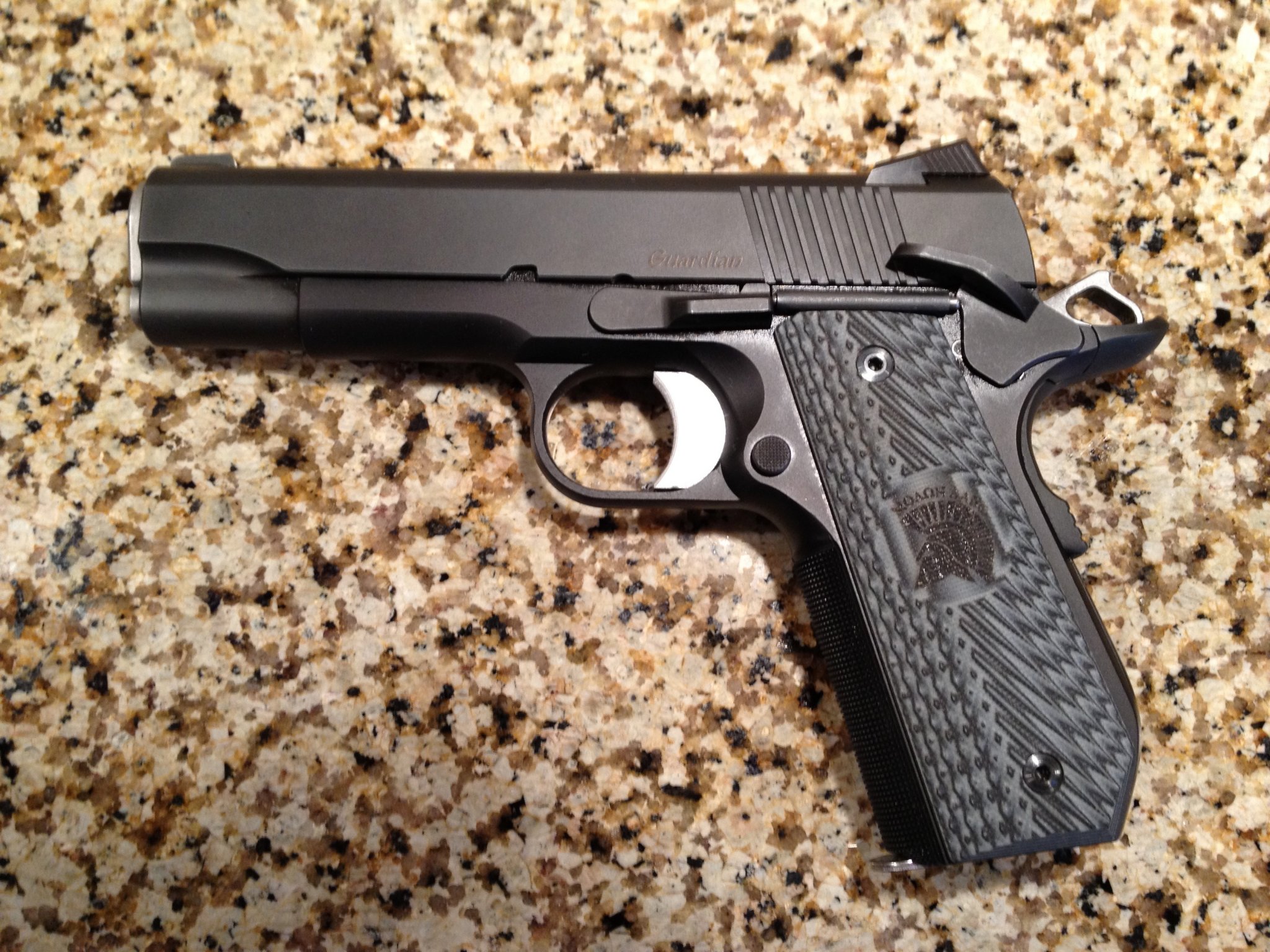

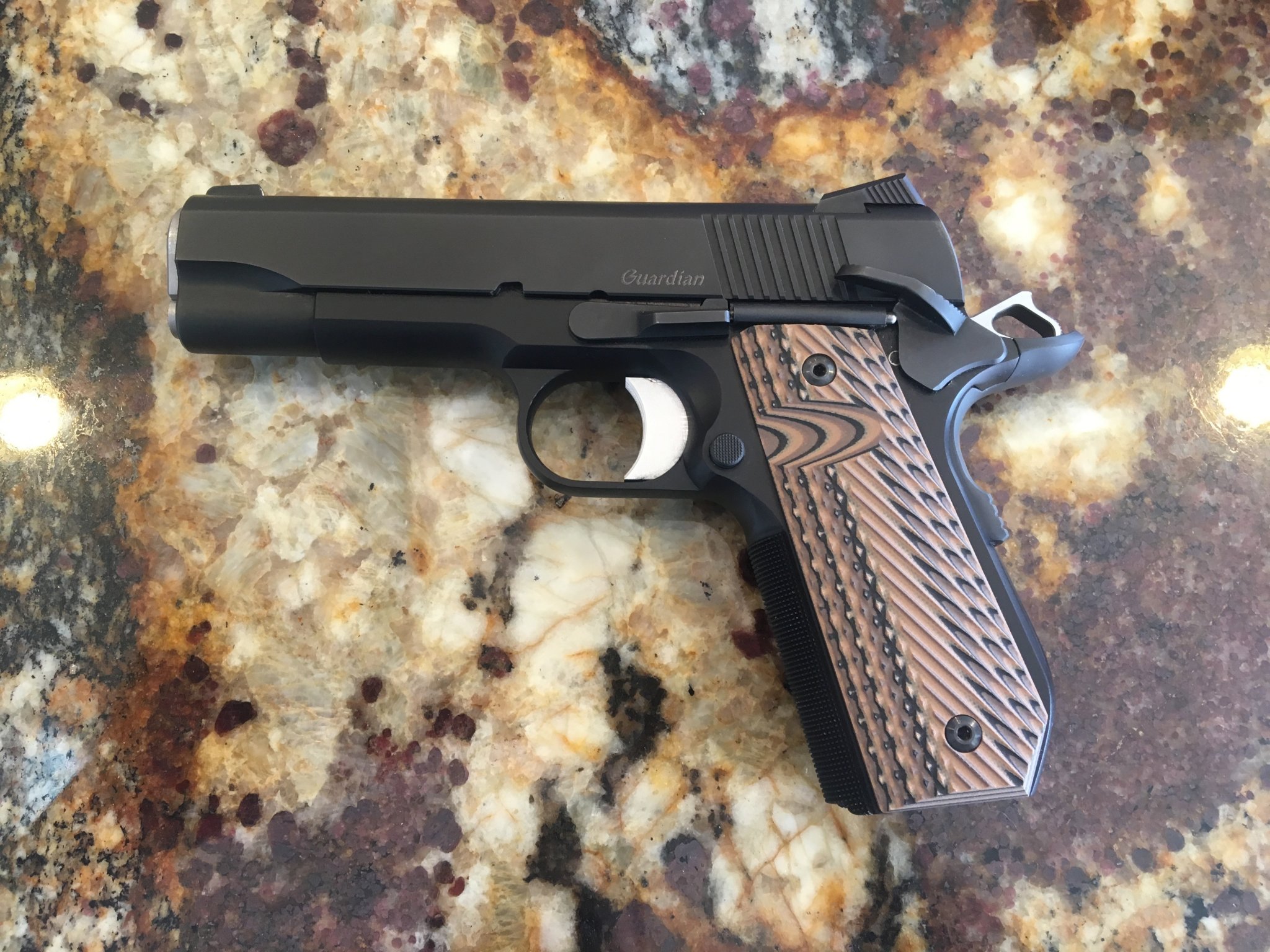

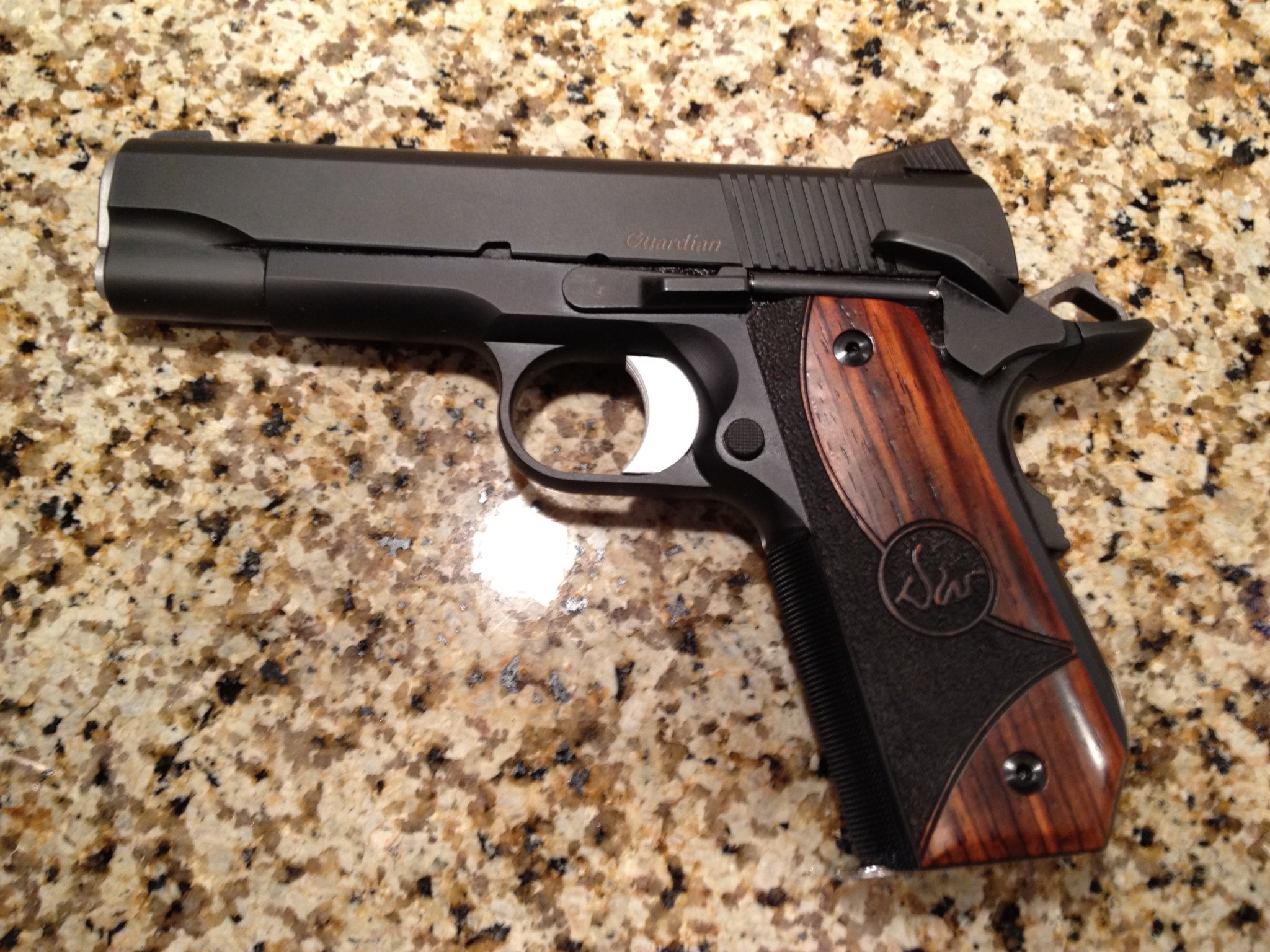

I have two different friends with DW Guardians (One in 45 and one in 9mm).
Both are amazing guns and shoot great. I really liked them.
I have the all stainless DW CBOB and it's great too, but I really liked the weight of the Guardian.
Personally, I own a Springfield Champion Operator (aluminum frame with a rail) and it too has been a fantastic shooter, however, I'll always prefer those Guardians. DW's are great guns.

I have a Colt LW Commander .45 ACP series 80. Also a Wilson Alloy frame .45 ACP. It is the 4" with Officers Model grip. The Colt has full sized grip and 4.5" barrel. I don't pound rounds through them but carry them a good bit. They shoot fine and hold up well. I doubt either has been fired 1000 times. Not range guns. I would and do go steal frame for my range guns. No reason not to do so.
As an aside "Light Weight", in the case of Colt doesnt only apply to the frame.
My old LW Commander slide is all carved up on the inside with lightening cuts.
The tunnel for the extractor is open underneath and there is other metal removed.
Im guessing most of the problems reported were owner induced - running +P or putting in light/heavy recoil springs.
Run it like the manufacturer intended and maintain the springs.
Too many people think they know better.

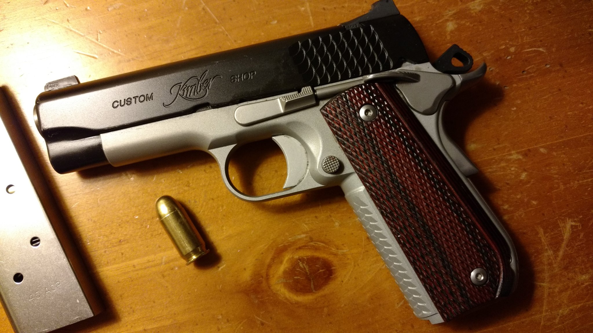

Good evening,
I picked up a lightly used Kimber (I know.. but it runs great and was exactly what I was looking for at the time) Super Carry Pro. It gets about 200 rounds a month and has held up so far with new springs every 500-1000 rounds, or whenever I think of it. These are lightly charged cast lead practice rounds so it'll be interesting to see what happens with it.
Anything in particular I should pay attention to on the frame that would indicate this wear you all are talking about?

Keep an eye on the area around the slide stop pin hole.
If there is weakness they will crack there.
But there is no weakness and with your routine I doubt you will ever have an issue.

Good afternoon,
Thanks for the info! Fired 6 mags last night and will clean tonight and keep an eye on that spot, but not worry about it too much. IIRC, my loads are 4.8g Bullseye with 130 LRN; so pretty light.
