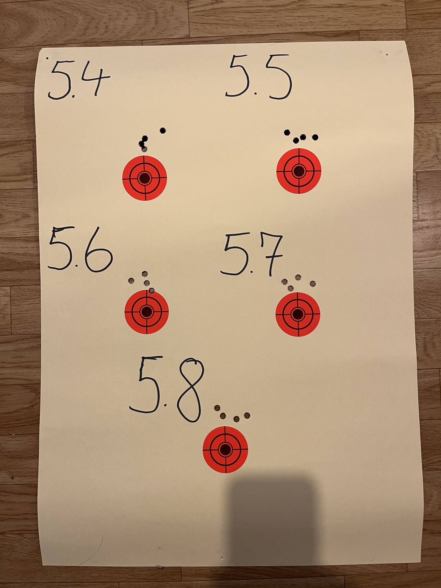

Of course, it'd really help to see pics of the series of shots. :rolleyes:
Here ya gooooo .....
Load 5.3 looked very similiar to 5.5, 5.7 and 5.8.
Distance was a bit over 100yds.
That one flyer at 5.4 was the first shot at this test, cold bore.
Because it is a hunting rifle, I´ve shot front and back on sand bags.
Thought about mounting a pica rail underneath the forearm, to be able to mount a bipod.
:unsure:
Basically, I just don't see anything that I'd attribute to any of the particular loads. Are these .1 gr increments?
When I see this kind of thing on my targets, invariably, I find it's that I'm not doing well with consistent trigger pull and/or cheek weld pressure. Even at 100 yds, wind can cause that kind of thing too.
Nothing I see indicates there has to be any issue with equipment or shooter ?
Any of the loads pictured would be fine for almost any typical hunting.
If you just want to chase better accuracy I would confirm the twist rate of your barrel and try some target bullets optimized for it.

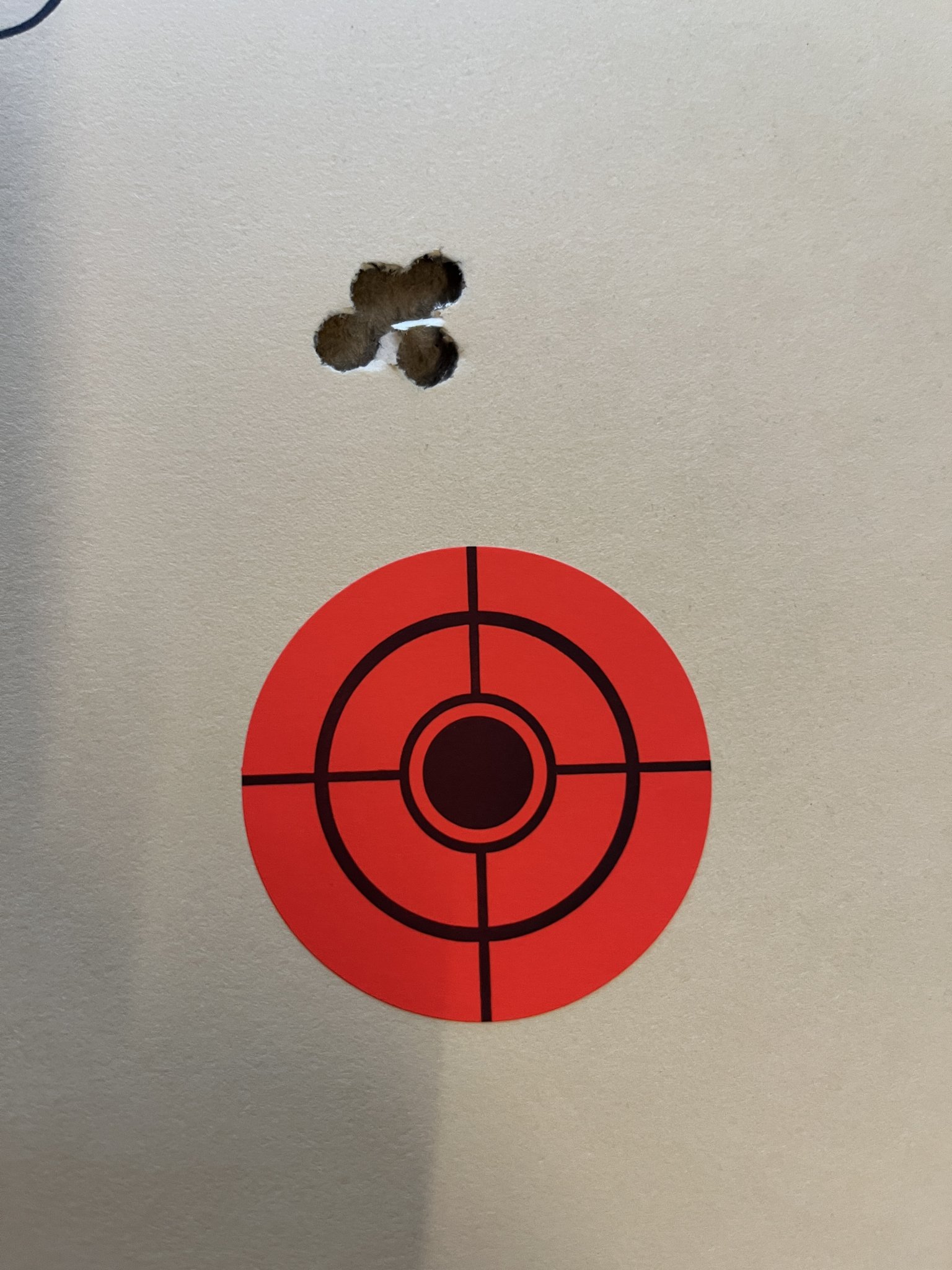

Well, finally.
:love:
Five shoots at 100 meters.
I did some with the rifle, tested some more loads, replaced the PEPR mount, worked on my fundamentals.
If that´s it, it is all I´m asking for, am very pleased with the result.
Should I bed it, or leave it as it is?
If it ain't broke don't fix it
