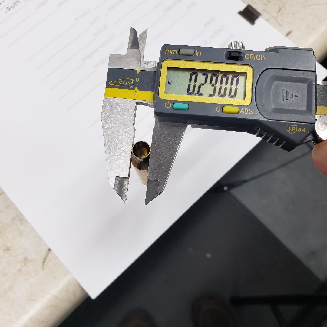

    Ok, with the virgin alpha, the neck walls are .1325 all the way around. .2905 neck OD with no bullet seated and I believe that's sized as small as she can go (no sizer ball inside) After I seat the bullet, neck OD's .2910. After I pull the bullet, which comes out super easy, neck ID is .2620.
    The old used starline case's neck ID after sizing it with no expander ball is just under .2585. (that pin barely doesn't go in the neck) And the bullet is still fairly easy to pull out, but not as easy as the virgin alpha.
    To me this is starting to look like the alpha brass has a shitload of springback, but for some reason I just dont remember all my other pieces of alpha brass doing this when I first started reloading them, or that situation would have caused me to react in this exact same manner back then.
    Every time I load a batch of ANY of my calibers (lapua and nosler in .308, alpha and lapua in 6.5cm, lapua in .223, and nosler in 6.5 grendel) I can switch to a smaller expander ball and get tighter neck tension as I can not only feel the differing resistance in the seating operation, but also when I seat one too deep, I can feel the resistance in the bullet puller die. These are different. No matter what I do, the bullets seat super easy, and they pull really easy. These will be for an AR, so I prefer a little more neck tension. I discovered this when I attempted to increase neck tension and failed, for some odd reason. Either this lot of berger bullets are just more slipperier than the last batch, or I'm guessing this batch of brass needs to be worked out so that there's less springback?

    Neck od before seating is .290". And the sized neck diameter with no expander? Which, ID or OD? ID's .2585" Why I'm so baffled is the difference between this and 262 is pretty decent, but the bullets press in SUPER easy, and pull out super easy too. Can't do it by hand, but on the bullet puller (hornady die with the red lever) it's REALLY easy. Too easy for my liking.
    If you can’t do it by hand then it’s fine. That’s .001 of neck tension, it’s not a lot but it sounds sufficient.

    Are you telling us that the sizing die (non-bushing) is only capable of getting the outside diameter of the case to .2905”? Did you order that die custom ground? A sizing die that hasn’t had any custom work to it, even a benchrest one, should reduce neck outside diameter to at least the smallest possible chamber neck diameter of the SAAMI spec.
    This was a factory die. Though I did order custom sizing balls down to .260 for experimenting with neck tension. (i usually load my rounds to a little more neck tension for my 308/6.5 ar's than I do my bolt rifles.) and forster was happy to make them and send them; but if combined with springback, those balls end up being useless, wouldnt they understand that before making them?
    What's confusing me is this was never a problem until now. The only thing I can think of is that this batch of brass has a shitload of springback more than the rest. I only anneal every say 4 firings. Is it just that this batch has to be worked more to get rid of some of that springback?
    You have it backwards. The more you work the brass, the harder it becomes, the more springback you get.
