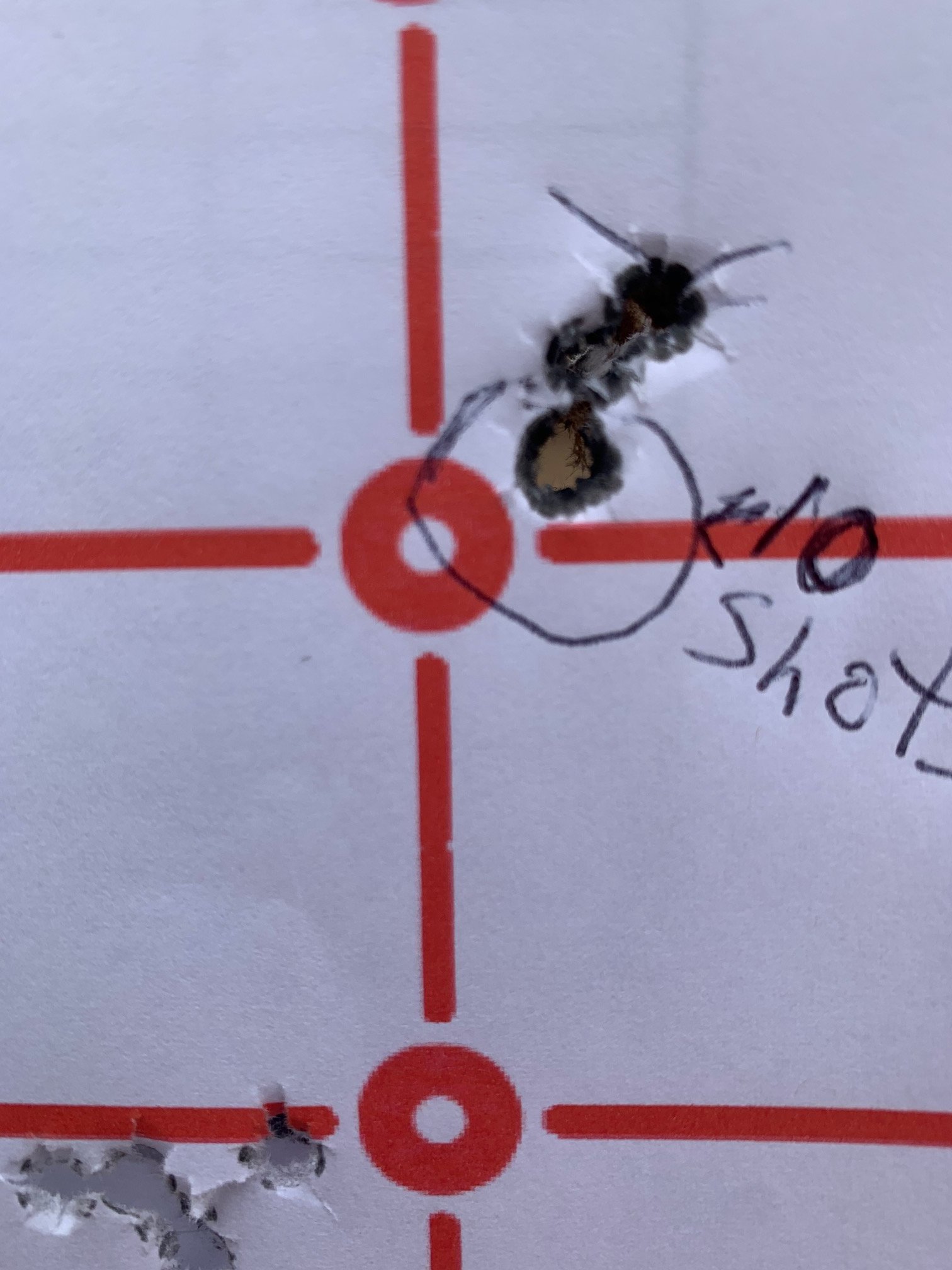

Had to laugh about a group shot this afternoon while fire forming some new brass. 29 grains of Varget, 105 VLD Bergers and Fiocchi primers:

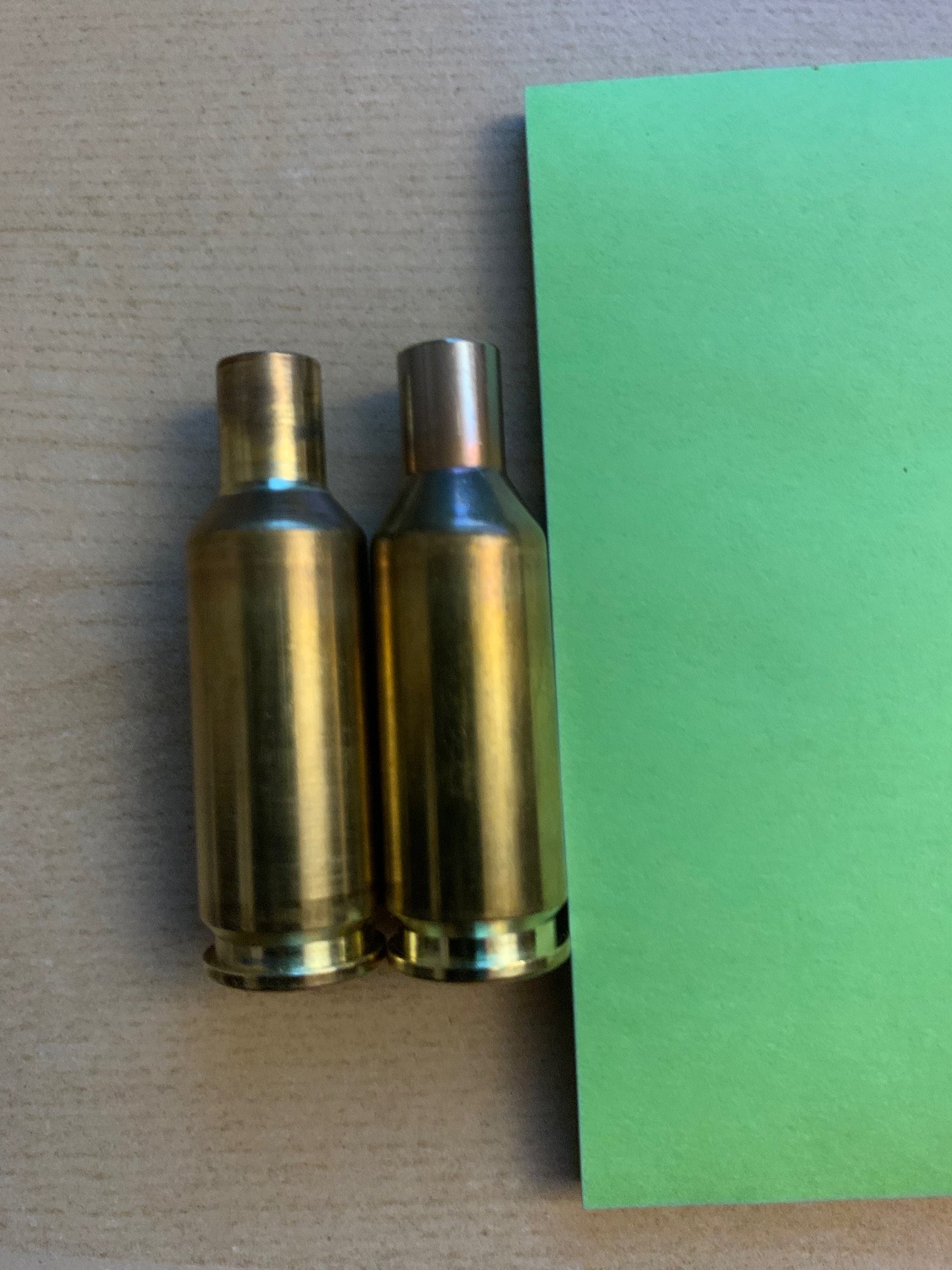

I have a couple hundred with about 3 firings on it. No issues, shoots great. On the first firing I tested the OCD a bit by running as much powder as I could fit in the case. Ended up with something like 32.5 grains of Varget pushing just about 3,000 fps with no pressure signs. For sure this is overpressured but the OCD performed as advertised. I haven't tested longevity yet since I'm only on 3 firings but I assume it would hold up as long as Lapua brass.
