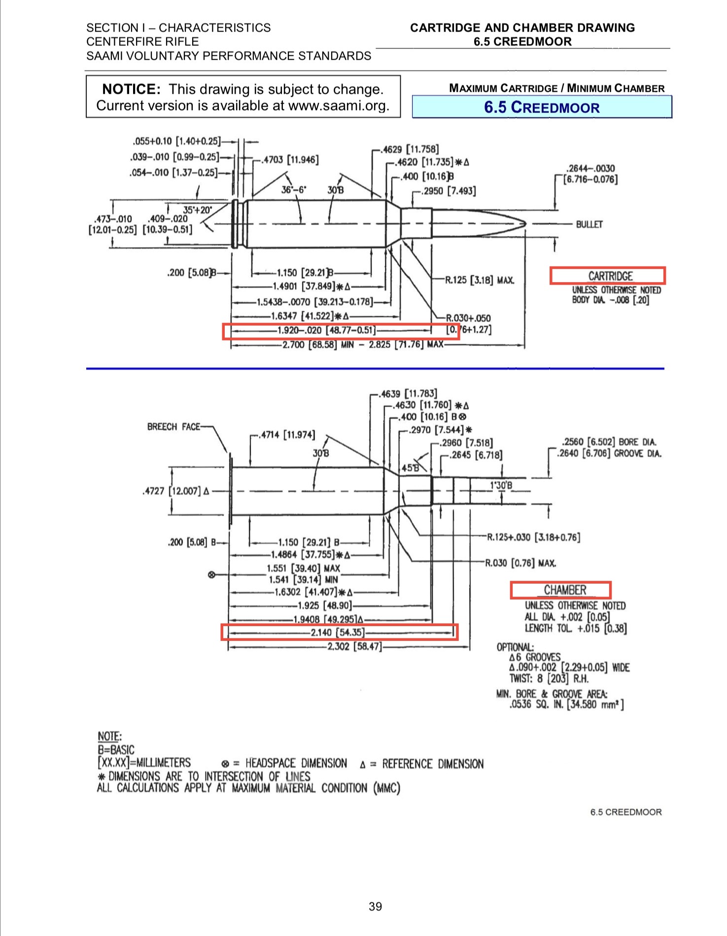

The SAAMI spec for case length is 1.920 - .020. So 1.900 would be the minimum, and 1.920 the maximum. There’s nothing wrong with this brass.
I did not look at SAAMI & should have. My Hornady reloading manual indicated 1.920 - 1.910. Never questioned the quality of Alpha brass & did not mean to have my post come off that way. Was just curious why it was 'under' when it actually was not.
