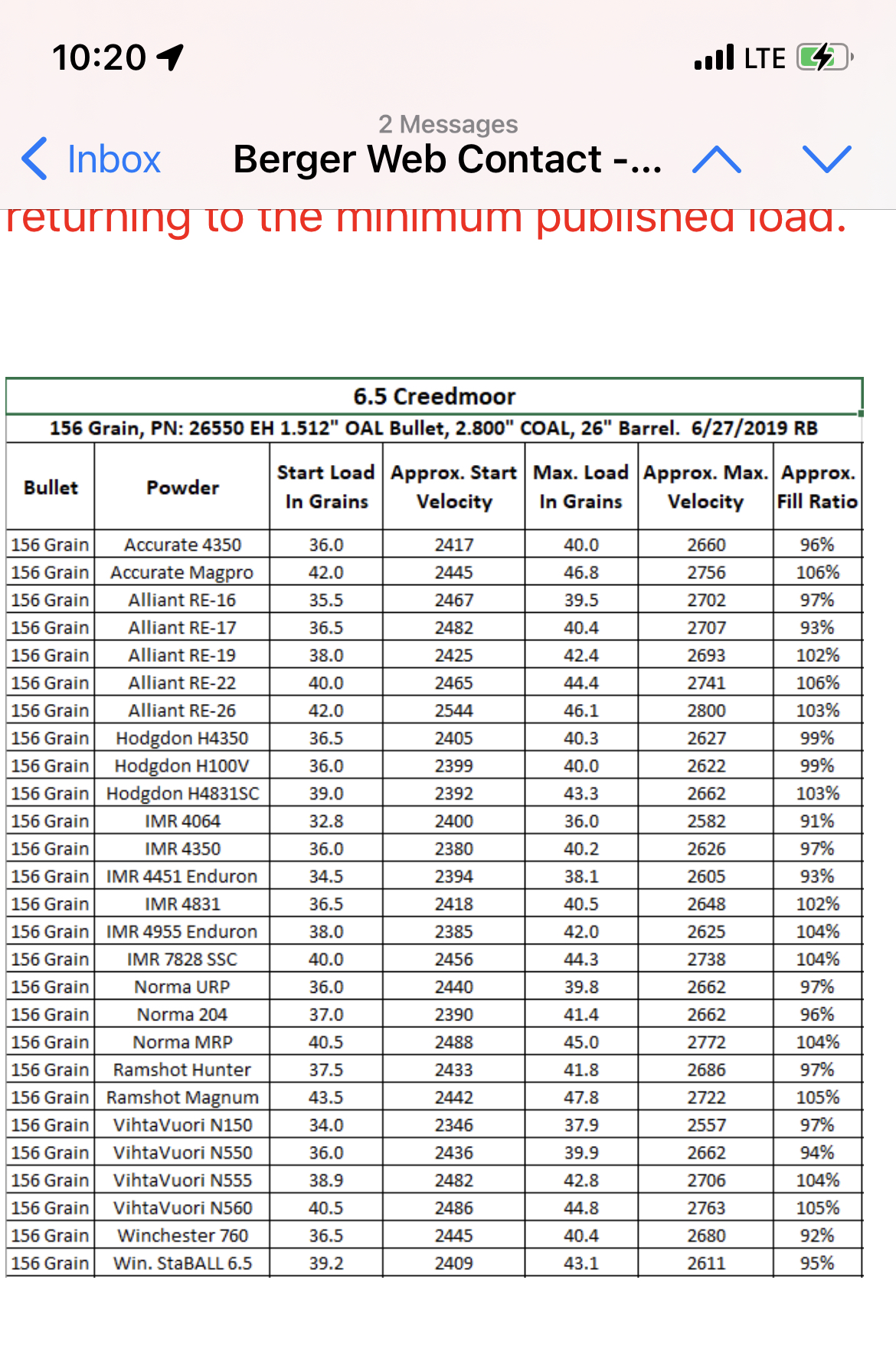

> 2700 fps (ideally 2775-2875 fps) with 153.5 gr Bergers and RL26, maybe RL23 if can’t secure any RL26.
I would be working up to that carefully though and stopping if any signs of pressure more than flattened primers/slight cratering/faint ejector swipe.
Again, I have no experience in loading for 6.5 CM as it was never a cartridge that I picked up. So take everything I say with a grain of salt.

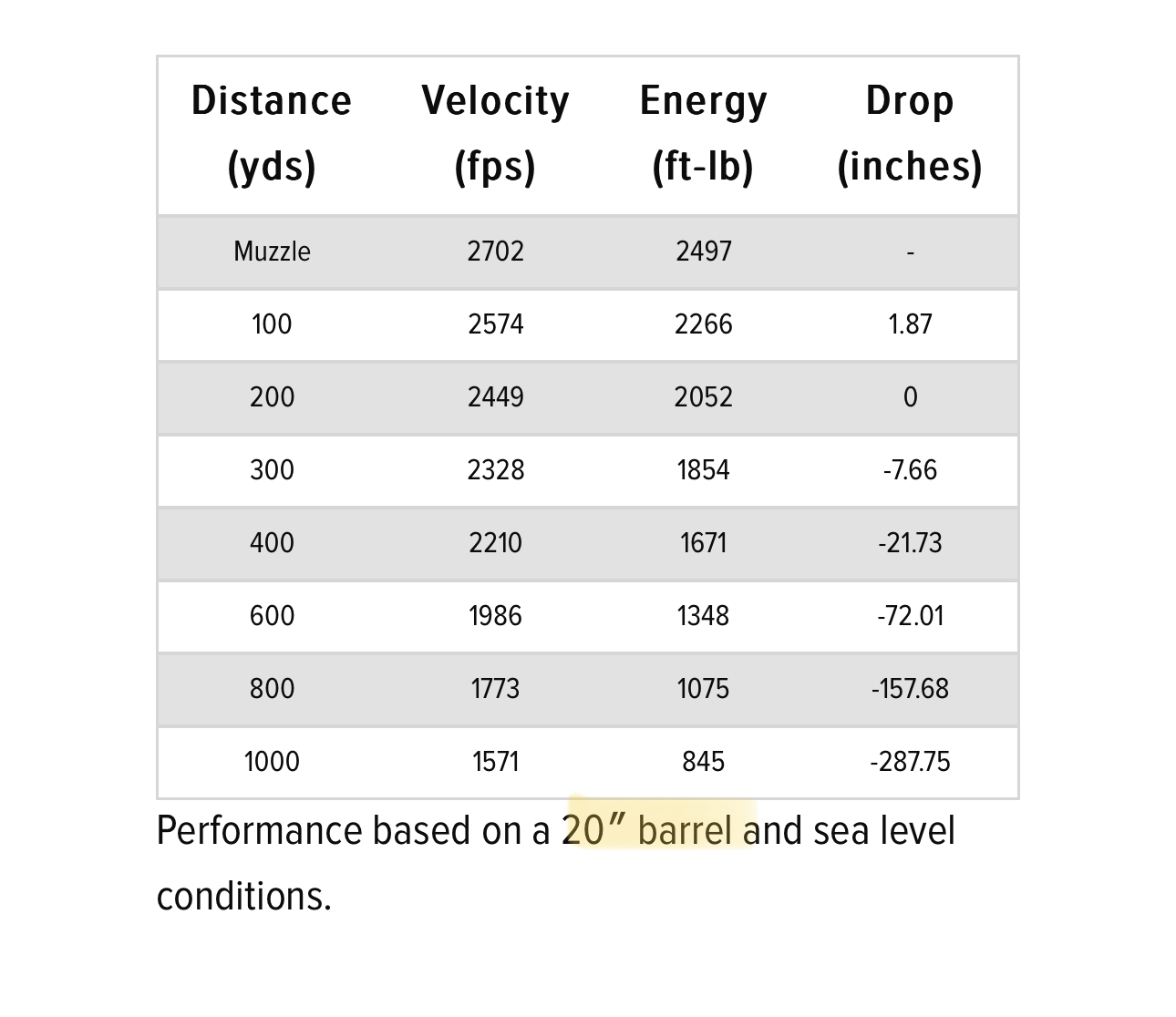

A quick search on Bergers website shows the 153.5gr factory ammo out of a 26" barrel moving at 2702 out of the muzzle. Berger loads their factory stuff in Lapua brass but with LRP's. Seeing as how factory ammo does not tend to run all that hot, I would assume that you would not have any issues bumping your loads to hit your stated velocity goal out of a 27" barrel before you run into any pressure issues. Work slow to make sure but that is my first thought.
Reactions: drummachinejoe

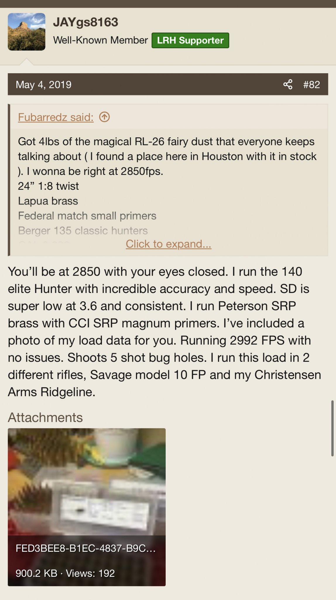

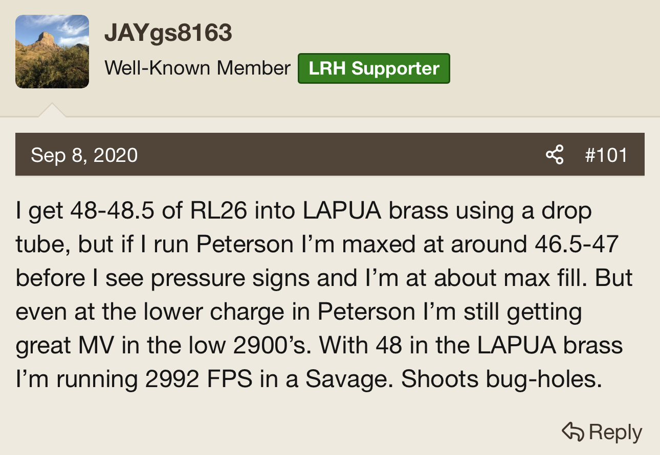

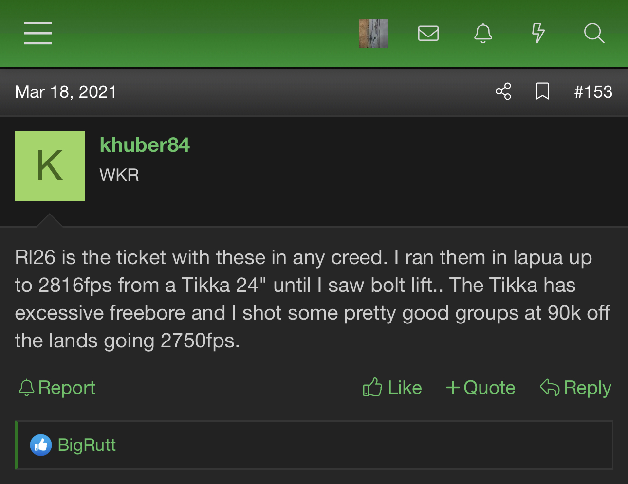

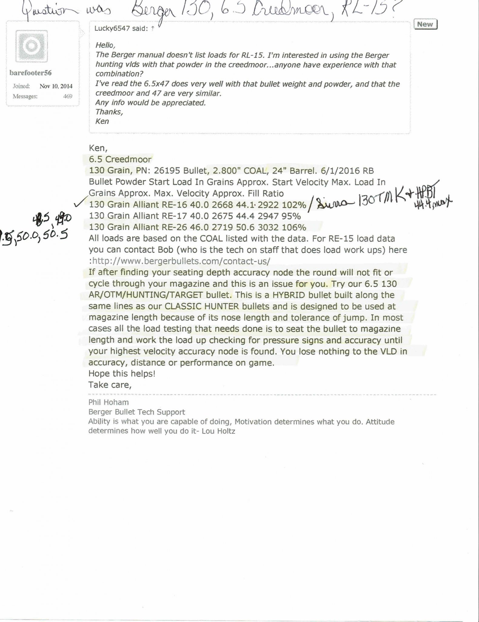

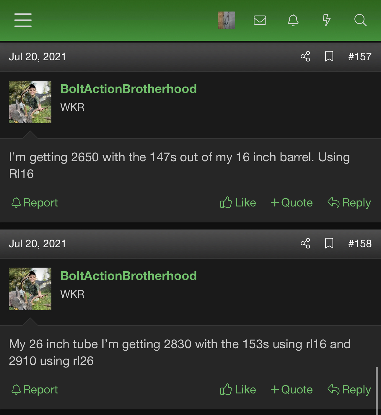

This is just what I’ve gleaned.
This is what I saw from their site on factory loaded. I agree with you. Usually not super hot loads in their factory loaded ammo.
And out of a 20” barrel also.
Even better. That was exactly what I was looking at but I accidently read it wrong as 26". I would say you are good to go. Grab some Lapua now that you have some data that leads you to believe you wont have any issues hitting your stated goal with that brass specifically. Let us know how it turns out.

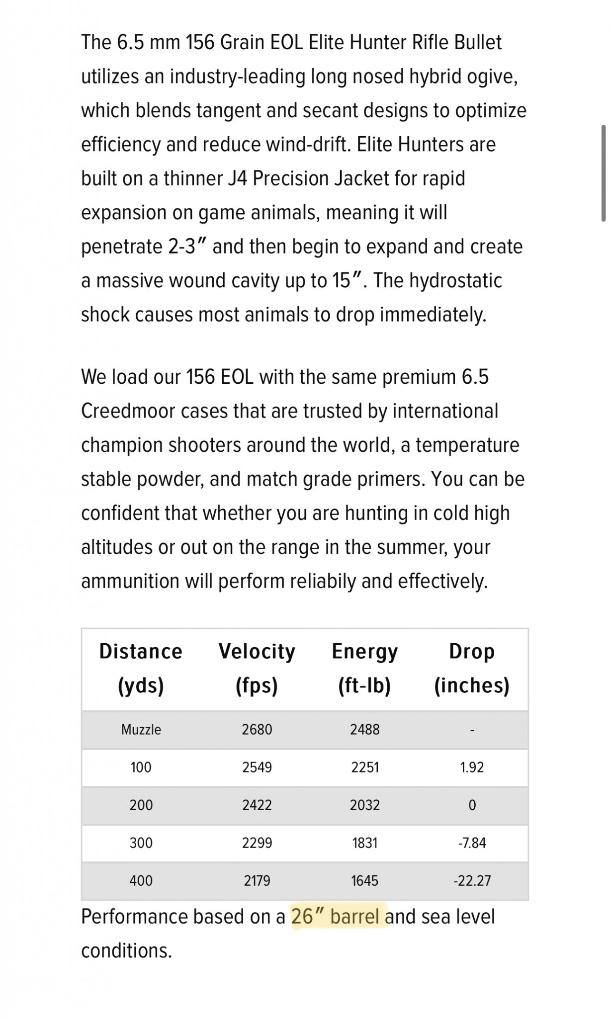

Oh, the 156 gr EOL they show with a 26”. Even though it’s only 2.5 gr heavier it didn’t get that much higher of velocity even with 6” more barrel
length for some reason. Seems strange
I got 2460 with the 156gr factory load from a 20” and my buddy got 2480 from a 22”. This was on 95+ degree days. The stated velocity seems extremely optimistic for performance with a 26” barrel.
