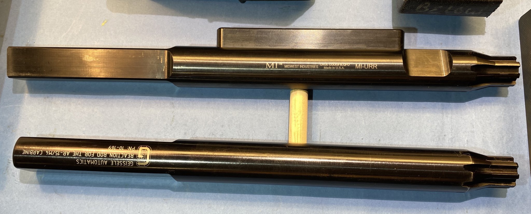

Any input on the aluminum action rods for changing AR barrels? Part of me says they would be fine for a barrel or two a year, the other part says just get the steel ones for 20 bucks more each.
Disclaimer....never matched up an aluminum tool with tool steel hardened chamber lugs.....every time aluminum-tool steel is paired in a variety of other gunsmithing applications, the aluminum device loses when unknown torque value applications are being applied. I prefer the MidWest Industries steel tool over the Geissele; the upper receiver support lug is a nice distinction with a difference. Surprised Geissele didn't incorporate it in their design, and I'm a fanboy of their products.

I have a geissele reaction rod I’ve used a bunch on AR15s. I didn’t wanna spend $200 on one for my newly acquired AR10 so I ordered an aluminum reaction rod from just rails, it has a small upper receiver support lug in it. They say it’s good for 60 ft/lbs of torque which should be fine for what I do. If it breaks it was only 60 bucks.
Aluminum is probably fine for installing barrel nuts and muzzle devices to typical torque values. But good luck when you stumble across that one motherfucker of an upper that was put together by a gorilla with a breaker bar and one of those big bottles of red Loctite.
Get steel tools.

I've been using one for a while now from Real Avid, and it's pretty damn nice. Haven't had any issues and it's plenty strong. If you torque something hard enough to damage it, you're going to damn near crack the receiver and break the barrel threads off the upper...
I've broken free several Rocksett'd on Dead Air KeyMo brakes with mine, and zero issues...I'm not gentle when I use tools, and didn't back-off on the pressure. I felt like I was more likely to rip my 4" vise off the wooden bench, than damage the rod. Also, I did not pre-soak the Rocksett...Just cranked them off with a Magpul Armorer's wrench dry. SNAP!...Spins free. 👍🏼
