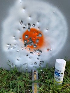

Mark, our club uses some aluminum plates for our 22lr shoots. We found that they need to be made from 7075 T6, as anything softer will become pocked rather quickly. Our 7075 plates are all either 1/4" or 3/8" thick and have held up really well.
Unfortunately, I don't think these sorts of targets are commercially available at the moment. We purchased leftover aluminum plate from a local shop and had it cut to size and drilled to work with the hooks we use as target hangers.
They really are excellent targets for 22lr. The plates move quite a bit and ring loudly, even at 200 yards.
These targets were used in monthly matches for more than a year, though we always had fewer than 20 shooters at a match. The two larger plates were placed beyond 100 yards, while the smaller plate on the right was used mostly between 75 and 100.
For a larger matches, aluminum plates should still hold up fine at longer ranges and they would make calling hits much easier. Inside of 100 it may be better to stick with steel.
