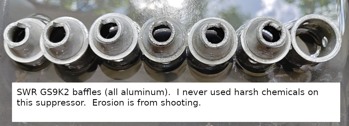

There were a lot of all aluminum pistol / SMG suppressors twenty years ago. They just didn't last, they corroded and looked like hit by a sand blaster.
I’ve been around 3 aluminum brakes ..supposedly special aluminum that lost a baffle with a 300NM shooting factory ammo.

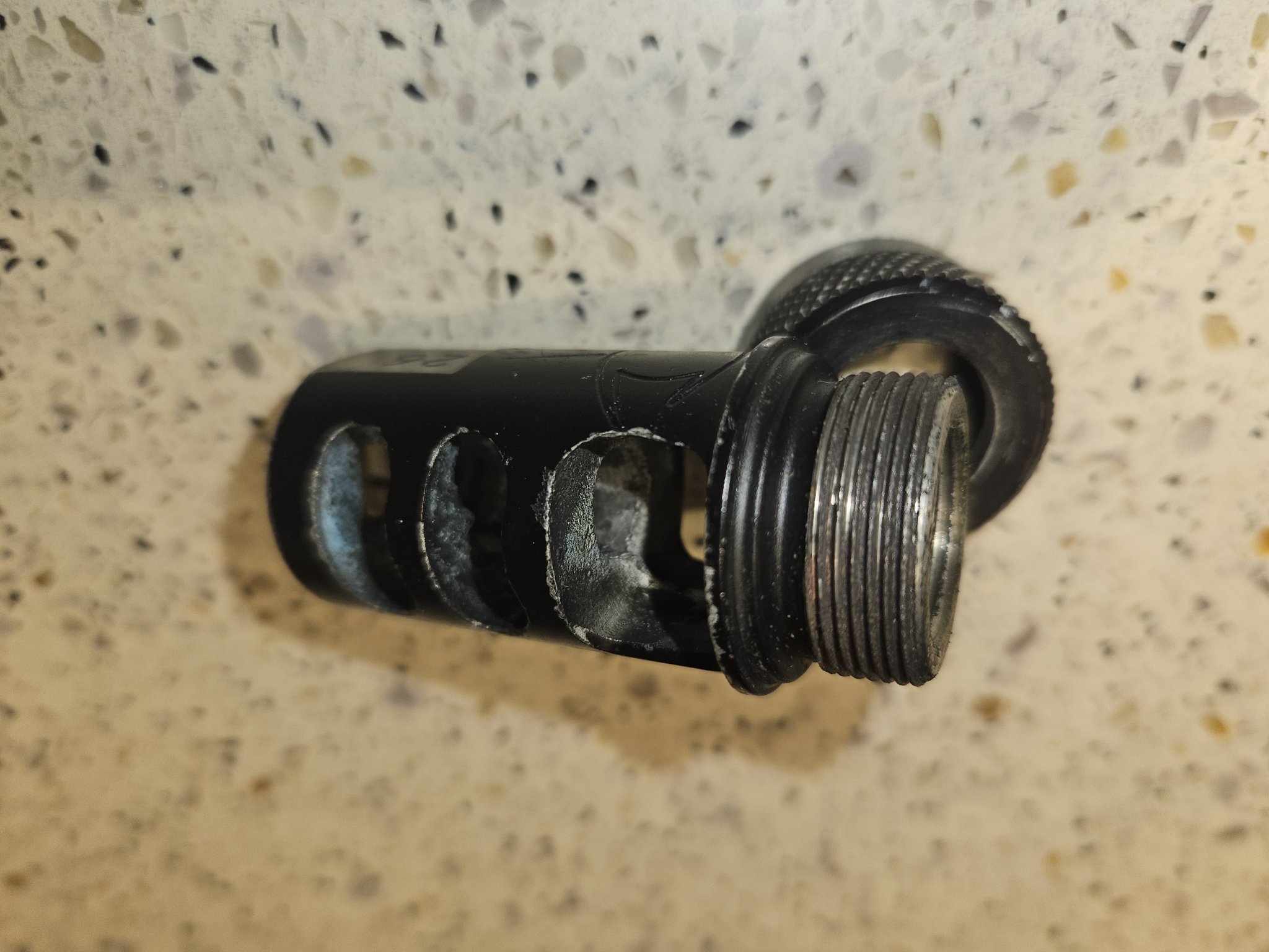

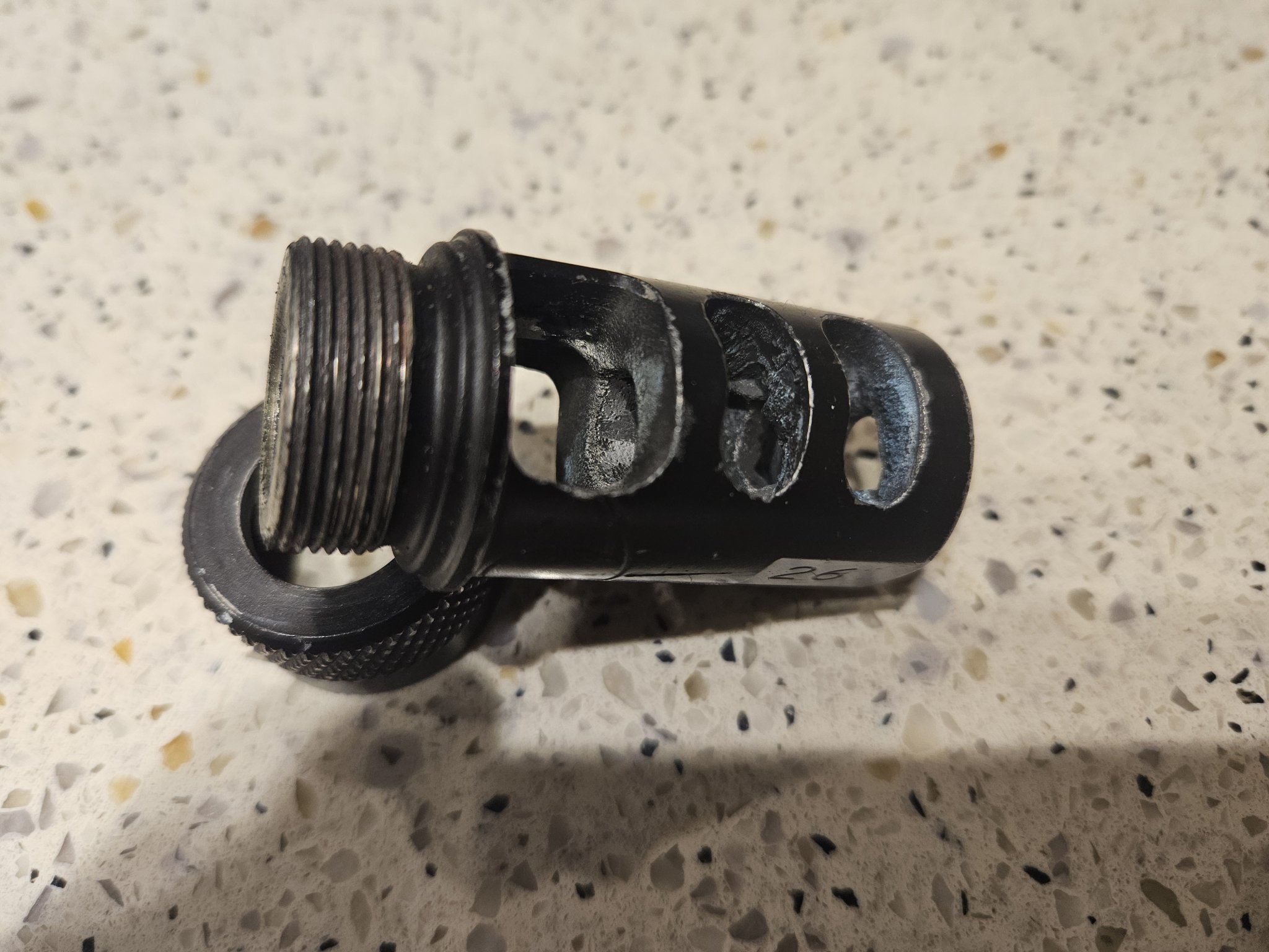

Here's one after a few thousand rounds:
Not really sure how to tell if it's worn out. Also not sure how to clean it well or take a decent picture.
*I soaked it and then scraped it with a screwdriver. Still seems to have most of its metal although the neck of a 6.5 case now fits through it.
